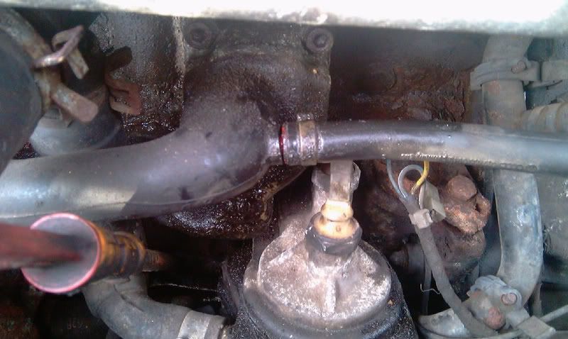

Found the problem,
Could someone post a picture of the pic below when the pipe is intact.. does anyone know if its cracked and should be one unit, or if its 2 units and its been disloged.. I assume this is how the oil leak happened, it must of been knocked when the switch was taken off to test the pressure...

That's a negligible amount of oil in your pic, could have come from a split breather as mentioned. If you had non showing on your dipstick and it was an external leak, the underside of the car will be plastered in the stuff as you'll have lost over 2 litres which will cover a huge area.
If there's no obvious oil in large quantities on the engine/underneath of the car - I would have to suspect that the engine has burned it and you haven't noticed, or it never had enough in the first place.
I'd check the plugs/air intake etc for signs of where the 'missing' oil has gone.
I'd also want to know where/how the garage checked the oil, and what pressure they recorded - rather than saying it was a little low. The warning buzzer activates at 0.3bar iirc
Yeah, when an oil line broke on my Golf it was like someone had thrown a huge bucket of crude in my engine bay, even though the line was at the bottom of the block.
Could they have drained the sump? Does the sump bolt look recently cleaned?

Looking at the OP previous postings there is a picture of the underside of the car and it is soaking wet with oil, i think it has been leaking for a long time...
Found the problem,
Mine used to leak there aswell, I glued it now no leaks and fine.
