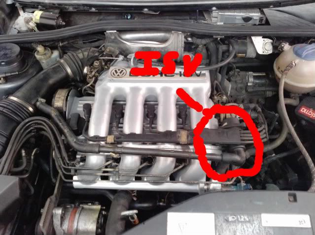

adolf1976 0 Posted May 3, 2010 hi to all. just brought a 94 2.0 16v mulberry rado, but i got probs its got rough idleing, fine above 1500 rpm but a dog below.have read about isv's bts's and ecu resets but dont no where to start. have cleaned t/b dont no where the others r yet.is there any diagrams for the engine bay components :brickwall: seem to be using a bit of water, no obvius head gaskets signs tho oil temp dosent work on dash computer and temp takes an age, thermostat comes to mind i am quite a diy mech but without a manual im a bit stuck, been driving diesel vans for five years any help would be great spent a day on it and only freed my siezed caliper, but progress is progress :clap: Quote Share this post Link to post Share on other sites
Jim 2 Posted May 3, 2010 Welcome to the forum. ISV is always a good place to check, as is all associate vac pipework - check it all for splits / leaks, and thoroughly clean out the ISV with some carb cleaner followed by a quick squirt of WD40 just to lubricate it a bit. Worth also getting timing / fuelling checked. For the missing water, worth checking the coolant flanges on the front and side of the head as they're plastic and go brittle with age - and can crack & leak. Oil temp missing could just be the sender not connected perhaps? Thermostat quite a likely candidate for the water temp taking ages to come up - have you had a feel of the top & bottom radiator pipes whilst the car is warming up? Only the top should get warm over the first 5 or so minutes of warming up then the bottom pipe should get warm as the thermostat opens. Would love to see some pics. Sold a Blackberry 2.0 16v years back in Birmingham and have never heard / seen anything of it since and keep hoping it'll turn up on the forum again! Quote Share this post Link to post Share on other sites
adolf1976 0 Posted May 3, 2010 thanks for the info, im struggling to find isv :scratch: think its prob stupidity on my part no pics at mo only had it two days, its got history in bath ,cardiff and bridgend. cloth interior five spoke vw alloys owned one shortly b4 but had to sell for the mortgage man. never got to enjoy it.was a 93 2.0 16v in blue. chipped, remapped , induction kit was good for 150 bhp had rolling road set up an all :pukeright: will continue with isv hunt and i think i found water leak, where hose connects to engine behind injectors, looks very corroded Quote Share this post Link to post Share on other sites
Swompy 0 Posted May 3, 2010 Here is where to find the ISV :D Its the black tube type thing Quote Share this post Link to post Share on other sites
adolf1976 0 Posted May 3, 2010 WOOHOO thanks soooo much, almost took it off earlier. but i'd looked so hard i confused myself and had doubt. just found vag com, every diagram ill ever need damn i need a week off work!!!!!!! Quote Share this post Link to post Share on other sites
