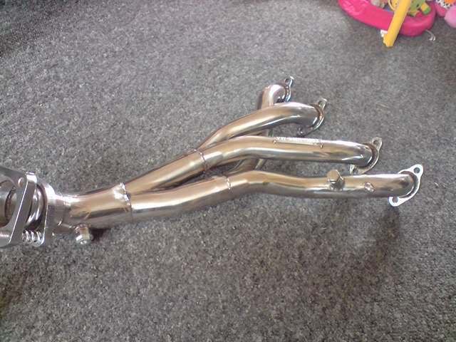

i got my manifold and de-cat today

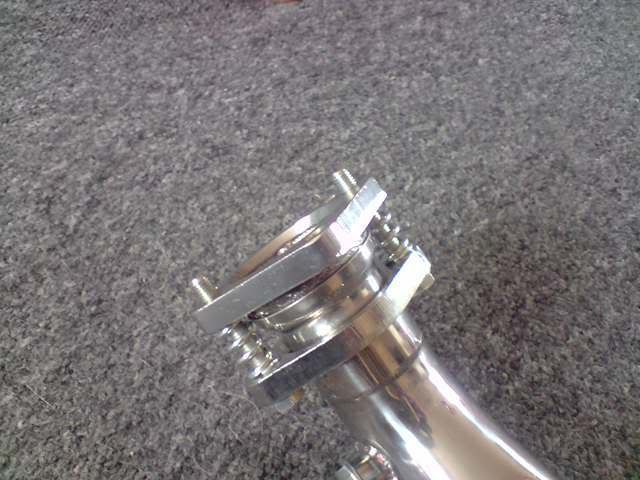

do I need to cut the bolts or something because when i attach the wire ring and the 2 plates together
the bolts come out of the back of the plate which means i wont be able to attatch the de-cat to it

heres the bolts coming through

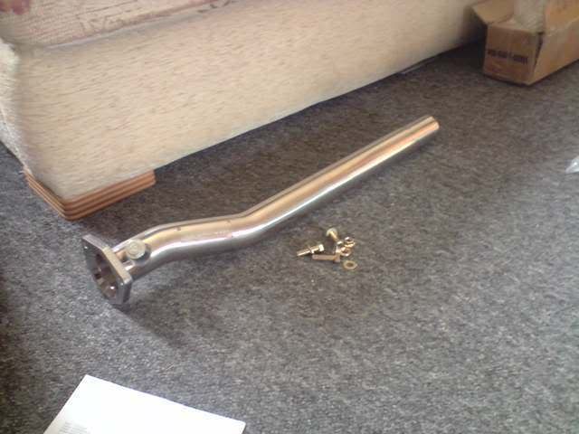

this is what needs to be fitted to the branch

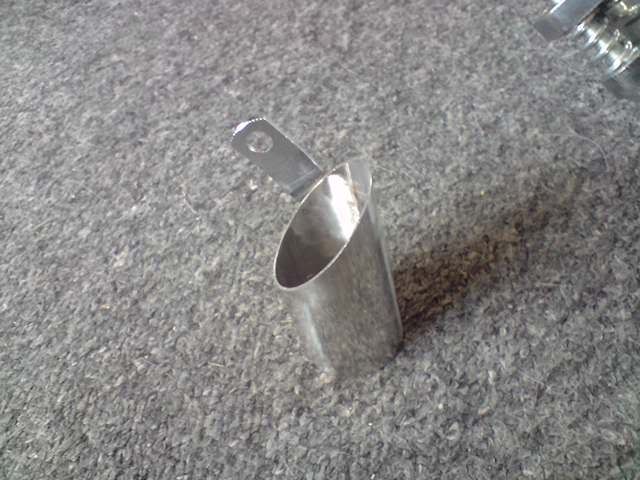

I got this extra bit not sure what its for

the decat should fit with the bolts sticking out, mine did anyway. if not options are drill holes in the decat bracket (smarter option imo) or cut the bolts.
make sure you put the right gasket in should be a round metal one. the random extra bit you dont need, mine went in the bin.
i lined up three of the branches but then the passenger side one was out, used a bar to bend it into place. had to take inlet manifold etc off to get the 4 branch in. use plenty of sealer too, dont wanna be taking it off again.
is that the way the springs are ment to be? sorry to drag up an old topic but im not sure which way the springs are ment to go on, i thought the went on the manifold side not in the middle... but again i dont have a clue!
can anyone help?
