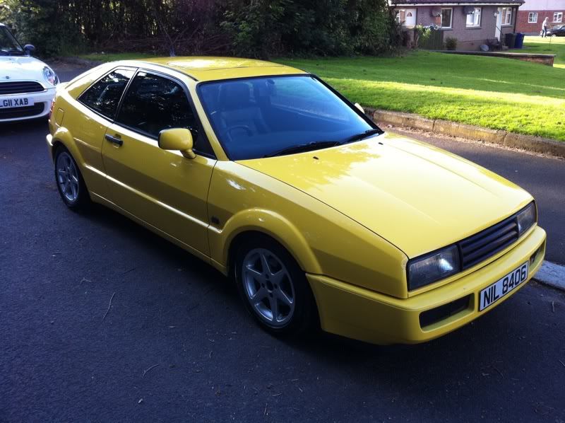

Sideways Steve 10 Posted July 29, 2011 I have always wanted one of these ever since I was right into VAG stuff after passing my test, however I ended up bitten by the Jap car bug so never did get around to owning one. Shes a 1990 VW Corrado 16v in Nugget Yellow Additionally this one was fitted with optional full leather interior which is a bonus ! I picked this car up over in Edinburgh off of a Scottish Vag member and it comes with FULL VAG history, thousands of £'s worth of receipts and has only covered 3-4k miles per year resulting in an extremely low mileage of just 100,000 miles. Unfortunately back at the end of last year the heater matrix exploded but due to a back injury he was unable to sort it so it has sat off the road for the last 7 months or so. The result of this was that the car looked extremely tatty when I collected it, it didnt run right at all and the yellow was extremely faded in places. Some of his friends had tried to help out by doing some bits and bobs to the car for him but again this was not great and I have basically had to strip it inside and out and sort everything properly. I have managed to get 3 full days on it and it has paid off. Day one consisted of me stripping back the whole interior and dash etc to allow me to fix the blown heater matrix and properly clean up all of the leather. Whilst I had the dash in bits I removed the remains of the original alarm system as it had been disconnected and replaced with a clifford unit. I also tidied up all of the wiring loom behind the dash and under the drivers side as it was a complete dogs dinner. Lots of missing and incorrect bolts and screws were replaced and all of the interior trim panels were re fitted correctly resulting in the interior looking like new again Day two was time to get the Outside looking as good as the inside, so with the loan of a machine polisher and some cracking weather I got stuck in, I genuinley thought I may have to fork out for a respray due to some of the fading but I was lucky and must have caught it just in time as about 95% of the paintwork all came up back to near perfect ! Now that the car was looking like much less of an eyesore sitting in my parents driveway I decided to turn my attention to the ride height. The car had recently had a set of new coilovers fitted before it went off the road but the previous owner had decided to sacrafice handling for looks and slammed it as low as it would go. I like my cars low but there has to be a limit and the Corrado was well past that limit ! I free'd up all of the coilover platforms and got the rideheight sorted. I gave the engine bay a good pressure washing next as I knew I was now going to have to spend some time under the hood. I charged up the flat battery throughout the day so decided before giving up for the night I would see if it would start. It spluttered to life but sounded very sick and would not rev or idle properly. I instantly thought I knew the cause from my previous VW experiences and was pleased that when I moved back the inlet pipe to the throttle body I was presented with the ripped joiner I was expecting to see. This meant removing it from the car and carrying out a repair procedure I know of but did also mean it would have to set overnight before I could refit it so that brought day 2 to an end. Day 3 started off in the workshop with me checking out how the previous nights repair had worked out. As expected it was spot on so I got straight back under the bonnet and fitted the now repaired pipe. I also noticed some damaged vac pipework that was leaky and improperly connected so replaced this at the same time. After a quick check over my fluid levels and manually bleeding the cooling system it was time to go for attempt 2 at starting it up to see if it ran any better with the air leak sorted. On the second rotation of the engine it sprung stairght into life and sounded 100 times better than before but still not quite right and still felt boggy on pressing the pedal. I knew that the car had a brand new distributor fitted so instantly thought the cause was that the timing was probably not set right I let the temp come up and after ensuring that the heater matrix was now leak free I got out the timing light and adjusted that correctly. It turned out to be well out and as soon as it was set to the correct 6 degrees BTDC the revs picked up and it started to idle much more smoothly. Now that it was running well and revving freely it was time to fix the exhaust system which was leaking very badly and banging off the bottom of the car. I got underneath and removed it all from the car, a few tweaks were made to hangers etc then I cleaned it all up and got it all bolted back on properly without too much hassle. I have a few more bits and bobs to do but overall she is up and running and back on the road where she belongs ! Here are some photos for you all, they are not the best as were taken on my phone and the car was still not fully cleaned up but I will add better pictures later. Quote Share this post Link to post Share on other sites

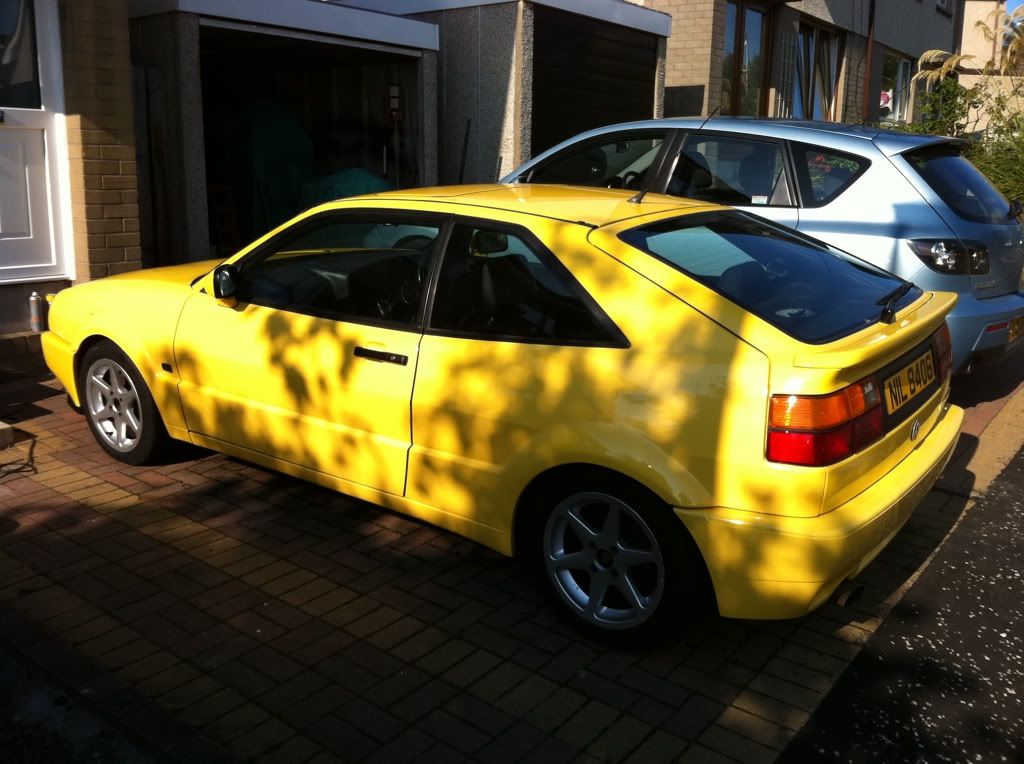

Sideways Steve 10 Posted August 1, 2011 Thanks chaps, Some more up to date photos for you - Next up is sorting the active spoiler and the MFA as I have a faulty VSS sensor on the speedo head so have managed to get a full set of clock off someone on here. Just waiting for them to be sent out now and hopefully all will be well once again ! Quote Share this post Link to post Share on other sites
kirade 0 Posted August 1, 2011 great work, and good to see another Corrado saved. Quote Share this post Link to post Share on other sites
Sideways Steve 10 Posted August 2, 2011 Well its not out of the woods yet but its running well and is looking far better than it did so I am happy for now. I really need to address the paintwork as the sides have been blown over at some point to allow the rub strips to be taken off. The paint used has not been of as good a quality as teh original stuff and as a result its faded. I have machine buffed it all as above but its still not 100% and I am very picky about things like that. I think I will keep it waxed up for now but aim to sort the light rust bubbles around the windscreen and touch up any other bits then see about getting the whole car flatted back and blown over. One of my friends is very good with a spray gun and has a heated garage where hes painted a few cars now so It could be a plan for some time in the winter I think. I am now on the hunt for some helper springs for a set of TA Technix Coilovers as when they were fitted the last owner had the car set super low and did not fit the rear helper springs. Now that I have raised it again the adjustment is right on its limit so I need the helper springs to sort it out properly. Quote Share this post Link to post Share on other sites
Sideways Steve 10 Posted August 4, 2011 Swapped over the speedo hall sender on my lunch break just there and I now have a fully working MFA again and more importantly the spoiler works automatically again :) RESULT ! Quote Share this post Link to post Share on other sites

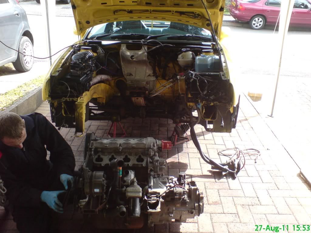

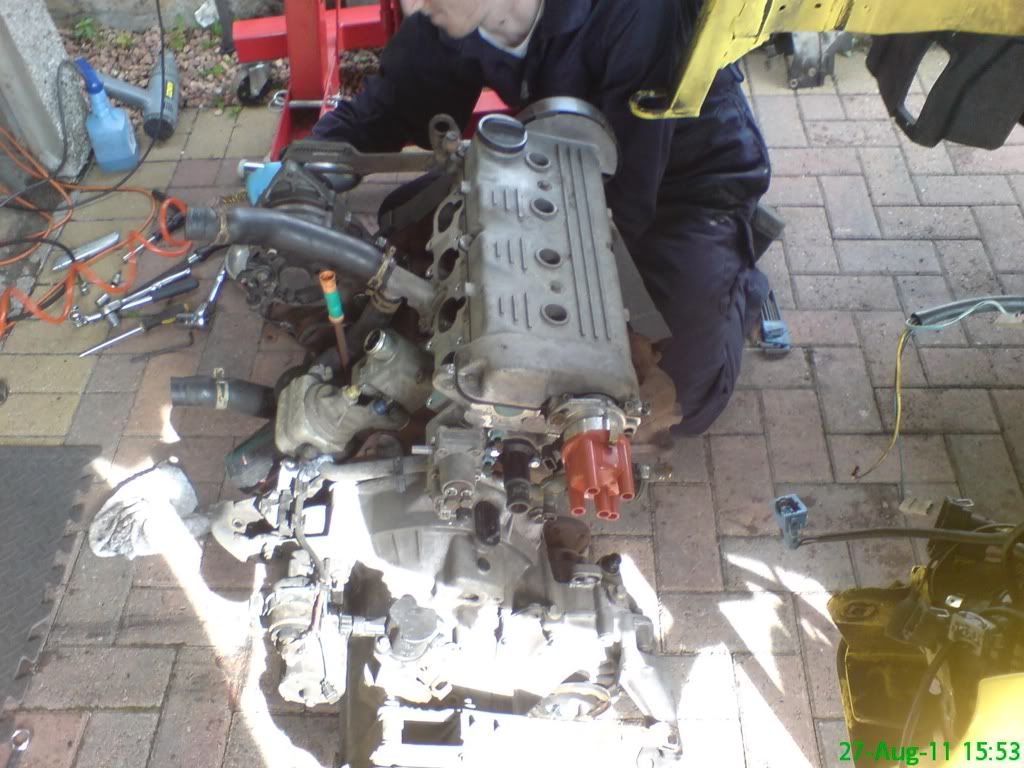

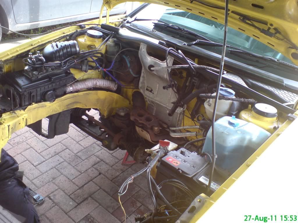

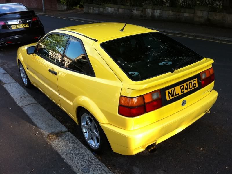

Sideways Steve 10 Posted August 29, 2011 What a weekend ! Well I have had the suspicion over the last couple of weeks that something was still not quite right with the Raddo as it was very lumpy on cold start and I suspected that the HG was starting to go and that it had also been the root cause of all the cooling system issues I was having. I had a journey up to Aberdeen last week for work and as I passed Dundee my coolant level light came on for the second time since sorting out the water pump etc. What with having no visible leaks anymore I topped it up and continued on my journey. When I arrived at my hotel I decided to let the car cool then nipped back out and popped out the plugs to have a wee peek down the bores and see if I could see anything. The 4 plugs were all pretty similar in colour however plugs 2 & 3 were a bit damper looking than the rest. When I peered into the bores of cylinders 2 & 3 I could see fluid sitting on top of the pistons. With being away and not having any proper tools with me I found a long thin stick and poked it into the fluid so I could try and determine if it was oil or water. Sure enough it was nice fresh coolant which confirmed my suspicions were correct ! What has actually been happening is that when the engine cools the coolant seeps through the HG into the two bores mentioned but when the engine warms up and the heat causes the components to expand it seals the leak again hence why I was only loosing small amounts of fluid at a time and nothing was majorly overheating or over pressurising ! I had planned to be doing my clutch on Saturday anyway so decided it would be the best solution to just pull the whole engine out and do the HG and the clutch and give all the parts a damn good clean including the bits in the engine bay you can’t normally get to easily. I drove home the next day from Aberdeen and left the car at my parents in Inverkeithing. My dad was off on Friday afternoon so he got started and pulled off the front end in preparation for removing the engine and box when I came over on Saturday. As planned on Sat morning I got stuck in and had the engine and box removed and stripped down within a couple of hours. The HG was completely pumped and was actually showing signs of leaking not only into the bores but also out of the back of the block as well ! With the head off I cleaned everything up ensuring the faces on both the block and the head were nice and clean with no old gasket residue still attached. I checked the head for flatness to ensure it hadn’t warped and then reassembled it to the block with the nice new gasket and bolts I had bought during the week in preparation. At this point I also had the gearbox off and discovered that I was extremely lucky to have decided to stop driving the car ! The clutch was right down to the rivets but more worryingly when the clutch wears down that much the fingers of the pressure plate begin to protrude further out than normal and contact the gearbox bell housing which takes big chunks of metal out of it !!! I reckon if the car had been driven much further it would have actually broken through the gearbox casing and destroyed the gearbox ! There was a load of oily residue all over parts of the engine and box so I took this opportunity to blast it all with degreaser and pressure wash it all. The whole lot came up a treat and made putting it all back together a far cleaner job than removal ! Once it was all reassembled I also decided to fit my polished 50mm inlet manifold which had been lying about in the garage since I collected the car. All the new parts fitted and with the front back together it was time to fill with fresh fluids then go for a start up. As I had the fuel system in bits to swap over the injectors to the new manifold I had to crank it over a bit before it finally fired and sprung into life, but the best bit was that when it did fire up there was no more misfiring and lumpy idle ! RESULT ! After letting it all come up to temp and checking the fan cut in I took it round the block for a quick test drive. It now runs sooooo much smoother and the new clutch is awesome, I’m still trying to get used to it biting so well now though as the pedal feel has changed completely! For now once again I have a healthy happy Corrado :) Quote Share this post Link to post Share on other sites
Sideways Steve 10 Posted August 30, 2011 Well here's some photos my dad took whilst I was refitting the pulleys. I'll remember to take more next time for you all If I'm doing anything to it as I know folk like pics !! :) Quote Share this post Link to post Share on other sites
