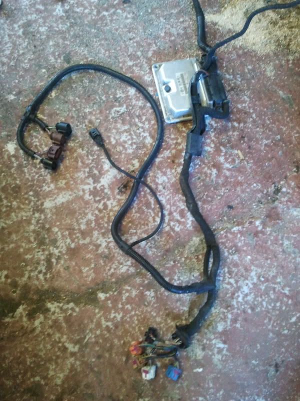

R & S Engineering 10 Posted October 26, 2011 Nope.... no straight 6 pin plug :( Just had a quick look, the loom comes from the engine - ECU. Then another plug from ECU - fusebox plugs and x4 Lambda plugs (i think). There is also a small 2 pin plug too. Cant see that anything has been cut. I will stick up a pic in a sec Quote Share this post Link to post Share on other sites

Kevin Bacon 5 Posted October 26, 2011 Yeah get some pics up as your donor car may have had a different pedal plug ---------- Post added at 12:12 PM ---------- Previous post was at 11:56 AM ---------- Can't see it if it's on photobucket. I'm at work and they block personal storage sites. You can attach it to the forum as well though! Quote Share this post Link to post Share on other sites
R & S Engineering 10 Posted November 3, 2011 Pic is up. has anybody got any ideas? Quote Share this post Link to post Share on other sites
Kevin Bacon 5 Posted November 3, 2011 I had a look and there wasn't enough of the loom in shot to be able to tell for sure. Quote Share this post Link to post Share on other sites

Kevin Bacon 5 Posted November 3, 2011 Cheers Boosty. What I meant was, there's 2 looms heading off into the distance that aren't in shot. The one going straight up is probably the injector/throttle/coilpack etc harness and I can see the lambda loom in shot, but the one going off to the right is anyone's guess! Quote Share this post Link to post Share on other sites

R & S Engineering 10 Posted November 4, 2011 Ah sorry. ummm cant remember off the top of my head what that other loom (off to the right) is for. But it is connected to something... There were no spare plugs anyway :( Quote Share this post Link to post Share on other sites

G60_edge 0 Posted November 5, 2011 (edited) If it's anything like a 20vT loom then it will be in the loom that connects to the coloured plugs in the bottom of the picture. Can't remember which coloured plug is DBW pedal without checking, would be best to check on your engine wiring diagram anyway. I just bought a pedal plug and pins from VW and will extend the right wires. Sent from my HTC Desire using Tapatalk Edited November 7, 2011 by G60_edge Quote Share this post Link to post Share on other sites
bigpants baby 0 Posted November 7, 2011 DBW pedal loom has a blue connector,I have a few pedals & pedal looms if required? Quote Share this post Link to post Share on other sites
