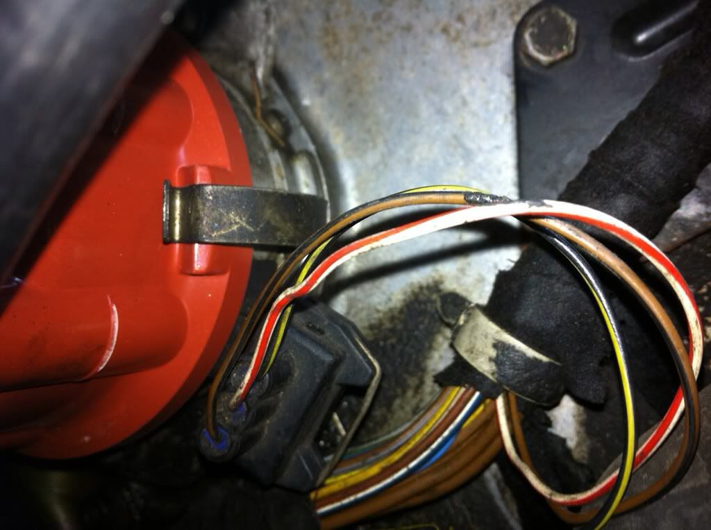

rubberdubber 0 Posted November 8, 2011 hmm it does drive like the ignition timing is retarded. so mine being an early distributer model it dosent have a cam sensor? but has the following sensor seen in the image instead?? i cant find it on etka so assuming it comes as a whole distributer? :( interesting i appear to have an earth connection adrift which you can see pictured, cant find a wire for it mind... ---------- Post added at 07:57 PM ---------- Previous post was at 07:48 PM ---------- the fault code for the hall sender g40 fault is 00515 Quote Share this post Link to post Share on other sites

Supercharged 2 Posted November 8, 2011 Wiring looks. A bit suspect! Quote Share this post Link to post Share on other sites
rubberdubber 0 Posted November 8, 2011 cheers for your help chaps, nice how to tom, had a google search seems you change it by stripping the distributer. the problem seems to be finding the part, may have to give bosch a call. yeh i thought that about the wiring upon closer inspection its silicone sealant stuck to the wires not burnage! Quote Share this post Link to post Share on other sites
