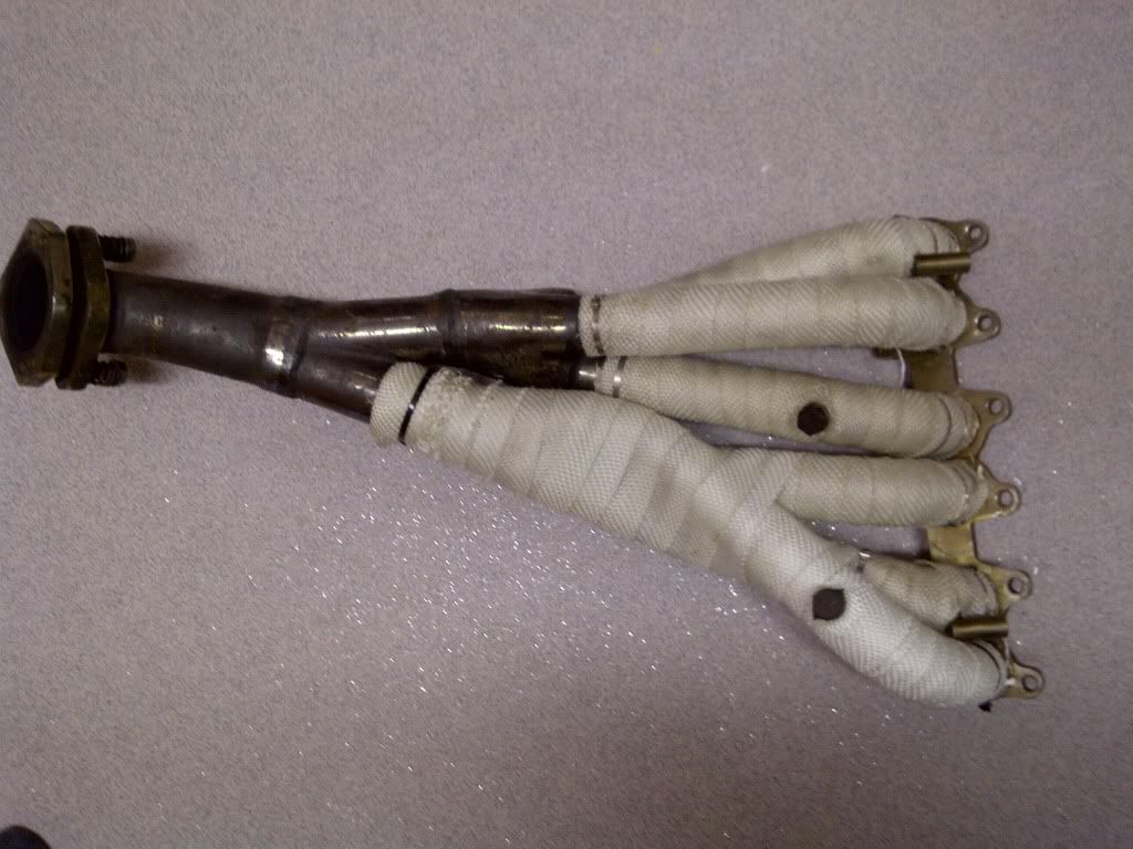

gary dw 10 Posted February 5, 2012 thanks probaly similar to how il do mine. hoping to have a go today but still waiting for heat wrap. :bonk: taken a pic after giving it a little clean off Quote Share this post Link to post Share on other sites
gary dw 10 Posted February 7, 2012 well 13.5 meters later and i need to order more. didnt find it that bad. has taken 2 hours so far. is a tedious job but once you get into the swinge of it, it falls into place nicely. thanks again for another evenings work trevr6adict Quote Share this post Link to post Share on other sites
