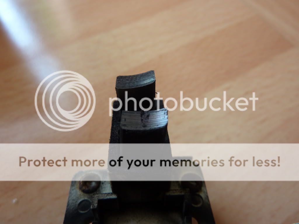

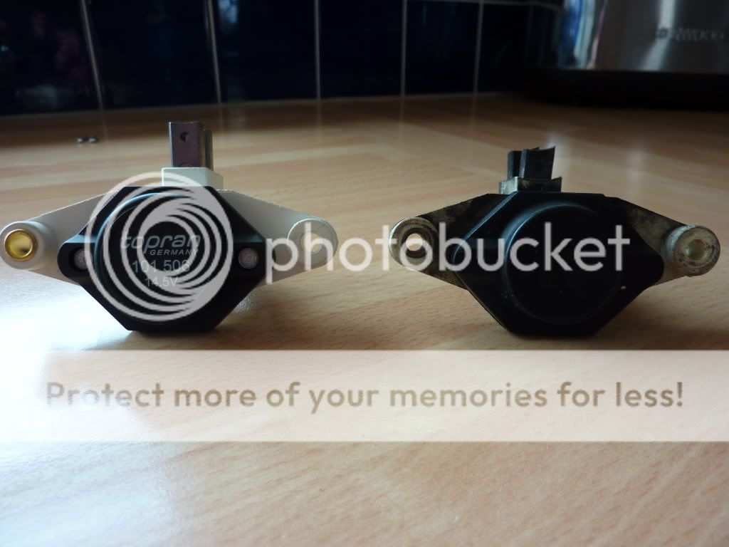

carrots 1 Posted June 18, 2012 (edited) fitted a new regulator today £12.50 off ebay.i didnt remove the alternator to fit it.the bushes looked worn out. Edited June 20, 2012 by carrots Quote Share this post Link to post Share on other sites

carrots 1 Posted June 21, 2012 tested the alternator and its showing good on the tester and putting out 14.2volts under load .happy days Quote Share this post Link to post Share on other sites
