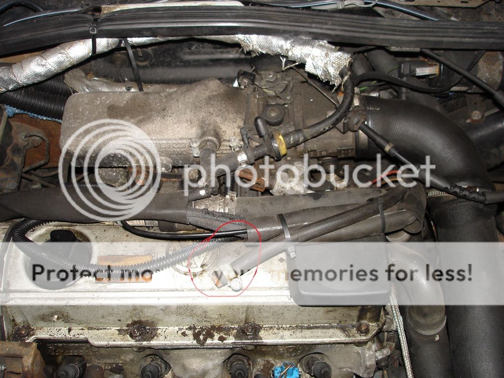

sgaites 0 Posted January 14, 2013 Hi all I'm trying to track down where the circled pipe in the pic should have attached to, before it had been chopped and blanked. When the car was running, there was fuel leaking out. It's a G60 if that helps.... I thought it was something to do with emissions, but the charcoal canister pipework looks intact. Any help welcome, I will keep trying to track down a pic of an unmolested G60 engine bay. cheers Quote Share this post Link to post Share on other sites
JonnyG60 10 Posted January 14, 2013 Is it from the back of the throttle body? Pretty sure it's to do with carbon canister removal as mine is cut off and blocked. Here's a diagram for removing the canister that might help [ATTACH=CONFIG]71641[/ATTACH] Quote Share this post Link to post Share on other sites
Supercharged 2 Posted January 14, 2013 Hmm - that looks a mess, usually those pipes get removed completely when the CC is removed... Fuel is a worry - the only fuel pipe round there is the small U bend from the end of the fuel rail to the sensor above where you've circled with a brown plug - check this very carefully for leaks as the exhaust manifold is below it! ---------- Post added at 11:47 PM ---------- Previous post was at 11:47 PM ---------- Hmm - that looks a mess, usually those pipes get removed completely when the CC is removed... Fuel is a worry - the only fuel pipe round there is the small U bend from the end of the fuel rail to the sensor above where you've circled with a brown plug - check this very carefully for leaks as the exhaust manifold is below it! Quote Share this post Link to post Share on other sites
Riley 0 Posted January 15, 2013 Yep, that's the carbon can hose from the throttle body. There shouldn't/can't be any fuel coming out of it, only way that could happen is if for some reason it's been fitted to the end of the fuel rail (As supercharged mentions) Follow it down to the lower right hand side of the throttle body and that's probably where it leads to, or should do. Neil. Quote Share this post Link to post Share on other sites
sgaites 0 Posted January 16, 2013 So the mystery pipe leads from the end of the fuel rail: Looking at a Golf 1.8 Haynes manual (I guess near enough the same as the G60 engine) it looks like this should be plugged (no.15 in the diagram) Can anyone confirm what they have at the end of their G60 fuel rail for me ? Cheers Quote Share this post Link to post Share on other sites
Tigerfish 10 Posted January 16, 2013 maybe this helps? http://the-corrado.net/showthread.php?45117-G60-Fuel-rail-and-pipes and this Quote Share this post Link to post Share on other sites
dannyboy 0 Posted January 16, 2013 (edited) Fuel pressure cut off switch hose.That pipe alone has killed many g60s.if the pipe has very small cracks or brittle,change it immediately. All 3 of my g60s leaked at this pipe.grab some new fuel hose cut same length and go to VW and get updated spring clips for hose. Few pence each. I reckon its been blanked off because its leaking and previous owner couldn't get new hose cause their obsolete.£5 for hose at halfords would sorted that and £1 at VW for two spring clips. Edited January 16, 2013 by dannyboy Quote Share this post Link to post Share on other sites
Supercharged 2 Posted January 16, 2013 Dangerous! Make sure you use the best quality hose you can get as it's bent at quite an angle. Quote Share this post Link to post Share on other sites
joeypineapplez 0 Posted January 16, 2013 Someones done the same thing to mine only they shoved a screwdriver into it and clamped it. I never got round to finding out what it was for. Its been like that for ages, your thread has just reminded me about it. Quote Share this post Link to post Share on other sites
sgaites 0 Posted January 16, 2013 Thanks guys, mystery solved :-) Quote Share this post Link to post Share on other sites
dannyboy 0 Posted January 16, 2013 I put some old heat shield cloth from a passat (any vw really)around the pipe to reduce the amount of heat it gets.had no probs after that. But I the spring clips were actually part of a safety recall so change them! Quote Share this post Link to post Share on other sites
Riley 0 Posted January 16, 2013 Strange that somebody fitted that hose and then blanked it off. It's the wrong one as it's too long for the fuel rail > fuel switch, that's what made me think it was the carbon can hose, which I still think it is (Looks like it's been chopped on the end so would be even longer) An absolute must to replace it as the guys say, they tend to split on the inside, while looking fine on the outside. These were the OE part numbers when I last bought them. Fuel hose: 037 133 999 (037133999). Around a tenner. Fuel hose clips: N024 122 2 (N0241222). About £1 each x2 Quote Share this post Link to post Share on other sites
Supercharged 2 Posted January 17, 2013 Strange that somebody fitted that hose and then blanked it off. It's the wrong one as it's too long for the fuel rail > fuel switch, that's what made me think it was the carbon can hose, which I still think it is (Looks like it's been chopped on the end so would be even longer) An absolute must to replace it as the guys say, they tend to split on the inside, while looking fine on the outside. These were the OE part numbers when I last bought them. Fuel hose: 037 133 999 (037133999). Around a tenner. Fuel hose clips: N024 122 2 (N0241222). About £1 each x2 Yeah that's what I though - I could see it was fuel hose but too long and it's even been cable tied up - who would do this with a fuel pipe!! Quote Share this post Link to post Share on other sites

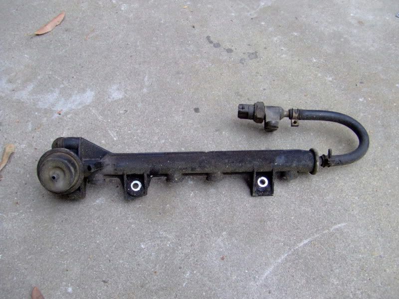

sgaites 0 Posted January 17, 2013 So is the pressure switch the silver thing in the pic with the brown plug ? It has an open end, looks like it needs something attached rt o it.... Quote Share this post Link to post Share on other sites
Riley 0 Posted January 18, 2013 Yep. The pressure sensor basically connects to the fuel rail. See pic below, and imagine the end of this hose looping down and running to your fuel rail. Quote Share this post Link to post Share on other sites
