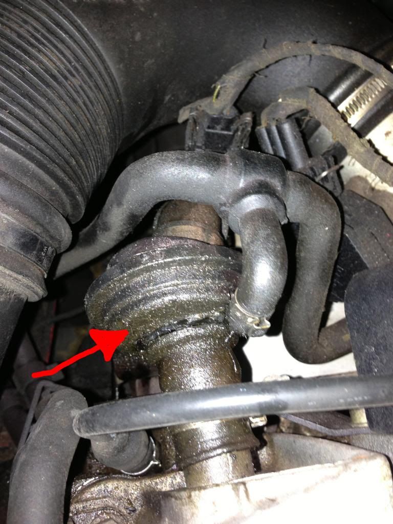

ww-promo 0 Posted January 29, 2013 Just discovered this part has a huge crack in it, but no idea what it is... Does anyone have a spare working one to replace it? Cheers Share this post Link to post Share on other sites
VR6 0 Posted January 29, 2013 Just discovered this part has a huge crack in it, but no idea what it is... One of the red arrows? :shrug: Share this post Link to post Share on other sites
beastie4126 0 Posted January 29, 2013 It's a non return valve or whatever it's proper name is (someone will remember). Ford Galaxy's use the same engine and the part can be bought from them a lot cheaper. Share this post Link to post Share on other sites
red arrow 0 Posted January 29, 2013 One of the red arrows? :shrug: Not me - LOL Share this post Link to post Share on other sites
beastie4126 0 Posted January 29, 2013 It's a PCV or 'valve-crankvent' if you go to Ford. Part number from Ford is 7364573 and about £60 cheaper from them too Have fun Share this post Link to post Share on other sites
Stonejag 10 Posted January 29, 2013 Or just ditch it and replace it with a straight pipe from inlet elbow to the top of the valve cover. The cross-shaped vacuum pipe is replaced with a straight bit of hose from the side of the throttle body to the carbon canister valve - normally blue, located on offside suspension tower behind the inlet elbow. Cost: If you do this, you'll need to check on / clean out any accumulated oil sludge every year or so. Stone Share this post Link to post Share on other sites
