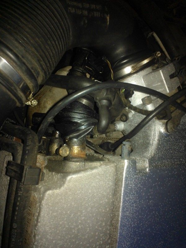

What's This? It Looks Broken!
Guys, sorry another newbie question! What's this little thing?
The rubber bit has a load of cable ties around it and it looks to have seen better days.
Cheers for any help in advance :)
Bin it, one more thing to go wrong ;) One bit of hose from inlet elbow to valve cover, another from vacuum feed by throttle body to the carbon canister valve on the strut tower. Easy peasy.
