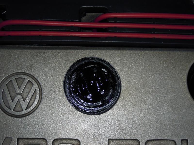

Not sure how well it shows up on the photo, but there's definitely a little mayonnaise in there - water in oil.

Have you checked your dipstick? If its creamy water is definately mixing with water, if its spots on the cap may be condensation. If Head Gasket has gone it doesnt look like its between oil and water. It sounds more like cylinder and water. Timing chains are meant to last life of engine so if theyve been replaced you wont need to replace then again.

i had replaced a blown fuse on the electric pump, which was blown since i bought the car and it started losing water every day, i went through the panic of thinking it was BHG, but then remembered that this all started after i replaced the blown fuse, i pulled the fuse out and water level has remained constant ever since, i did spend a whole weekend looking for a leak , and couldnt find one, the car runs spot on, i did also had a a little bit of mayo on the oil cap, but the guys here said it was probably down to low daily mileage.

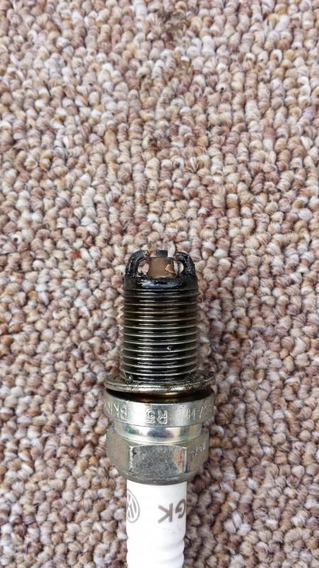

The worst of the spark plugs came out looking like this:

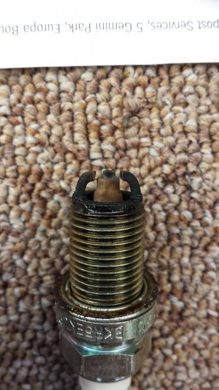

The other 5 came out looking like this:
