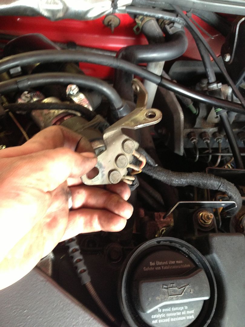

Where does this go??
As per usual with jobs like this I have put the whole car back together after doing the head but I can't for the life of me work out where this plate goes.....
Can someone please advise
It goes somewhere to the right of the oil filler cap. Near the ISV and aux water pump I believe. I have my C in bits, so will get a photo if you are still stuck later.
Left of the oil filler cap.
It fastens to the back of the head in two places and the threaded hole sits horizontal facing upwards. The threaded hole is what the HT lead cover screws into.
