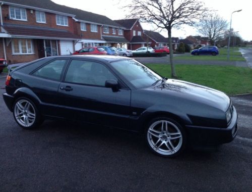

hey all. I've always owned golfs but had my eye on a corrado for quite a while now. i finally bought this one
Unfortunatly she is not perfect. The drivers electric window did not work which i have fixed. the motor wasnt plugged in due to all sorts of wires being caught up in the regulator. the rear spoiler was stuck open. i have fixed this too by rebuilding the motor, with the micr switched fitted properly <.>
so far its been for free but then i got to fixing the sunroof, the motor works but there was snapped guides in there. when i came to it after fixing the other issues the motor wouldnt run, or the spoiler or the wipers. I finally traced this back to a load reduction relay. After sorting that i scratched the top of the sunroof trying to work out how it operated. now im unsure which direction im going to go with the roof.
after that Im gonna have OCD check over the charger and im gonna sort them horrible wheels
