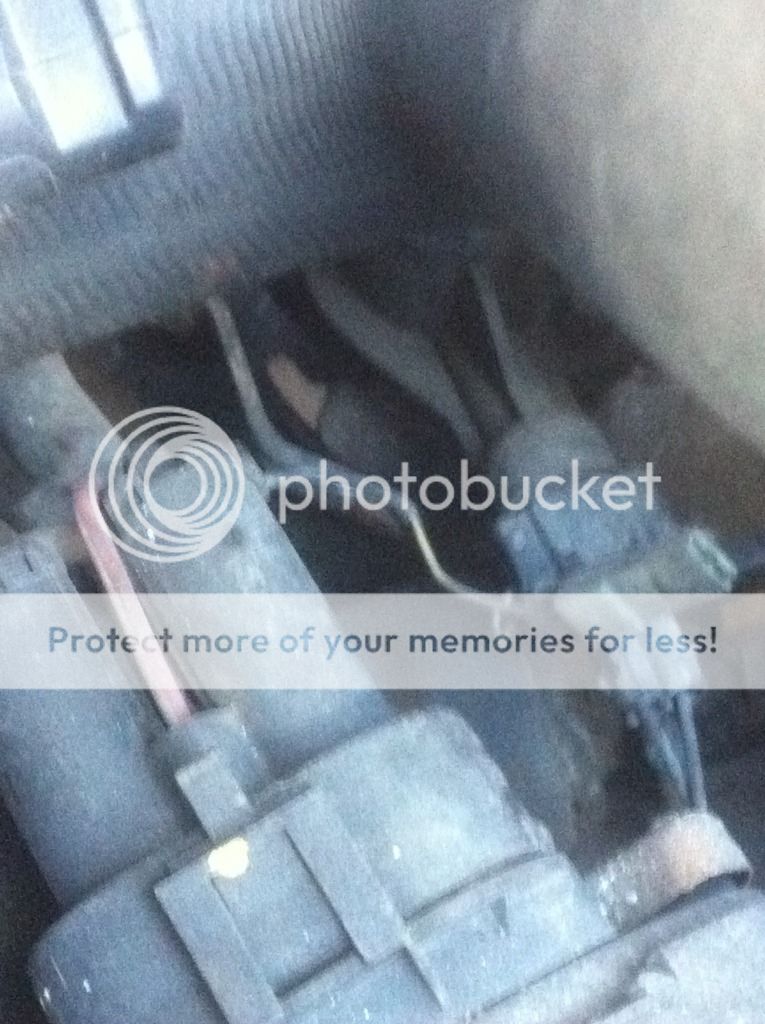

Mike_turbo 11 Posted January 31, 2016 I've been working on my corrado vr6 n plate today a noticed a single wire yellow/black un plugged not sure where it goes it's under the fan area.any ideas?? Quote Share this post Link to post Share on other sites
Harrier 1 Posted January 31, 2016 It's not used, for a different version or something :) Quote Share this post Link to post Share on other sites
Mike_turbo 11 Posted January 31, 2016 Thanks for that quick response... Quote Share this post Link to post Share on other sites

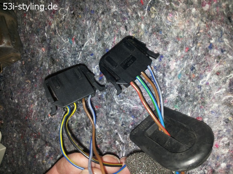

Torsten 0 Posted February 1, 2016 yes, if you are going to buy the gauges, make sure the seller also is delivering the plug (pig tail) with the gauges. my 93 came with the cassette holder and had the 2 way plug for the light of the cassette holder. im not sure if this 2 way plug is always present or only came with the cassette holder. Quote Share this post Link to post Share on other sites

Torsten 0 Posted February 1, 2016 i have two more pics of the black/yellow wire in the engine bay. i had a hard time because the pre-owner cut off the little white plug from the wire. when i searched for the white plug i cant find any. and this is how it was in my car Quote Share this post Link to post Share on other sites

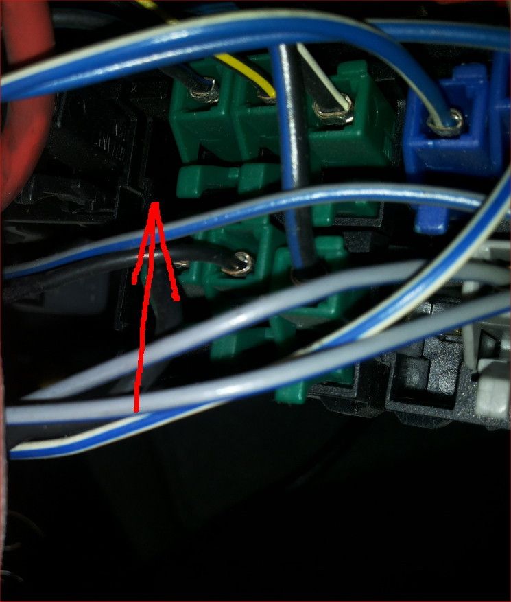

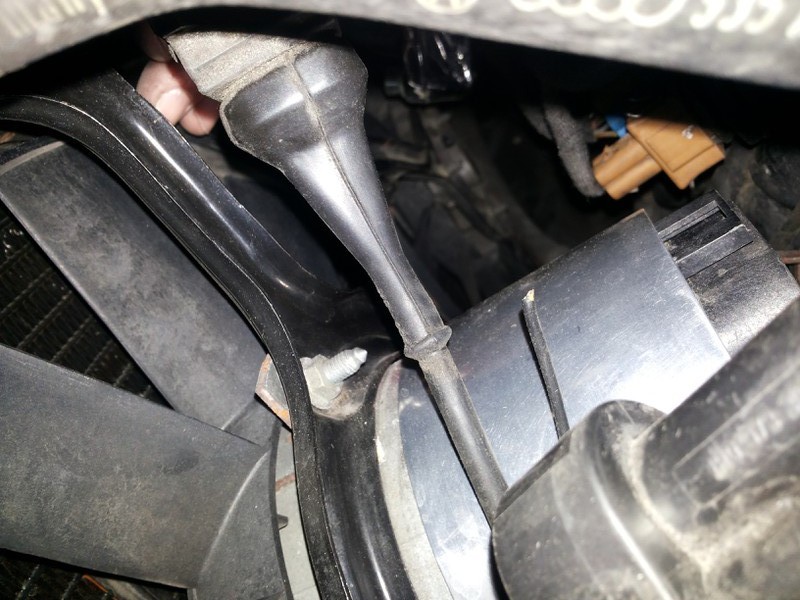

Torsten 0 Posted February 1, 2016 (edited) sorry i made a mistake. the black yellow wire coming from the engine bay is not connected to the fuse box, its just laying behind the fuse box somewhere, disconnected with a yellow plug (thats how it was in my car.) i used a multimeter to check if this is the right one and it was. the Voltmeter will be pluged in the fuse box here edit: this is the black/yellow coming from the engine bay. its got a back jacket after a few centimetre as you can see in the pic sorry englich is not my first language :( Edited February 1, 2016 by Torsten Quote Share this post Link to post Share on other sites
VAG-hag 0 Posted February 1, 2016 Thank you very much mate! Thats great! :D Quote Share this post Link to post Share on other sites
VAG-hag 0 Posted February 1, 2016 Torsten, you are now a hero of mine. I found the plug above and with the help of a mate tested it, so I have now connected up to the loom I made for my gages without the need to route anything to the engine bay. Thank you kindly :) Quote Share this post Link to post Share on other sites
