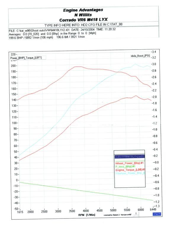

dr_mat 0 Posted October 30, 2004 unichips r great, yes they r mapped to each individual car. then when u add new mods u just have the map tweaked to suit. (sorry to dig this out again, just going thru some older posts) Actually I should have updated this thread myself: I had the unichip done, see. Well the pinking's gone, and my mid-range torque has benefitted hugely (199lbft @ 3630 rpm). Running is good, but it's too early to say if that's due to the chip or just cos the car is in a good mood. As you say, the flexibility of the unichip is cool. Plus, one day when I'm flogging the car on, it can be reverted to standard just by putting the OE manifold back on and unwiring the unichip, both of which can then be sold on as a package. This aspect appeals to me, definitely the best way to protect my Schrick investment! Quote Share this post Link to post Share on other sites
dr_mat 0 Posted October 30, 2004 And here's that nasty torque curve... :) Quote Share this post Link to post Share on other sites
dr_mat 0 Posted October 30, 2004 Spot the effect of the Schrick, eh?! :twisted: Quote Share this post Link to post Share on other sites

jedi-knight83 0 Posted November 2, 2004 thats wierd....and thats after the uni chip?? how come your power is so low and look at the size of the flat spot after the schrick kicked in!!?? It makes my plot look even wierder now! MY PLOT Quote Share this post Link to post Share on other sites
dr_mat 0 Posted November 2, 2004 Scaling issues... Your plot looks about the same, just less obvious due to the scale... The two torque curves on there are before/after the unichip was fitted. "power so low"? watcha talkin about mate? Quote Share this post Link to post Share on other sites
Kevin Bacon 5 Posted November 2, 2004 That's before and after torque, no power on that graph. Stealth's plot is more detailed than yours, which is why it looks different. Yours has been "smoothed off" considerably by software. Quote Share this post Link to post Share on other sites
jedi-knight83 0 Posted November 2, 2004 ah...i presumed that other figure was power..... so..your schrick only made 185 lbft at 5594rpm before the uni-chip... :? agreed that stealths looks more detailed...but its still a pretty big drop and im sure mine wouldnt have just 'smoothed' out the drop?? Quote Share this post Link to post Share on other sites
Kevin Bacon 5 Posted November 2, 2004 His was marred by pinking, which kills the torque. Yours has been smoothed off for readability, Matts is exactly what the dyno saw..... Quote Share this post Link to post Share on other sites
dr_mat 0 Posted November 2, 2004 Every detailed VR6 plot I've seen looks like mine does above. (Certainly the bit above 4krpm where the Schrick isn't really doing any tricks.) The pinking was killing off the whole midrange on mine beforehand. It would pink really badly between 2800 and about 3500, then because the ECU had noticed all the pinking and really really backed off the timing, I wasn't getting the normal 4krpm surge either. Hence the 185lbft! With the pinking dealt with by some judicious fuelling and a bit of additional ignition retard, it's pulling like a train, and you can really feel the shape of that torque curve when you let it pull through in-gear, as I'm sure you can on your car too. I'm pretty pleased with 199lbft on a 122k miler VR6, and I don't really give a monkeys that it reads "only" 199.6 bhp, cos I never go above 5k rpm anyway.. (And anyway, that 199.6 is moot, given that it's a dodgily predicted @crank figure based on approximated transmission losses...) Quote Share this post Link to post Share on other sites

jedi-knight83 0 Posted November 2, 2004 so i wonder what a unichip would do to mine if im already getting 196lbft at 3900rpm? Quote Share this post Link to post Share on other sites
Kevin Bacon 5 Posted November 2, 2004 You won't get a signifcant improvement on that unfortunately. If you want more, you're going to have to slot some 268s in :lol: Quote Share this post Link to post Share on other sites
dr_mat 0 Posted November 2, 2004 Jedi - when my Schrick was first fitting I was reading 195lbft, but after the ECU leaned off the mixture and "adapted" ( :roll: ) it started pinking and it really dropped right off. Hopefully it'll stay as it is now that the chip is compensating for the standard map's shortcomings... Quote Share this post Link to post Share on other sites
