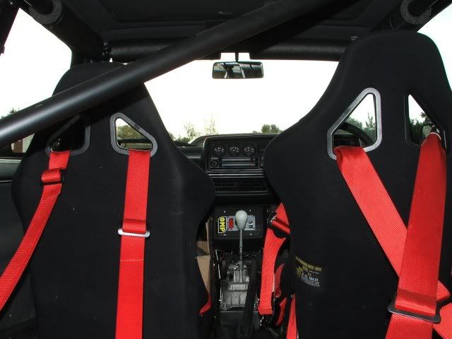

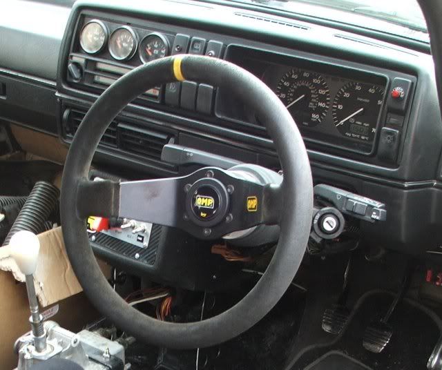

PhatVR6 0 Posted November 13, 2004 Had this idea for a while now, finally got rund to actually sorting it out today. Basically, the gearshift mechamsim on the 02A is horrendous, and universally slagged off (mainly bty fans of the 020 rod change box). This is down to 2 things. the pressed metal lever at the box end... stupid design. It's double thickness, but due to the way the bolt attaches to it, you're only usung the top half, and invariably, they crack, right where the hole is that the shifter weight sits in. Also, the lever itself is a terrible design, it's just so wrong I'm not evven going to start listing it's design flaws. Anyway, I noticed a while ago, that mk4 golfs, with the 5 spedd 02J gearbox have a different set up, ywt the o2J box is essentially identical tot he 02A. I was in the breakers today, spotted a Skoda octavia with this very box, so I whipped out the 2 bolts holding in the shifter tower and pulled it ouof the box (it's literlally that easy to remove). I also took the bracket that holds the cables too. for the shifter, they had a 3 month old mk5 golf in, so I got that one (practially brand new shifter for £40!), tower fits in the 02a perfectly. just the reverse light switch has a different connector (rob that off the mk4). Still working on the best way to make the mk4 shifter fit. It's rather large, and I got a bit carried away when cutting it down to try and get it to fit in the corrado housing. I've heard a mk5 polo ine is a lot smaller, so I'm going to try one of those next, and another mk4 one (same as mk5) to see which is best (I'd rather cut up the shifters than the car,,,,). Another bonus of this being, there's a pin in the tower, and 2 holes in the lever. put the pin in place, and drop a pin through these 2 holes, and it locks the shifters in neutral. then just pop the quick release cable connectors on to and bingo, it's perfectly calibrated! A well worthwhile mod, and the parts should cost you about £50 all in. I'll take some pics of the shifter modes whan I've wokred out how best to do it. in the meantime...go find those mk4's... Quote Share this post Link to post Share on other sites

GVK 0 Posted January 21, 2007 Spooky..I think I've used the actual Skoda 02J shift tower Paul mentions in the original post in my mk2 VR! Coupled with the shift lever/cables mounted above the tunnel 'track slag stylee' from a mk4 R32 he was breaking at one point. Gear change is as good as you'll get from an O2A Quote Share this post Link to post Share on other sites

davidwort 0 Posted May 14, 2007 needs a tap with a copper mallet I reckon, some come free easy, others seems to have some sealant that sticks them in a bit. for the benefit of early 16v/G60 owners here's what the later and slightly better 02A shift tower looks like. Note: pic below is an L/M reg passat tower in an early 1.8 16v AGC box Quote Share this post Link to post Share on other sites
