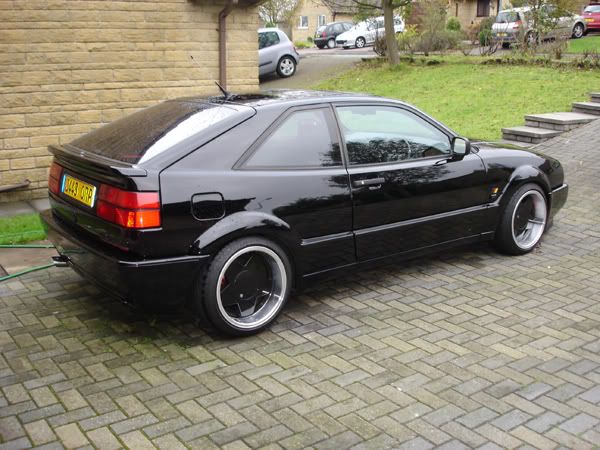

Managed to get it down the drive, sideways...and gave it its last wash for a while...
Then polished it, waxed it and covered it :(

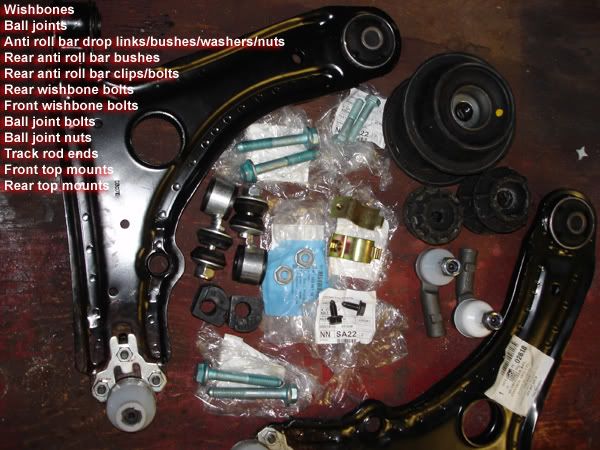

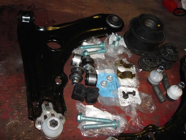

Ive got all new wishbones/track rod ends/ball joints/top front and rear mounts etc sat there (have been for ages!) ready to fit. Its about time i got around to em and got the whole car more 'finished'

Out of the below i just have the front/rear top mounts and rear anto roll bar bushes left to do.
The other stuff was done about an hour ago.

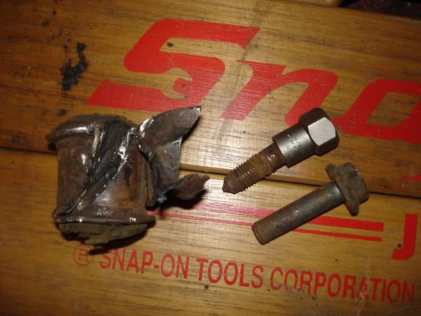

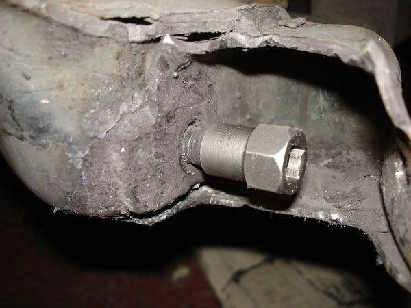

One of the front wishbone bolts snapped after very little force trying to undo it, but the irwins/heat and an angle grinder on the wishbone took care of it and the thread was fine.

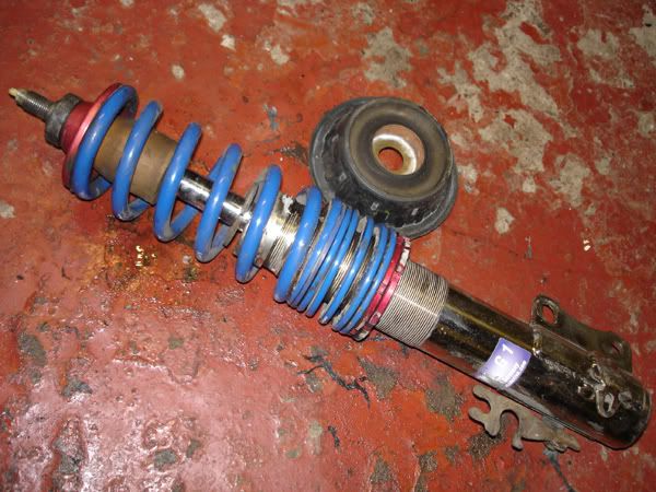

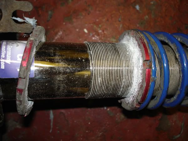

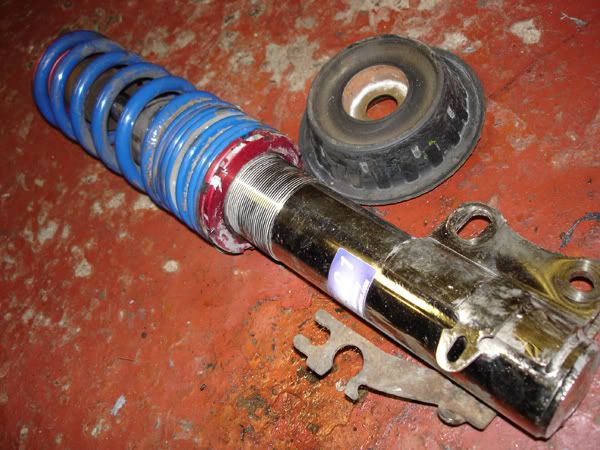

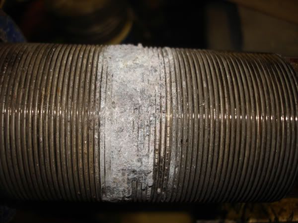

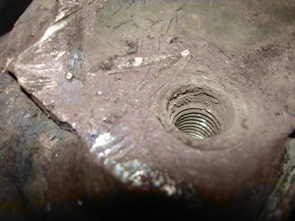

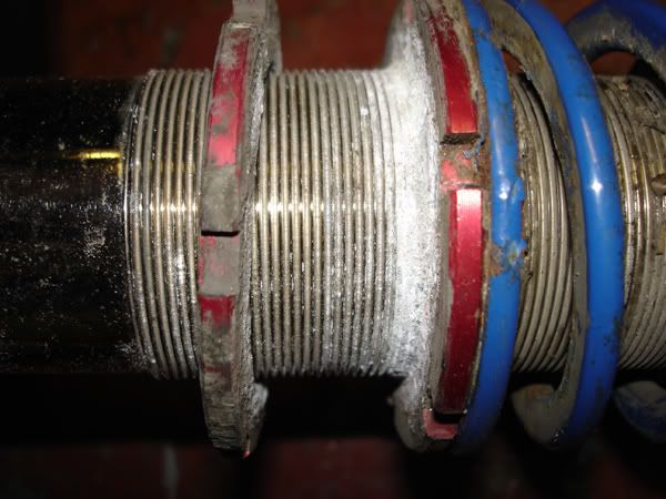

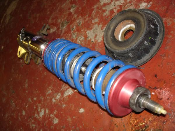

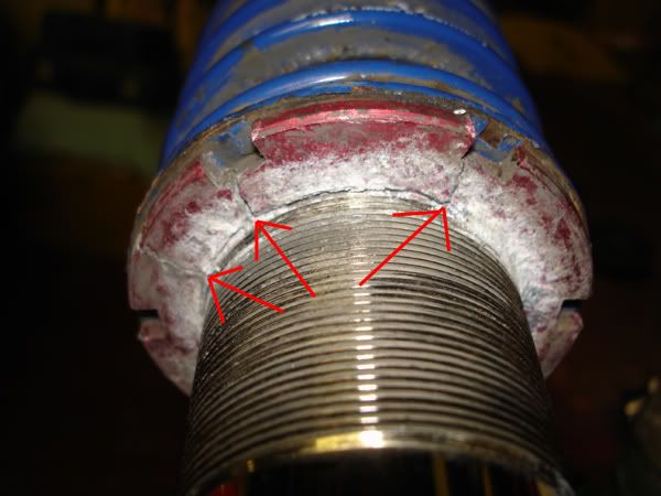

Went to replace the top mounts earlier, but the fk konigsports aren't looking very good.
18,000 miles use and about 2.5/3 years old. :censored:
Spot anything wrong here? Nothing too obvious, and i've looked after them pretty well i think anyway. The pics are after wiping off the protection spray provided and added grease.

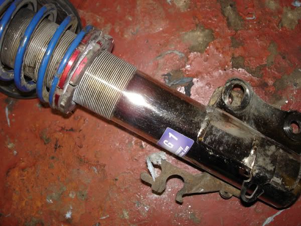

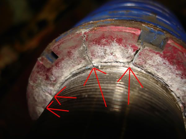

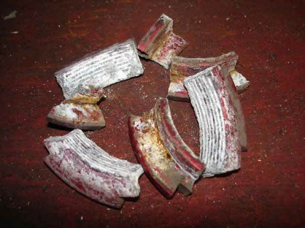

What about now? Fecking bottom collar hanging off...
Lets look at the remaining collar...I wonder how long it would have lasted before possibly causing a pretty serious accident?
And here it is after falling off in bits while just pulling at it with my hand.
As you can see, the thread on the shocker is fine, the remaining ally collar just wipes off the thread like powder.
Its obvious this is going to happen with the ally collars/steel plated body's. But im really dissapointed after paying a lot of money for supposedly good quality coilovers...
So what to do with them...You can get new collars, but are they gonna be ally again and only last two minutes?!
Yeah, i found the same problem with thew rears earlier in the year...Was hoping the fronts would have faired better. :(
That's pretty cack, how much are new collars? Does it make it worth replacing them every year or two?
I think they are £6 each x 8 (2 on each shocker) = £48 quid :|
For what was £600 quids worth of suspension id expect much better, i don't know if i fancy throwing £50 quid at them every 18k miles :censored:
Not happy man...
Yeah, its disgraceful tbh...you could have had a horrendous accident because of it. I take it FK don't state anything in their leaflet. Trading standards?
Unfortunately that is what happens when bare stainless steel meets bare aluminium (galvanic corrosion), that's REALLY bad engineering going on there, very dangerous...considering a suspension strut is just about the worse place you can mix metals- it's in an open air environment where water and salt are being sprayed onto it. The platforms aren't even hard anodized to help prevent metal to metal contact...
KW I believe get round it by using a composite platform, although I've never seen them. You should complain to them, maybe threaten them with trading standards.
Yeah it is...I understand it as disimilar metal corrosion and its bound to happen like you say. Just not something you think about at the time of purchase i guess.
I wouldn't know how to go about making a complaint etc, especially with them being a german company...And tbh will it be worth the hassle? I don't get much time to myself as it is with work etc...
Kw do indeed use plastic/composite collars as a lad on Volksdevil.com has just mentioned them. Im unsure which way to go.
I don't really want to buy new coilovers as the ride quality and the actual inserts (koni) are half decent. Im just wondering if a local company could make up some collars in stainless?
Neil.
That's shocking. At least you found it before it collapsed!
When were the collars last moved?
Is this due to FK's usings bad engineering / knowledge or a way to keep thier customers spending? After all, they don't want components to last for ever. Would expect more than 2.5 years though on a fairly expensive kit. I'd definitly speak to FK UK.

One of the reasons Im fitting some fixed shocks and springs. You may be limited in what ride height you get but there's no chance of this happening. I know of two other people who have had this.
No using stainless threads on stainless is actually prettey bad too becuase the the threads pick up, unless you use an anti gauling paste which on a strut would be hard to keep in place. I would reccomend using a molybdenum disulphide modified nylon (Nylatron GS you can get from RS) or similar ones made, take a strut down to your local machine shop and ask them to make some up, they will need to be at least 12mm though to increase the thread engagement as it is a softer material (or maybe not actually depending on what grade aluminium they have used!), on the top one it could run up the inside of the spring if you wanted. Get the outside knurled and you'd probably no longer need to use spanners on them, as the lubricating qualities of the stuff are brilliant. When you get them made though, get them to put a 4mm grub screw hole in on the lock ring, and use a long grub screw against the strut just for peace of mind.
Cheers for the info KipVR, i'll definately keep that in mind. Im gonna see what the relacements from fk are made of first and go from there...
Springs/shocks would be great...Dampers adjusted perfectly to match the ride height etc. But its the lack of clearance for the Borbets :( I can't get rid as i spent two weeks painting em :lol:

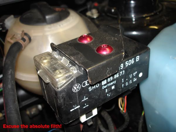

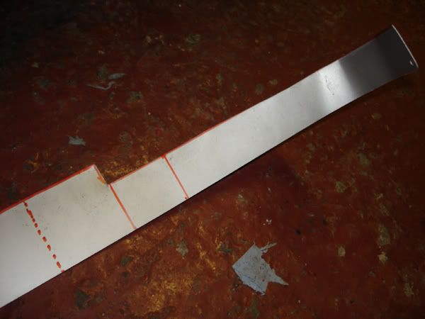

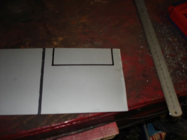

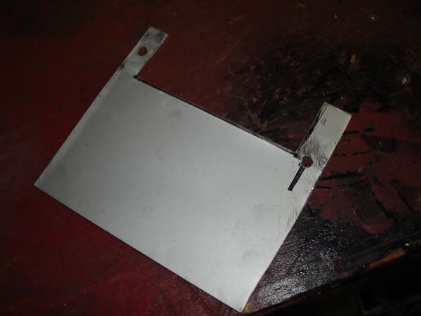

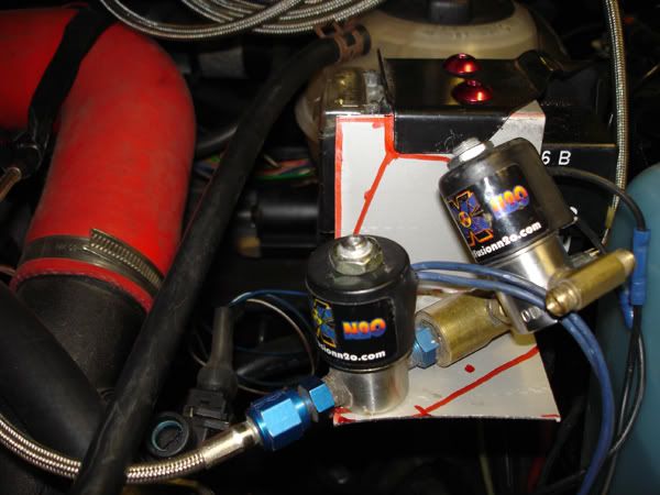

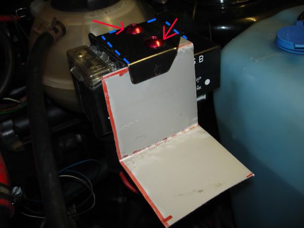

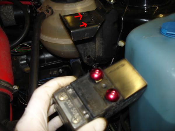

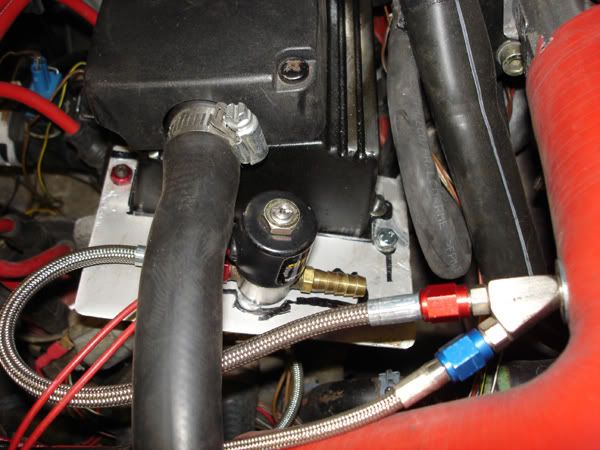

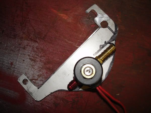

Well im bored waiting for the new coilover collars so i started making a bracket for sommet...Excuse the filth on the car...it has been parked up for a good while :(

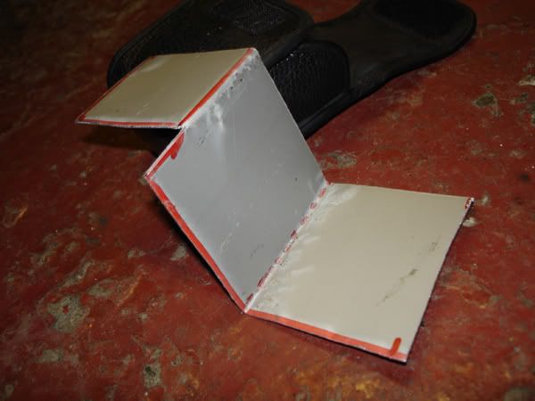

Bit of scrap ally.
Cut/bent etc...
Radiator fan relay location...
Remove relay.
Drill holes in bracket and bolt it up...
To be continued. :D

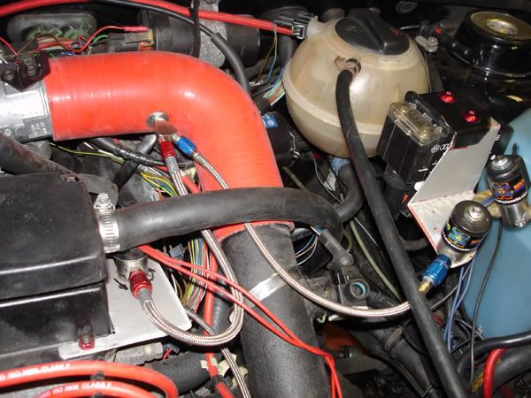

Well im just mocking up at the mo. Although things are pretty solid/paintable/useable anyway tbh...
Thats one sorted...Onto the next.

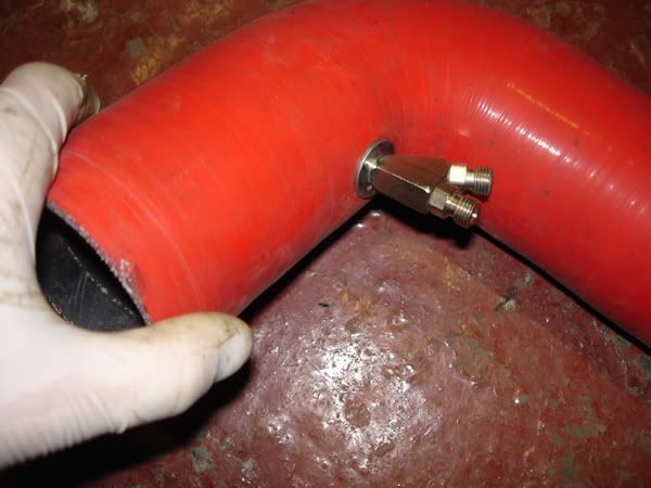

Three holes, 2 for the rocker cover studs and one for a cut down bolt on the corner as there was already a thread tapped into the rocker cover.

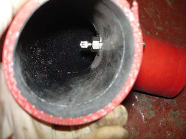

Silicone hose with a hole drilled in it...
Still need to secure this properly.
Its sits in a lot further when tight.
Im ordering 125bhp jets :lol: Obviously with a progressive controller!
Im going to 'up the power' before the nitrous is run too!
Neil.

What is this, water injection? :shrug:

What are you finding you've got high boost temps or something? Was wondering if the cossie intercooler was big enough, I'm trying to work out if I should chargecool mine or go the FMIC route?
Its a 125 brake horse nitrous kit mate :D I've still got the running problem which hopefully may be sorted before it goes back on the road...Im planning a big zaust manifold with a new full system to make sure its all leak free (current sytem blows a bit) and also trying another lambda which is definately for a model not running a cat convertor...then a remap! Hopefully the problem will show up/be cured while pumping the power up a bit...And then the nitrous can be used :D

Ive decided the silicone hose just won't do...Ive tried tightening it with a spanner and mmmmmm.Not happy with it.
Oh, and the thread on the fogger nozzle is tapered, which i forgot! So it does end up tight in the nut. Gonna have to have a boss welded into some ally pipe and then tap it for the fogger nozzle.

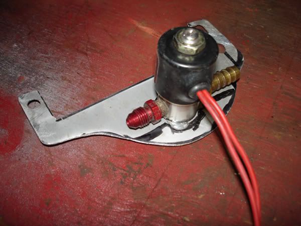

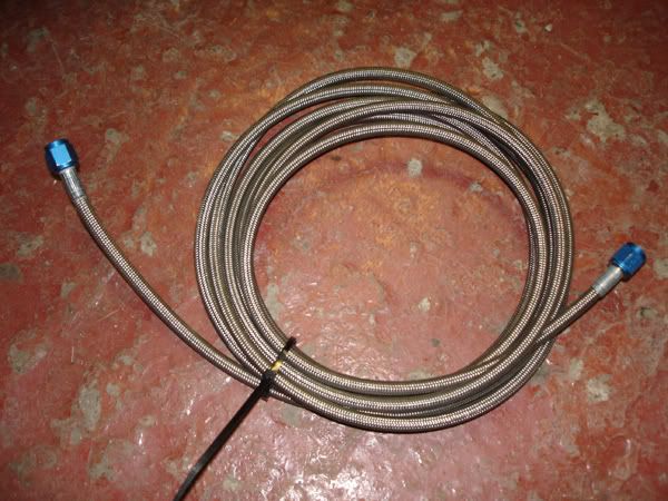

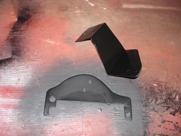

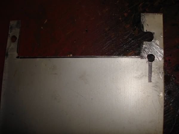

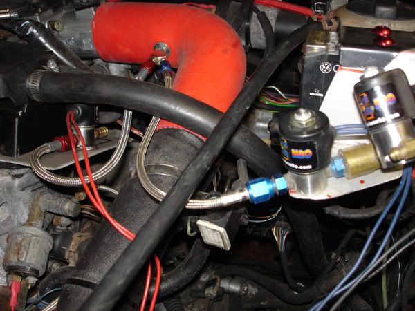

Tonight i reshaped the fuel solenoid bracket and painted it along with the nitrous solenoid bracket. Pics are showing dust after i swept up :nuts: (paint was dry though!)
And the line which will run from the nitrous solenoid through the bulk head and to the bottle.
