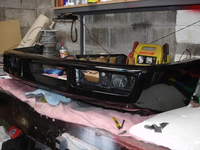

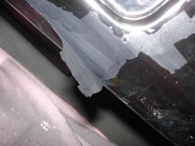

Front bumper is painted finally!
To cut a long story short...the guy who last painted it made an absolute mess of it, the paint peeled off, and it wasn't even flatted back in most places!
So i had to peel/scrape it all off! nightmare!

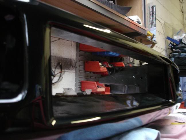

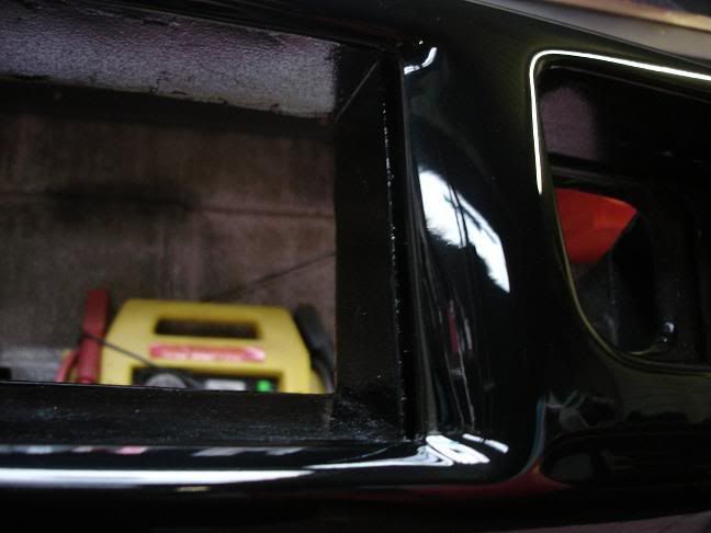

It now has the recess that i cut plastic filled, and it chamfers into the hole for the intercooler.Hard to get on the pics...

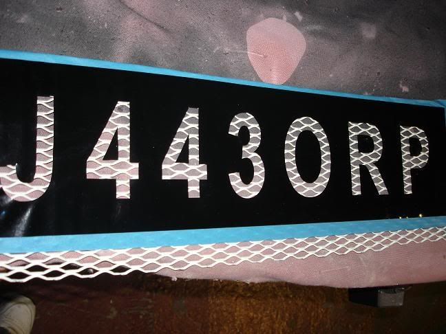

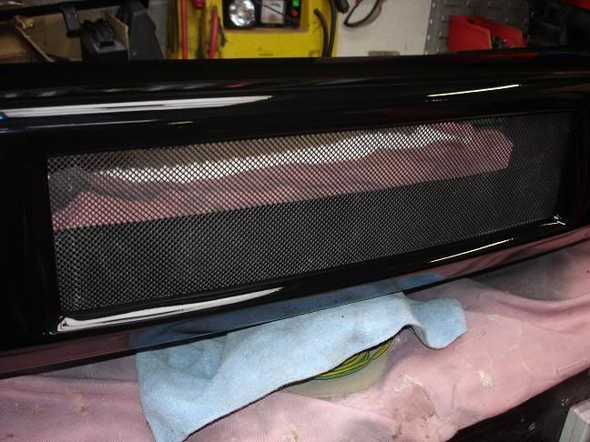

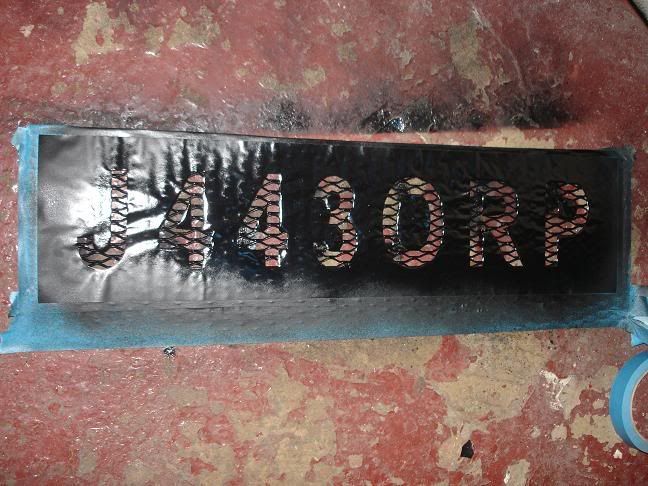

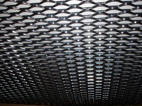

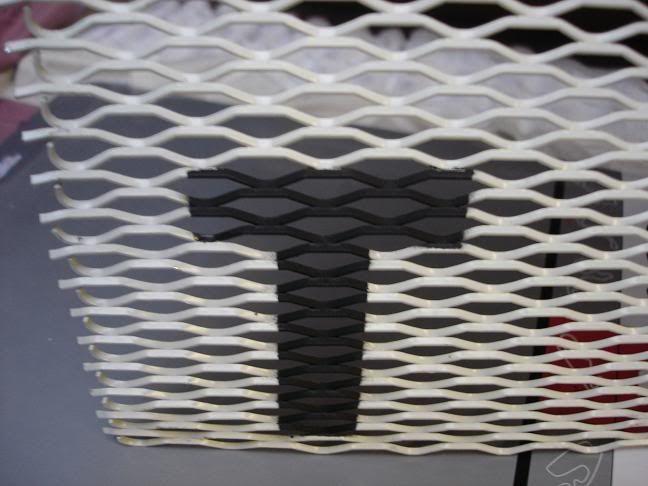

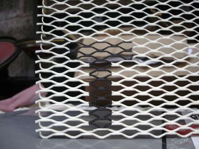

Then i thought id try the mesh number plate again, but ive gone off the idea all together i think. So im gonna go for black mesh and no plate at all.
Because the mesh has a sort of open/closed pattern depending how you look at it, it gives the below look while looking up at it.
And the below look while looking down on it.

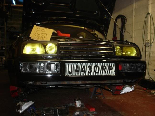

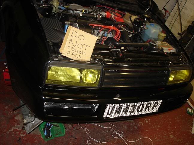

Fitted.Excuse the sign for my dad...who isn't called Jack btw (its short for jacka$$ :lol:

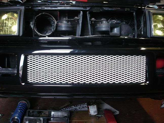

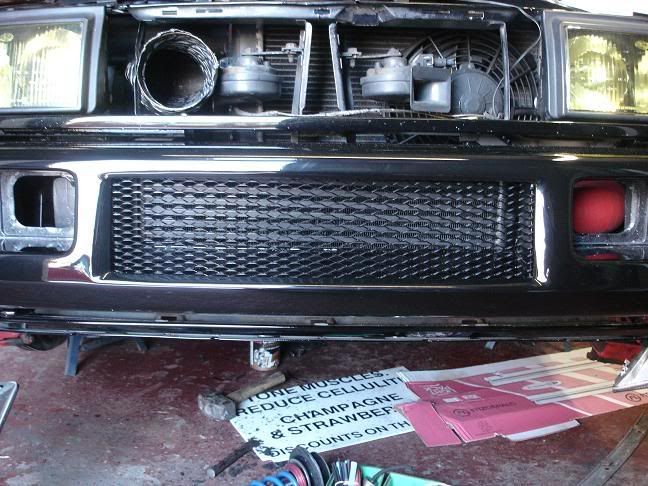

Im gonna use black mesh like below but same larger hole style as the white above.
Stands for 'Jacka$$' my dad in other words :lol:
Ive done what i should have probably done from the start :lol: I think it looks sh|t tbh, but its there for performance rather than looks i guess. At least i made an effort to get the hole in the bumper finished off nicely i suppose.

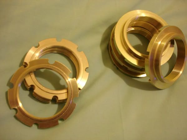

I ordered some new fk collars in November (8 in total needed) Were supposed to be around 6/7 quid each...They have arrived today at £11.50 each inc vat!!! :censored:
£92 fecking quid!
There no chance im paying that for a pieve of fecking mass produced alloy that will rot and fall off again anyway!
So thats that then...rado is staying on the axle stands for even longer. Ill never bother with FK again as they don't seem to realise that ally collars are a sh|t idea but are happy to rip you off with some new ones...which will fall apart again.
Not pleased.
Scrub the above...£90...£90!!! fr|ggin quids worth of crap that will fall to bits again :sad: Really didn't want to spend that on top of £600 quids worth of suspension, knowing that they will suffer with dissimilar metal corrosion again. Can only do our best to grease things up i suppose, not that it has helped in the past :gag: Gonna have to hold back on the nitrous for now.

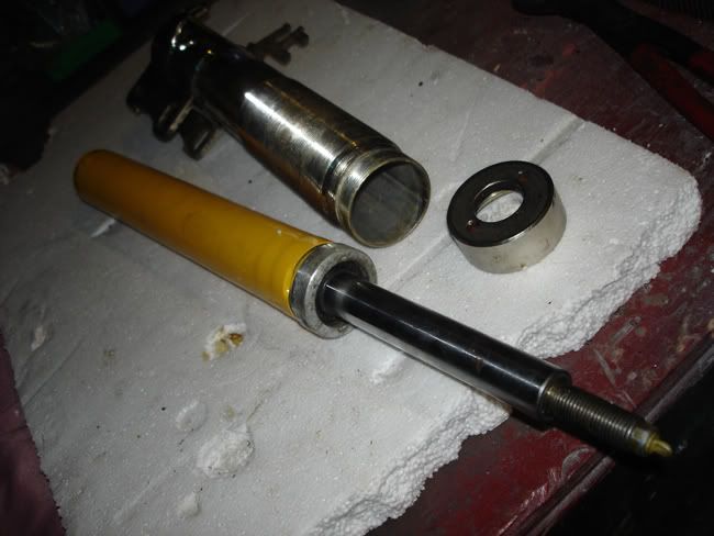

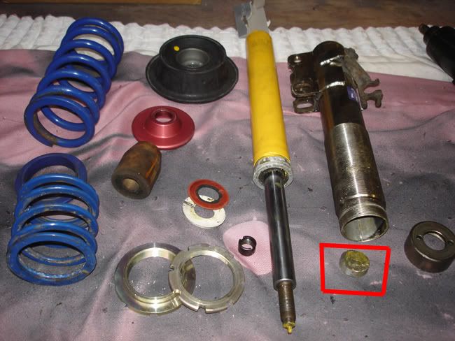

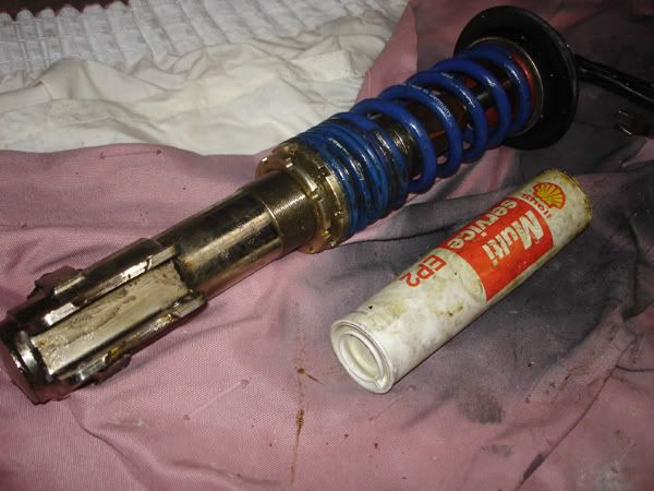

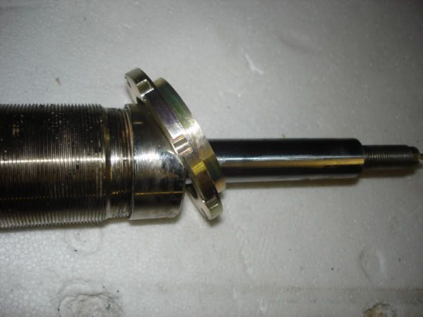

Discovered they wouldn't slide over the shocker body, what with the old ones falling off! So had to remove the strut, and its true what people say about them being Koni's!
They sit on a little spacer in the body (red in pic) New top mounts pictured too.
Built up with plenty of old skool shell grease.

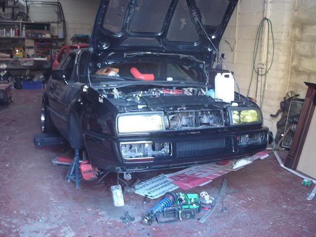

And its finally sat back on the floor! Still need to nip all the wishbone bolts up, as i just dropped it to tighten the top mount nuts.

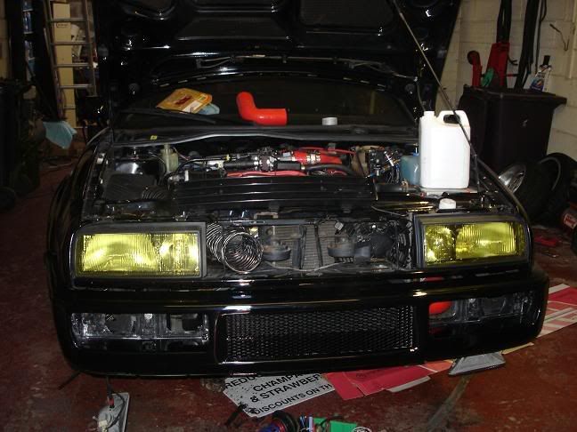

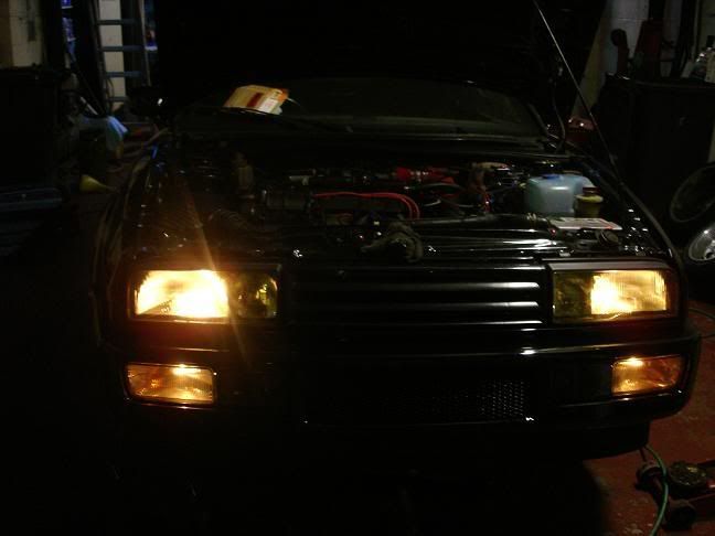

i take it you've used your yellow protection films? any trouble with the plod. is it ok to drive with them yellow?
i love the look and want to do it to my lights.
Regards,
Andy

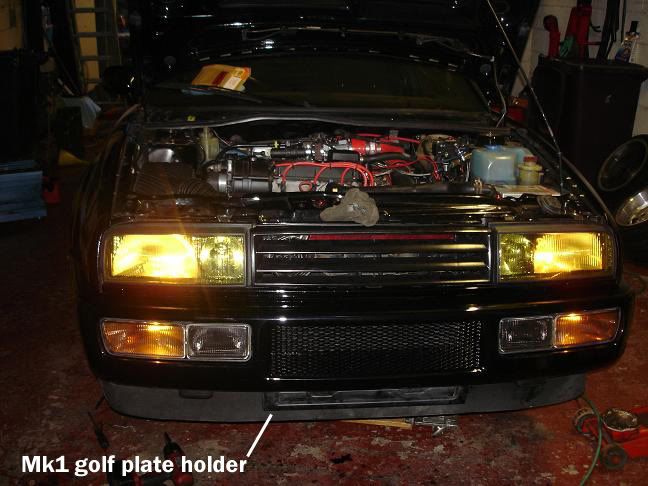

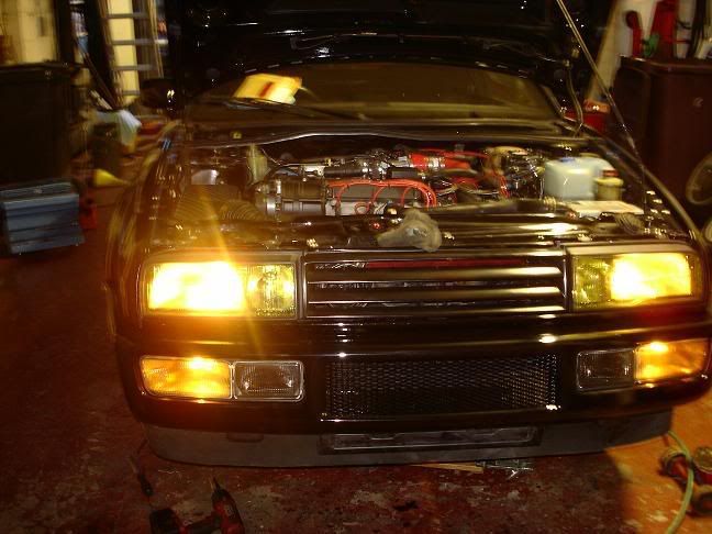

Hi mate, it is indeed the very product 8)
Its also perfectly legal as the mot 'book' states that forward facing lights must be yellow or white.
A single piece of 12"x16" (cut in half to 6"x16") will protect both faces of corrado headlights.
Neil.

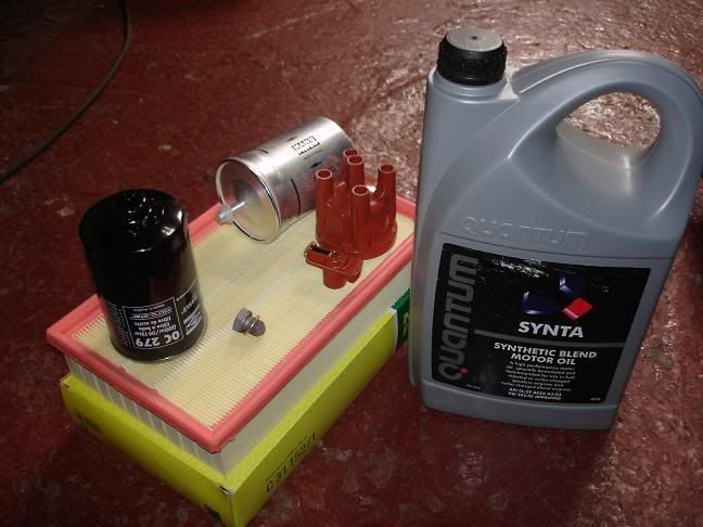

Managed to change the oil, filter, sump plug and seal, air filter, dizzy cap, rotor arm, fuel filter.

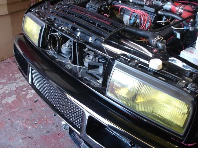

And actually got the mk1 golf plate holder mounted on the bumper, properly bolted the bumper on and fitted the lights...also used some of the same black mesh in the bottom left corner where the cold air feed is.

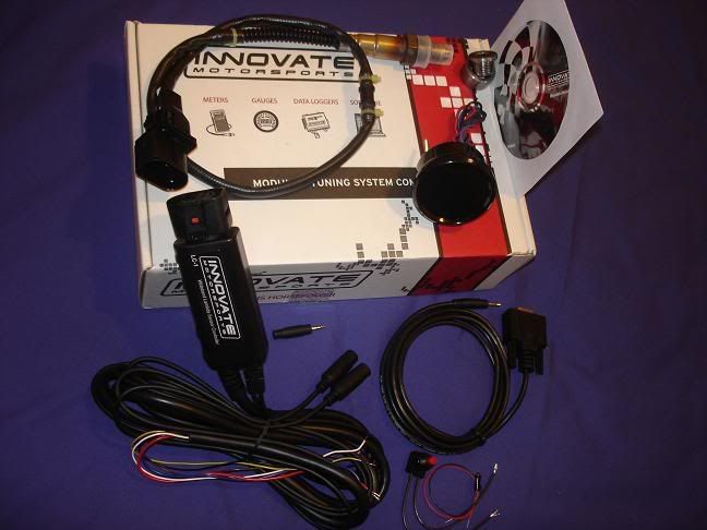

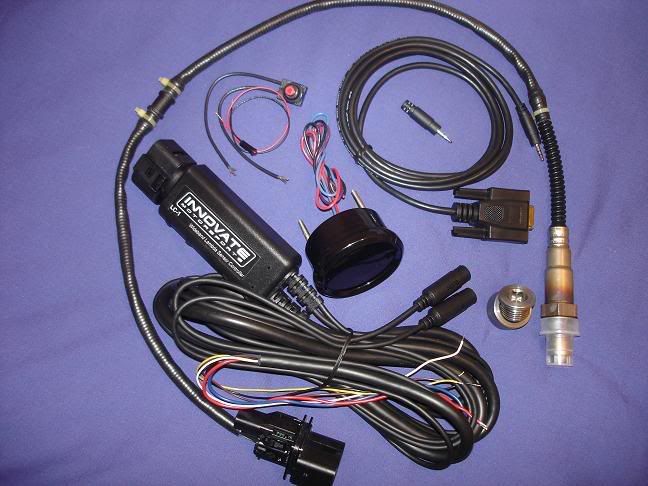

So i still have to take all the dash out and fit a new heater matrix for the second bloody time! It will at least give me an ideal oppurtunity to fit the new Innovate LC-1 wideband lambda and air/fuel gauge. :) Got it for £165 delivered via a group buy on Volksdevil, ive gone for the red gauge.

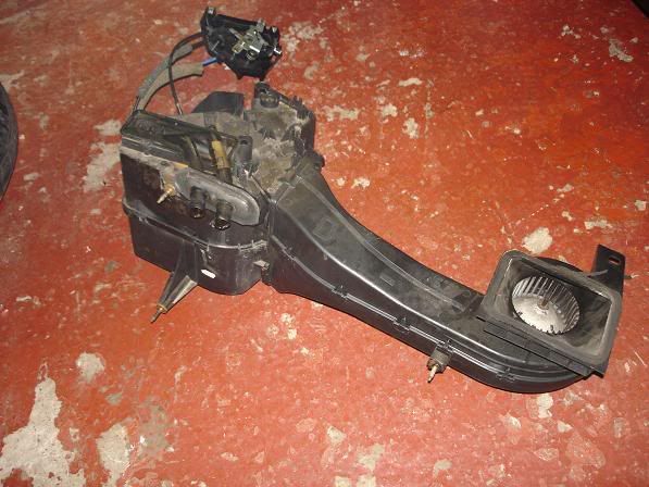

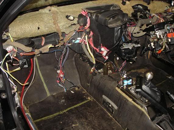

Second damn time doing this...Why the hell i still own this fecking car i don't know.

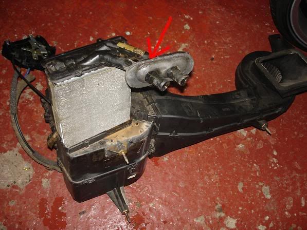

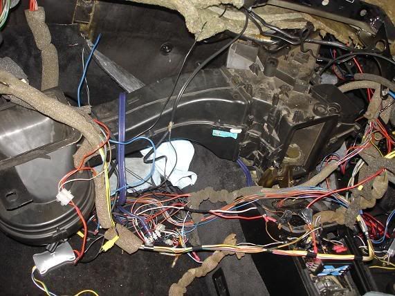

Can you spot the heater box?
There the bast/\rd is...
Ready to remove.
Out.

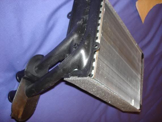

As you can see, the matrix is still pretty new.Ive only had the car 4 years and already replaced it once!!! :censored: Its leaking from the back of the flange.

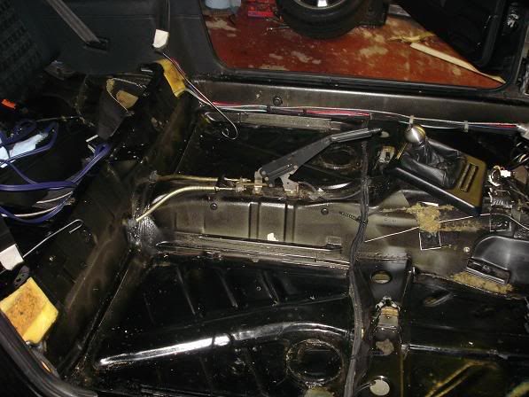

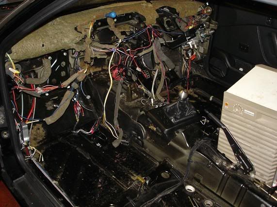

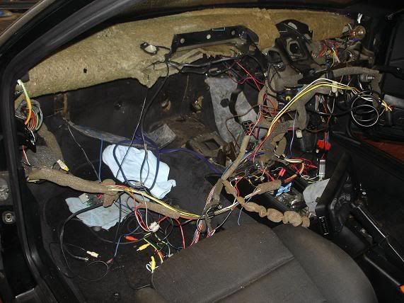

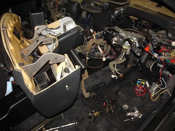

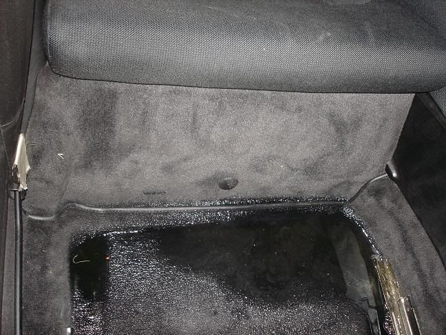

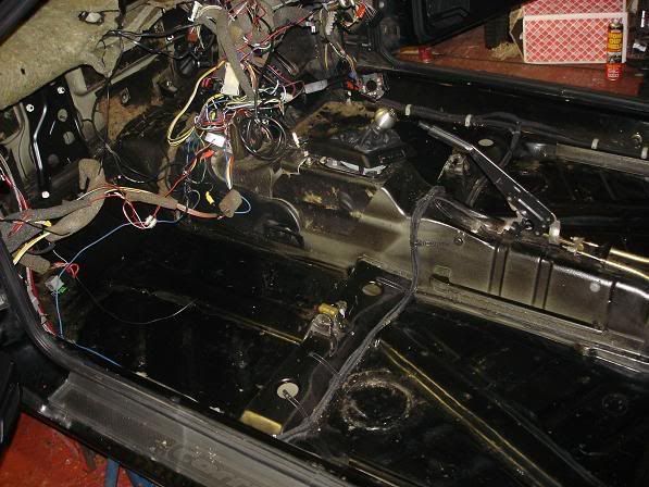

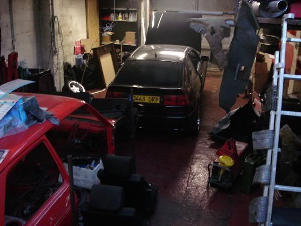

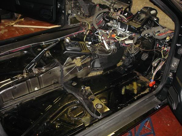

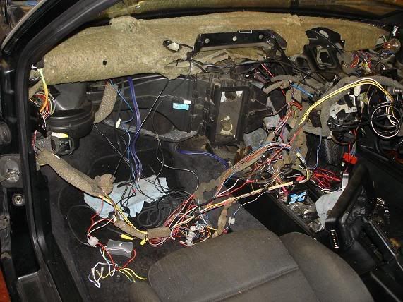

Removed all carpet, sound deadening and the million clips etc that hold it all in. Propper knackered man, what a nightmare...

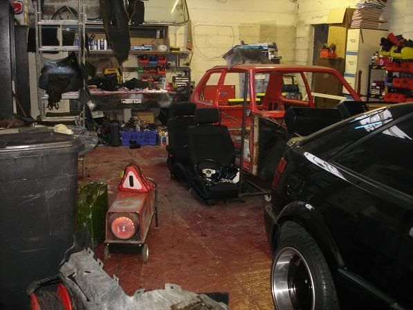

I need the car out the unit by end of the month but even being up there every spare minute i don't think ill manage it.

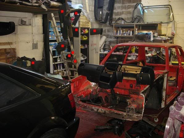

All the sound deadening is propper saturated man...Red dots on first pic show each piece hung up. Feel like im just working my b0ll0cks off for nothing all the time with this damn car.
Carpet/seats etc.

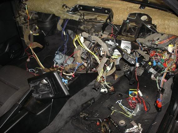

Feel your pain but at least i can now see what they looked like stripped out, so thanks for that.
Do us a favour and show me where the heater resistor pack goes?
As t'other thread Simon, find the big bunch of Yellow wires, and the plug on the bottom of the fan motor, it plugs into the actual resistor pack, silver thing that unclips. 8)

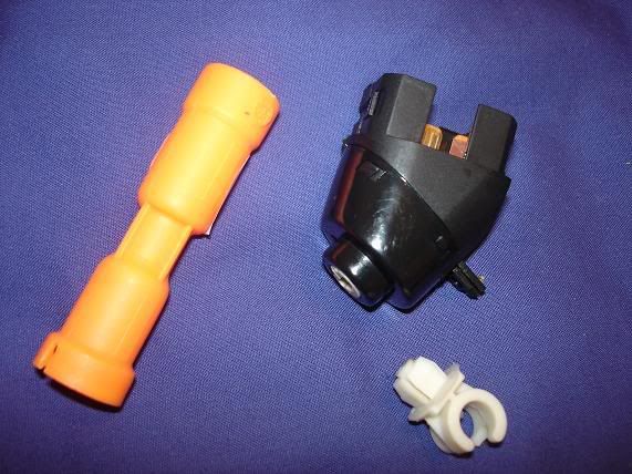

Fitted new ignition switch, the volt gauge no longer fluctuates when i move the key...Mmmmm. Also new bonnet stay clip and dip stick guide for the hell of it.
And more importantly, new vag heater matrix.
Still pulling the damp out of the sound proofing with the dehumidifier.

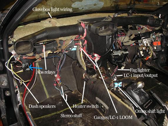

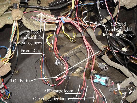

Getting there with the loom. Decided to make the lc-1 wideband fully integrated, its pretty simple stuff really. Also making a new loom for the vdo gauges, all the red/brown wires are what ive put in.
The lc-1 has fused 12v with ignition, as does the afr gauge. They have their own earths, and the gauge has a feed from the headlight switch for dimming when lights on. There is a little led and momentary push switch there too but you can't just see them, they will be incorporated into the dash as a permanent fixture for calibrating the lc-1.
The vdo gauge loom is fed from the original stereo wiring. Still need to finish it and make a little loom up for the illumination.
I never bothered with the push button and led on the LC-1 as it can be calibrated without the use of it.
Is it possible to dim the gauge with the headlights, mine says not to wire it that way or should i say it says nothing about it.
Nah its cool to do so Simon, it just says not to take power from the dimming side of things (the blue/grey wire) I took a feed from the grey/red which is sidelights so it dims with headlights on dipped/low/high 8)
I just permanently wired in the led/switch because i don't mind a bit of tidy wiremongery :lol:
Sound deadening is still a bit patchy so im leaving it just one more night and it should be ok, ill keep the dehumidifier in the car even when ive refit it all just to really dry it out.

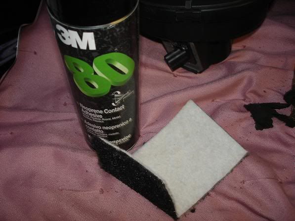

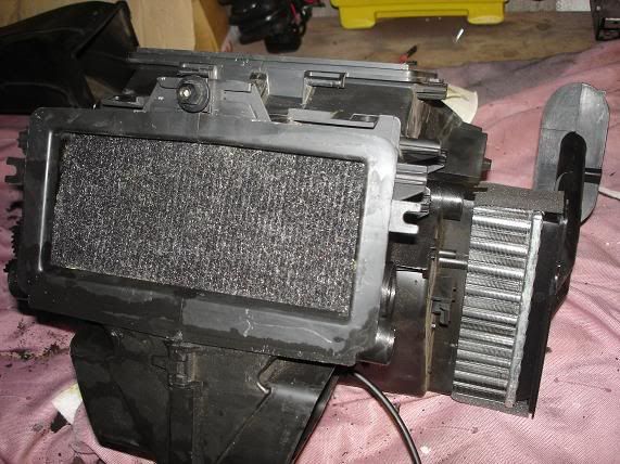

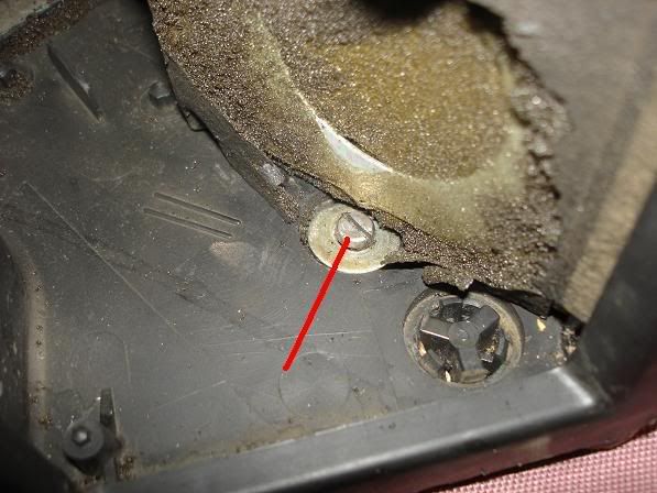

The foam on the heater box flap was tired so i removed it, and replaced with some thin industrial carpet and also fitted the new heater matrix. A peg had also come off, but it just pushed back in, probably caught it during removal.

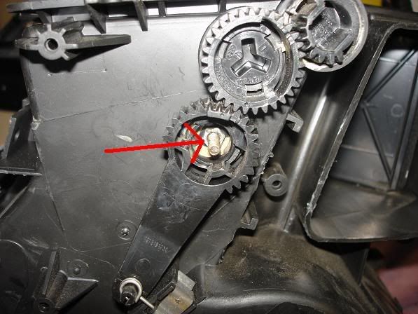

Common problem on the corrado's is the heater direction cogs snapping out of the box, here's a fix i did some time ago now...Still holding up perfectly.
Inside the heater box.
Underneath.

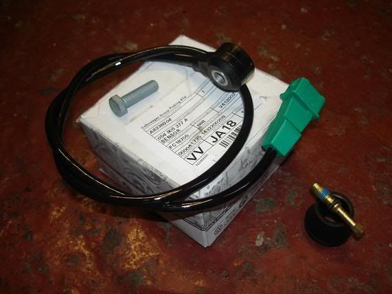

Fitted a new vag knock sensor(054 905 377A) and bolt (N010 2336 - 15lbsft-20nm), rocker cover breather grommet (028 103 500) and throttle body air screw and seal (037 133 432). The air screw feels nice and tight compared to the old one.

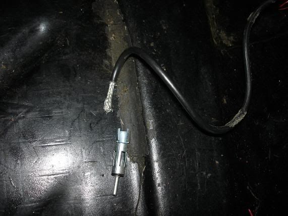

Sorted a new end for the stereo aerial, may use another one yet (original style but gold plated)

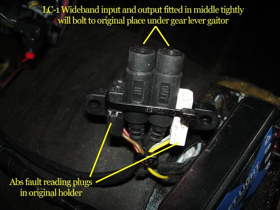

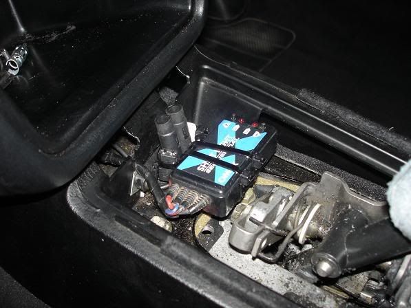

Tidy'd the wiring even more, and ran a cable from the lc-1 analog output to the area where the original lambda plug is. So i can sort running the cars ecu on the lc-1.
The lc-1 has an input and output lead for connecting a lap top etc...Ive run them to the place where the abs fault code cables are, they sit nice and tight and will bolt up as per original under the gear lever gaitor.

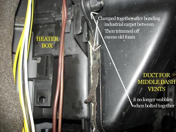

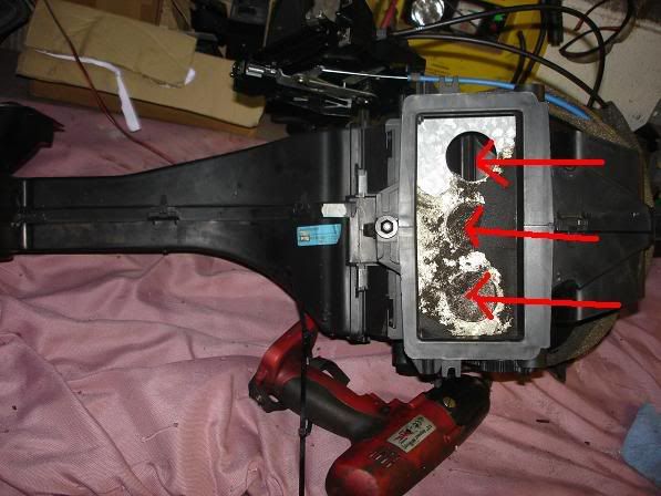

Also did another repair on the heater box...corrado owners probably know about the 'wobble' you normally have between the heater box and the ducting for the middle vents. Its just because the foam inbetween is tired. I left it on there but saturated it in spray adhesive, then cut an oblong piece of industrial carpet and clamped them together and bolted together as per original. No wobble/gaps at all now! Forgot earlier pics to show it better.

PS:Simon, 3rd pic up from bottom...blue arrow...just for you mate. Resistor pack. :wink:

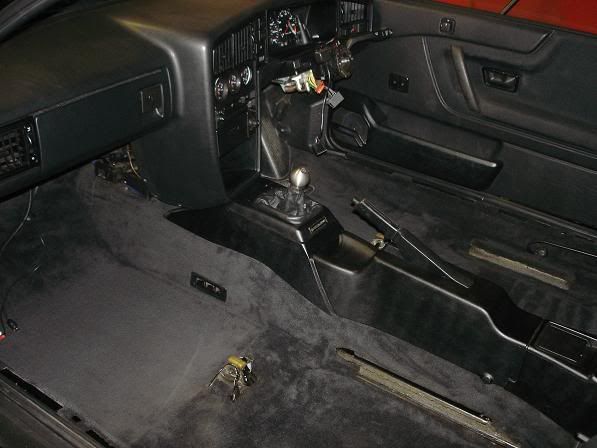

And tonight ive got the carpet/center console back in...wahoooo!
Under the gear lever gaitor, you can see the lc-1 wideband input/outputs...
