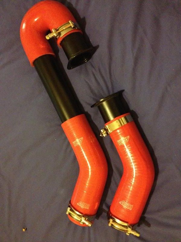

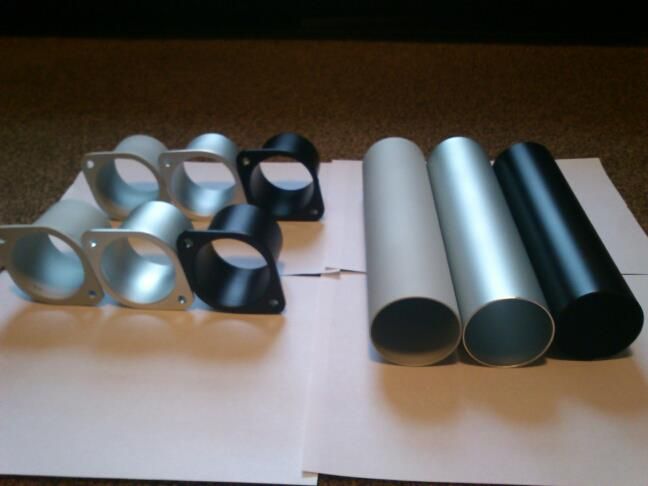

I wanted a twin inlet setup but wanted some specific specs...
Cone filters but didn't want cotton gauze for obvious reasons.
Internal diameter of the charger flanges to be as big as possible (Others tend to be 54mm)

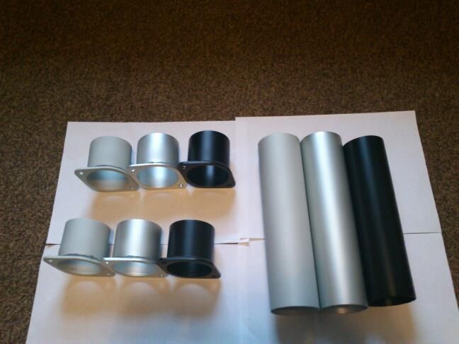

So with the help of a good mate (Manny) available here we made up a kit for it.
Found some PAPER! filters, and large ones at that! And the charger flanges are a superb 60mm internal diameter!
Flanges and pipe, mine are anodised black, but other cool colours can be had!B Red/Blue etc.
The PAPER filters, large ones with 70mm inlets/necks.
Pipework consisting of:
2x 45deg reducers, 70mm > 63mm.
1x 180deg 63mm.

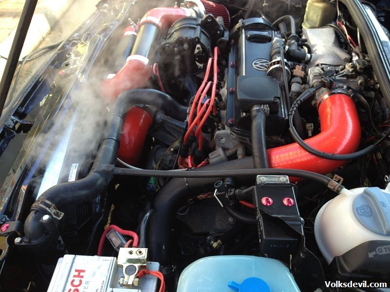

Excuse the steam in the pics as I'd just washed it.

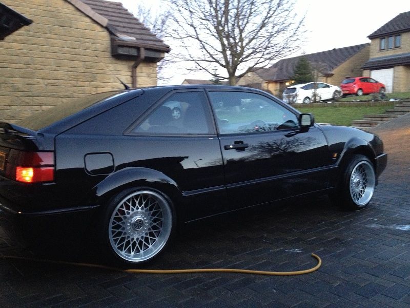

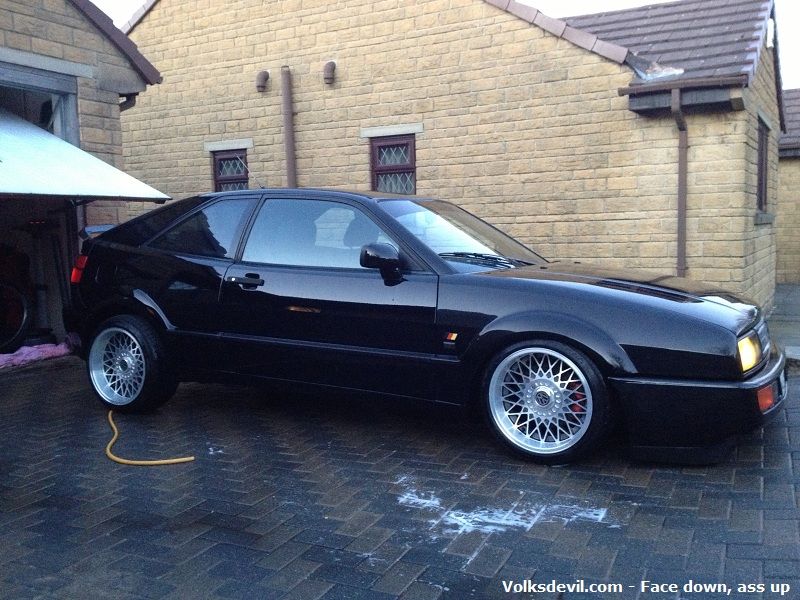

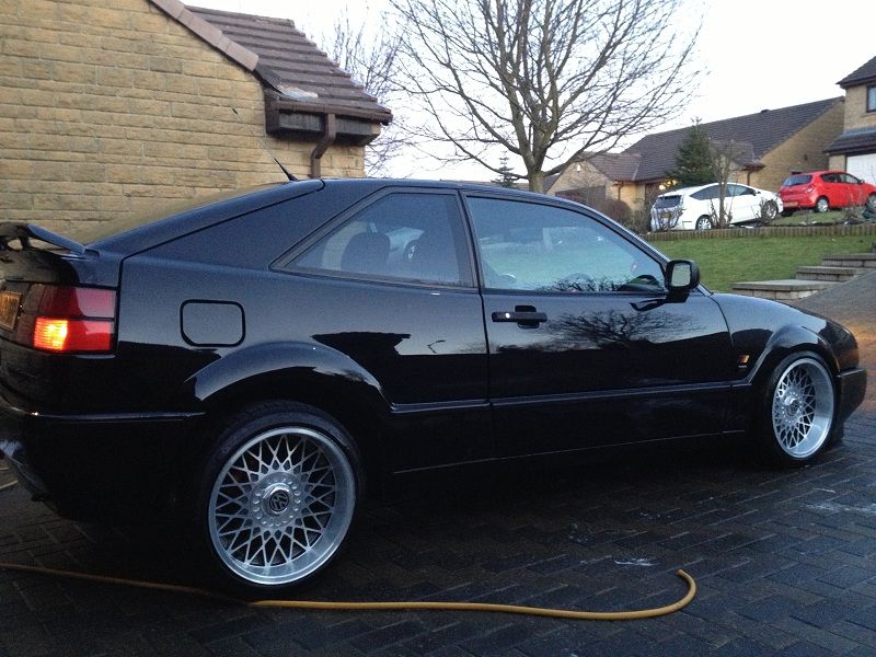

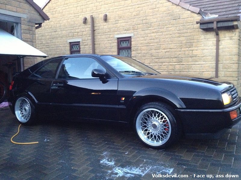

Oh, and some pics of the different ride heights lol.
Full height!
Face down, a$$ up!
Face up, A$$ down!
And all down!

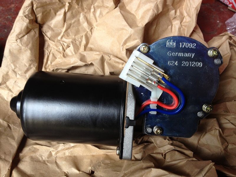

New Febi front wiper motor fitted. Wiper is supercharged now!
Where did you get that from, if you dont mind my asking? Alloys really do make the car look great ;)
Aye, a new wiper motor on a Corrado is only ever going to be a good thing lol. Gladly I only have one wiper to worry about but it's always worked fine anyway, much better than the twin setup!

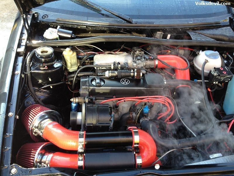

Oh and one of automatic the first thoughts when I had the twin inlet idea 'Must fabricate a heat shield'
But I honestly don't think it needs it, I'm not sure why people bother tbh (On the Corrado G60 anyway) Even after having been sat ticking over for a while, I can lift the bonnet and it's not like there's a load of hot air hanging around.
And in theory, while on the move a heat shield would actually restrict flow over the filters. Much like if you had a piece of alloy on the back of the radiator, air wouldn't flow through so well.
Oh and there's a 4" neoprene cold air feed sat directly under the filters (In the old carbon can hole) which comes from the front bumper.
youve got that bloody snail thing in between the filters and the warm engine so theres your heat shield, I agree mate, as Mark and Lard used to say " NO NEEEEEEED" Looking forward to whats next

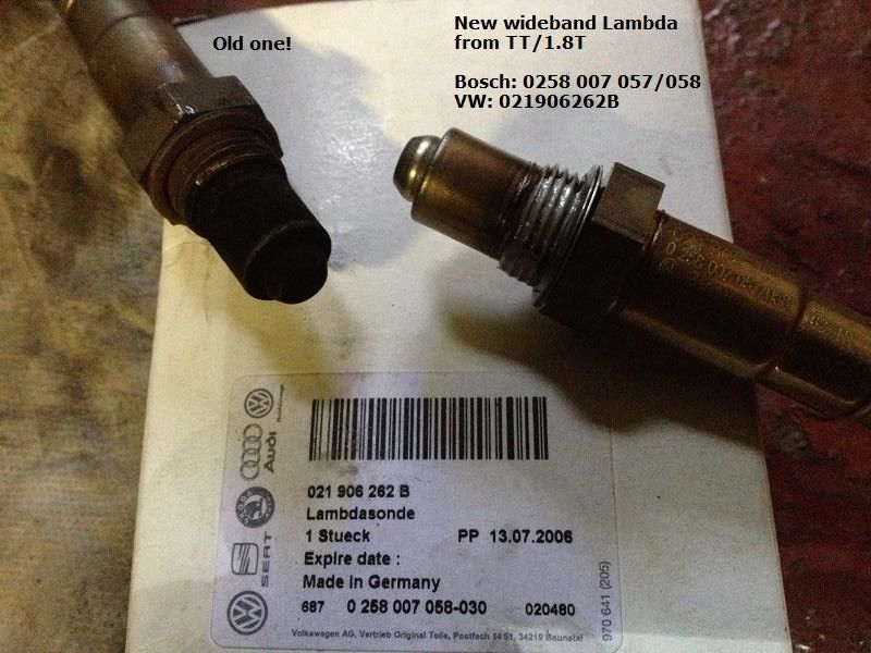

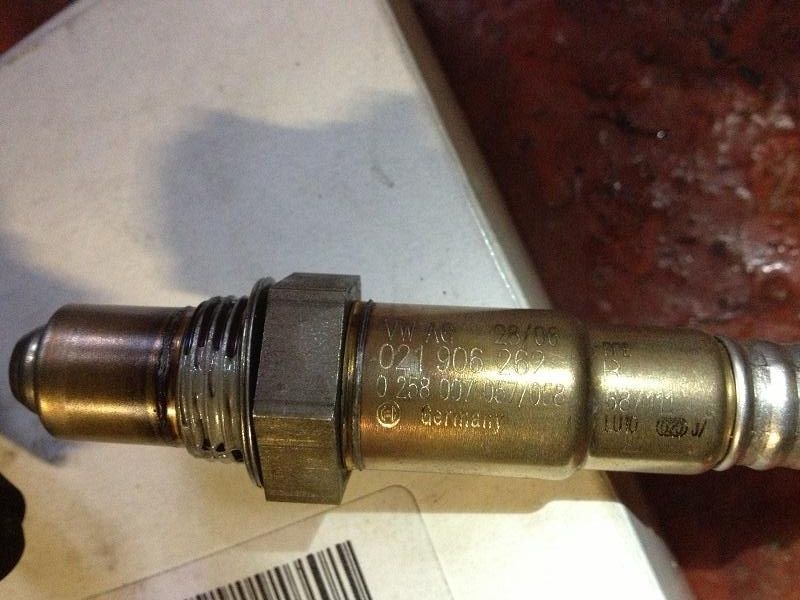

Had some issues with the Innovate wideband giving dodgy readings so thought I'd try a new lambda probe. It basically uses a wideband probe from a TT/1.8T, you can see the part numbers in pics as I went for a genuine bosch/Vw/Audi one.
Problem solved, although I'm still not happy with the Innovate kit...
