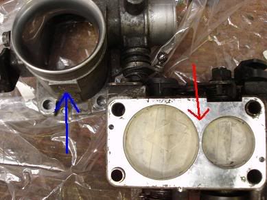

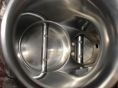

this pic shows the standard throttle body(red) and the other half i port/polished last time:

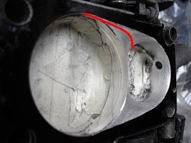

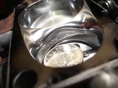

i sat the other half on and marked around where they met:

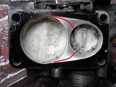

and here it is after a little work with the dremmel and a file,needs a bit more yet,red shows the curve ive got:

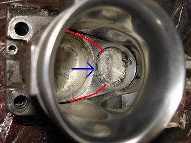

blue shows where ive started to knife edge the two ports:

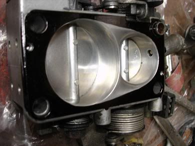

nearly finished,just need to find my autosol :?

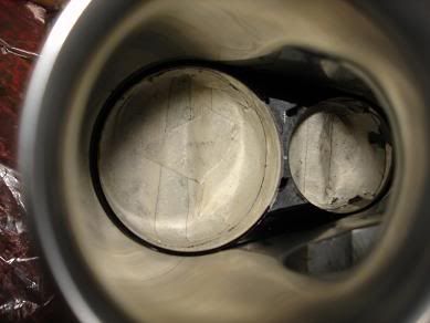

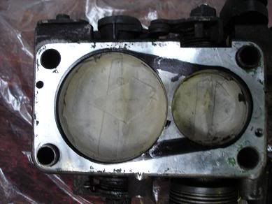

black marker pen to show the shape i got on it:

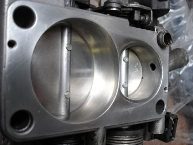

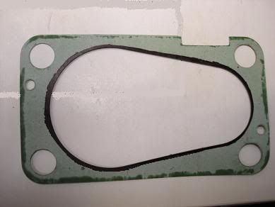

had to mark and cut the new gasket:

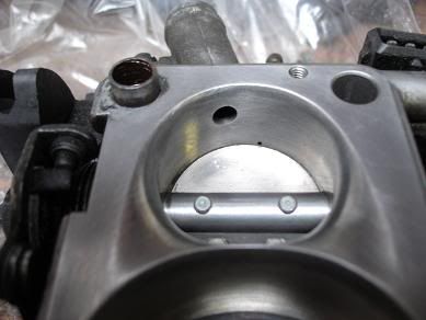

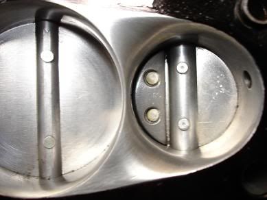

and fitted to the other half which i previously worked on,venturi end/material removed and polished and port matched:

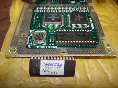

i removed the ecu and took out the superchip ready for the sns :D

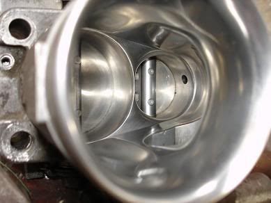

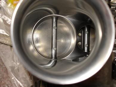

finished the t-body:

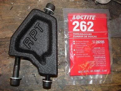

fitted a solid front engine mount:

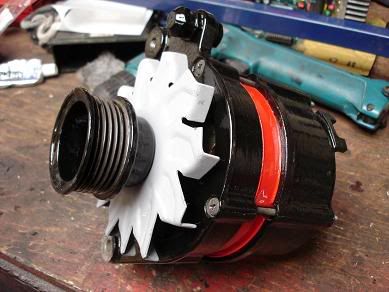

and did a rush job of painting the alternator:
