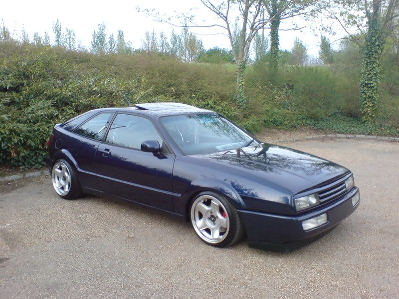

My 16v Corrado.. Featured in this months (Jan 2010) PVW!

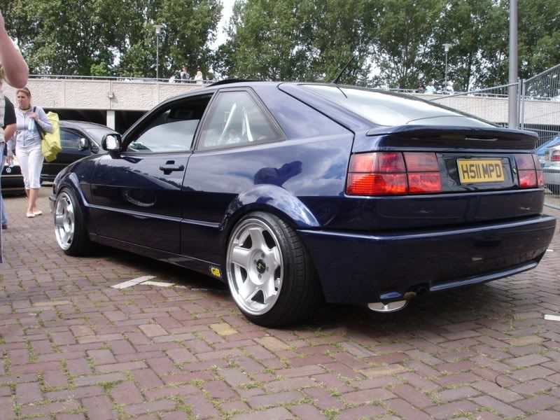

Bally as my bro says the silver centres deffo bring out the colour in your car for the better. Reminds me of wheni first saw your car parked in hounslow a few years ago when your rc's were silver, it has that fresh look back.
  Ravi B said:
dayymm they look cool...i done a phtoshop a while ago on mine...but they didnt look like they do in your pics!
respects paaji, you got some stretch goin on at the rear:p
i proper want to see your car in real life brv
:Bacardi:
Singh
Cheers bro.. Im at most of the meets.. mostly cov, but should be at the west london meet on monday all being well... 8)

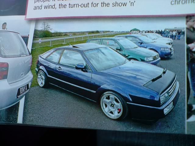

did i spy a sneaky pic in PVW this month!? or is there another one about thats same colour with the wheels aswell! lol :D
Yeah I spotted that in PVW this month.. thanks...

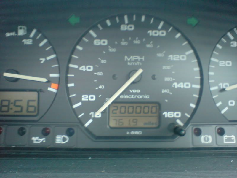

Thanks Mate, I did the 720 mile trip to MIVW in the valver.. just hit 200k aswell
Had the car fully detailed before MIVW I will add pics...
200k
