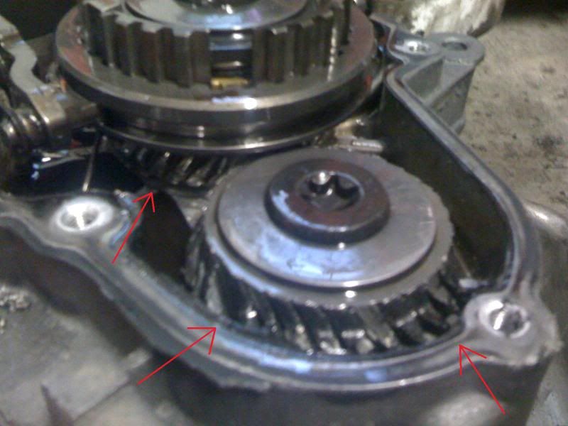

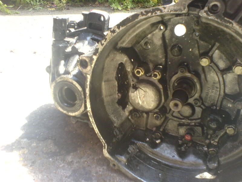

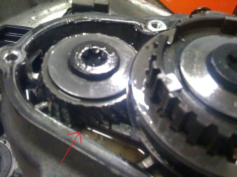

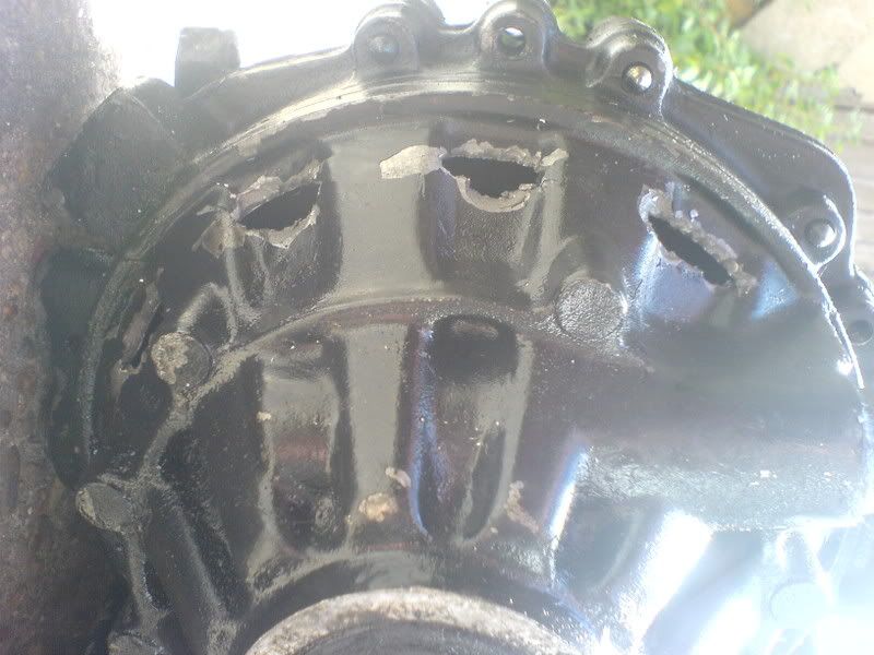

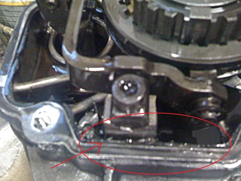

jamminvr6storm 0 Posted October 29, 2010 The first thing I have to say is I wish Iphones had better cameras LOL! :mad2: kevhaywire said: That's actually a handy gear to break if you're gonna break one as you can swap it out via the end plate usually, but I guess it depends on any other damage done? Yeah I can see your logic here Kev, unfortunately where it stripped so many teeth there was lots of swalf and chunks of metal in the casing, so this will require a full strip down. I think this was the first tooth to give way as its the worst damage on this cog This one shows the extent of the damage, more than one cog gave way kevhaywire said: If you're stripping 5th tickling the gas at motorway speeds, I'd say you need to look into slowing down the onset of boost somehow! I'm amazed the lower gears have survived this long with your torque!! LOL, Yep, I can do that with the Emerald as it controls the boost. I have a feeling the damage was done prior to that particular day, as I have raced Astons, Ferraris and even an SLR... all of these were in fitfh gear on motorways and were hard on/off the throttle. I think there was probably a stress fracture on one or two of the teeth and I was just unlucky that it let go when it did. Still I suppose being stuck on the M4 is less embarrasing then being towed off the quarter mile :lol: Quote Share this post Link to post Share on other sites
Kevin Bacon 5 Posted October 29, 2010 iPhone 4s have decentish cameras, so long as you keep it steady :D Yeah that's some tasty carnage alright mate!! If / when that happens to me, the 02A is going in the bin and my 02Q will take it's place :D You need a GT35 mate, the 30 comes in too quick and shreds gear teeth! Quote Share this post Link to post Share on other sites
