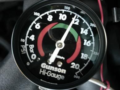

Riley 0 Posted January 15, 2008 Any response on the above? :) I got some video...You will have to excuse the lack of lighting on the boost gauge :oops: turning the volume up will help too. Video 1 - Showing ticking over from cold, and showing vac on mfa. http://uk.youtube.com/watch?v=uiYVXnAh0mA Video 2 - Just as i move away from the boost gauge you will hear the car sneeze...once,twice and a third time. http://uk.youtube.com/watch?v=rdGupfF1tI0 Video 3 - Showing it up on the boost gauge, 17 seconds in. Also around 27 seconds you may hear it rev differently? http://uk.youtube.com/watch?v=4CIXoC2djrg After this... I disconnected the bts and reconnected it to a cold one sat on the slam panel. The tickover rose and it seemed to rev more responsively,and no popping. I reconnected to the bts on the rad pipe, i revved it by hand and it popped. What we reckon? :) Neil. Quote Share this post Link to post Share on other sites
