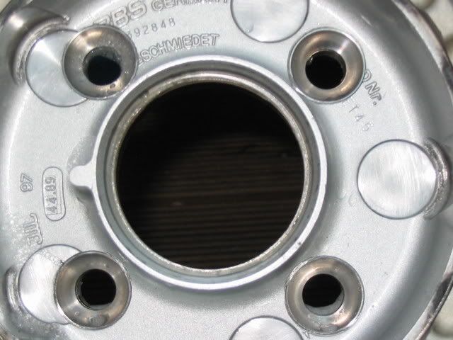

billinjah 0 Posted November 17, 2005 i dont think i can get mine redrilled as the backs arent flat. see below Quote Share this post Link to post Share on other sites
Andy T 0 Posted November 17, 2005 The back of my RS 114x5 stud are very similar to that, i'm still going to have them re-drilled though. Mine are 7J ET33, and 8J ET24. Take it you need 4 x 100? two of the holes can be placed close to the existing ones, I don't think it will make any real difference anyway as the casting is a rigid lump, its not going to flex when the bolts are tightened up. Just had a look at mine now, it might be best having a shallower radius seating for the new holes to compensate for the hub being thinner between the existing holes, of course slightly longer bolts would be needed to compensate, say 5mm longer, but would need to check if the back of the centre caps would foul on the bolt heads (looks ok but I will measure this.) There should be lots of engineering shops/precision toolmakers that can do this work, I am working on a cad drawing for it, let me know if you want a copy to suit yours. p.s. are yours definately ET25 from a porsche? porsche offsets are usually ET52- ET70. Quote Share this post Link to post Share on other sites
billinjah 0 Posted November 17, 2005 yeah mine are from a 944 so for some reason came out as et 24, if you could help in anyway ill be eternally grateful!! yes i need 4x100. i could have the hubs redrilled apparently but id rather have the wheels altered tbh. if you find somewhere to do it or are doing it yourself ill bring my wheels to you! Quote Share this post Link to post Share on other sites
billinjah 0 Posted November 18, 2005 looks like ive got it sorted, im gonna run the adapters on the front Need to to clear the brembos) as et 12 with a 7" rim is all good and on the back im having the hubs (disks) redrilled to 130 pcd and ill still be able to run the 4x100 winter wheels this'll give me et 24 so witha 8.5 " wheel ill be cool as far as i can work out! there told you id do it furks! Quote Share this post Link to post Share on other sites
