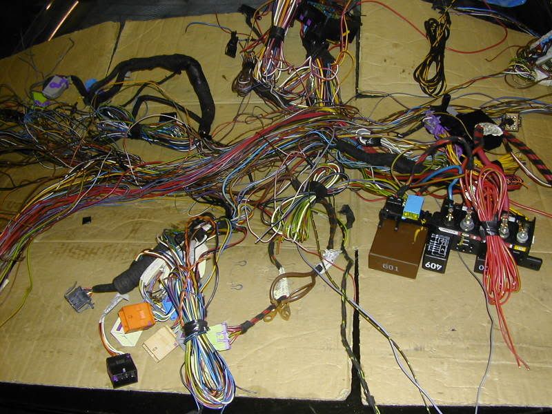

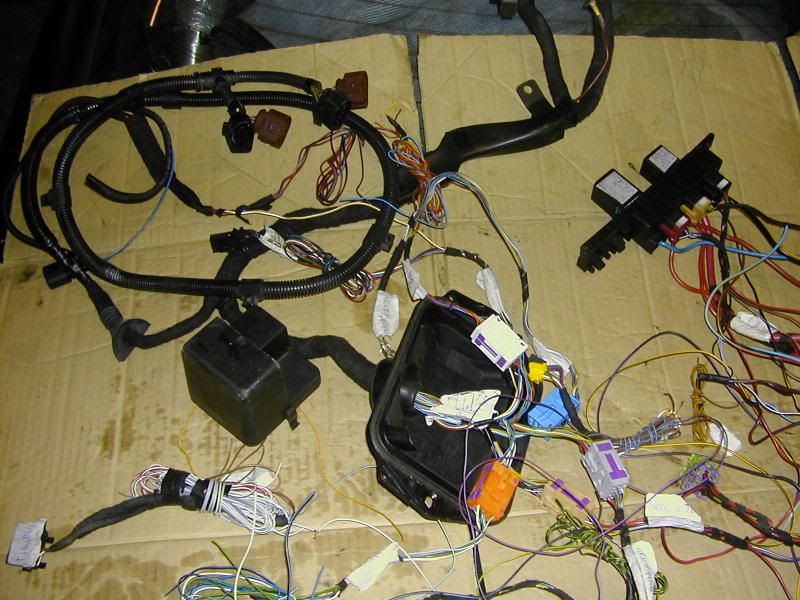

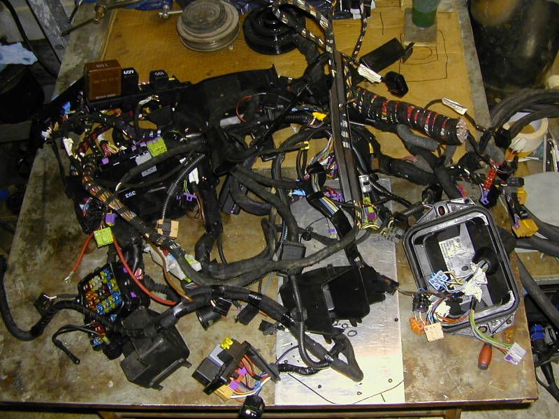

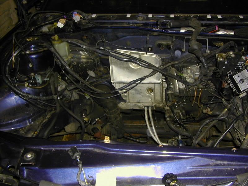

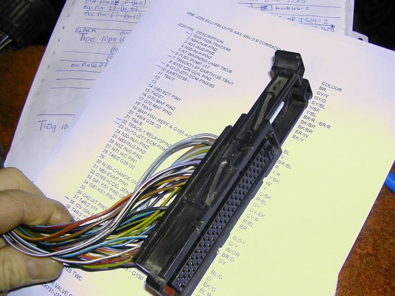

datajon 0 Posted January 25, 2008 seems to be a colour code variation from audi to vw engine loom, which can be misleading when supplied various wiring looms from audi & vw. :? stripped down the v24 loom, removing fuel pump relay with micro central electric shelf panel & wires, reduced bulk of surplice wiring & connectors, leaving only the 6 plen chamber onesT10 family, T6 ,T16 diag port,removed main fuse box etc leaving just tales. Onto vr6 C 12v engine wiring loom , ecu loom route is on right side, comes behind brake servo, probably means removing servo, is this the case, see how it goes. opened up original loom from servo to j220 plug, next step... working out whats stays, what can go,, any one got a list of this section, which leads me onto to bentley, it covers vr6 to 1994, some colour bands don't match up , would there be a better pdf of the wiring for late UK vr6 2.9 S. next stage hopefully over weekend, powering up V24 ecu with engine loom, hopefully getting response on vag com, whats the SP about reconfiguring motronic, for the removal of exhaust sensors etc , what am I to expect... any help in this area would be gratefully received.. couple of questions . why not use the 24v ecu pin 65 to trigger 12v J17 fuel pump relay as used on the vr6 rather than install the 24V 3.2l FP relay.? what's the story with 24v ecu pin 67 for crash, is it sensor input, or signal out ? Quote Share this post Link to post Share on other sites
KipVR 1 Posted January 25, 2008 Definately use the VR fuel relay if you can, especially if it means you don't need that relay plate. The less extra stuff the better. i really don't know the score on cofiguring the ECU, (turning off the ABS modules etc) anyone???? Cheers Jon. I'll do some more digging............. Quote Share this post Link to post Share on other sites

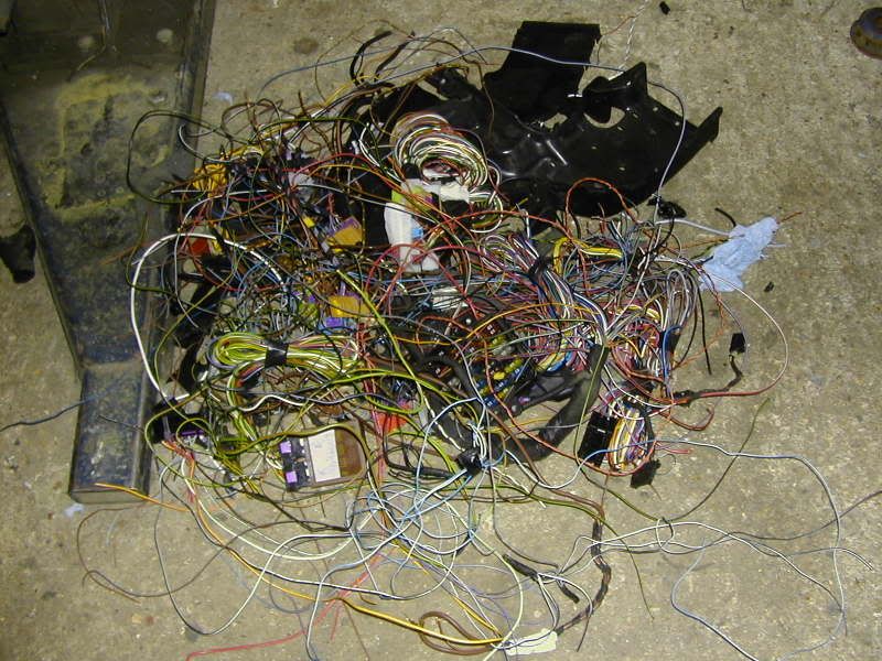

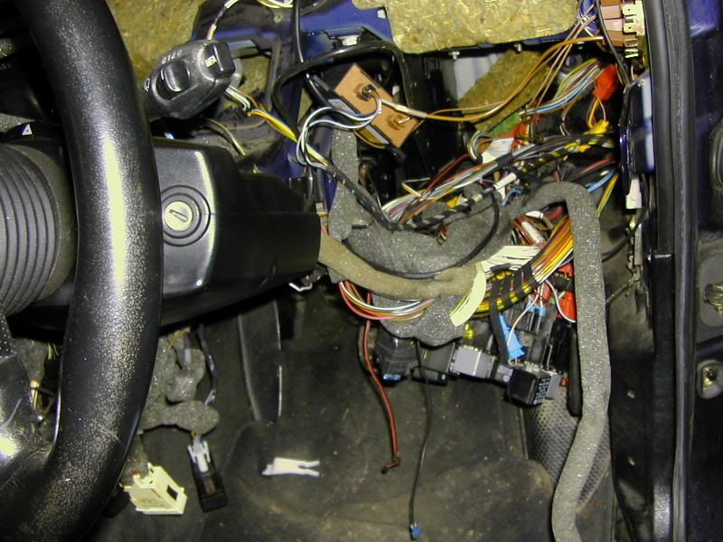

KipVR 1 Posted January 25, 2008 Do I have a plug (and wire!!!) missing on the left here????? Anyone Quote Share this post Link to post Share on other sites
datajon 0 Posted January 26, 2008 Hi Chris. Not sure about that missing plug , what about the missing ect, would the 12V be the same value as the 24V ECT sensor....?, as for the missing connector, will be able to ascertain what is what from the other half of engine loom & j220 motronic connector. Your wiring would suggest it had every gismo installed, quit a saving of weight. The v24 loom sure requires some amount of dissecting, started with . after hacking up loom, wires that hopefully won't be required ,not sure whether this is good or bad. 24v loom stripped ready for hacking up action. Sometime later T10 connectors , T6 brown ,diag port leads,with fuel pump relay & micro panel & a few other bits. VR6 C engine-less bay old 12Vloom , 24v loom dangled following route, brake system coming off. VR6 C loom un wrapped T68 & T42 connectors. 12v & 24v loom layouts almost all on paper, just some details over starting,alt wires, plug stuff , next stage start on the vr6 12v fusebox & dashboard hopefully get some direction going ready for connecting up stage. ANy help .......well received 4 sure. Quote Share this post Link to post Share on other sites
CoxyLaad 0 Posted January 26, 2008 that missing plug is for the the vacuum switch on the mk4 exhaust flap. the one next to it is for the variable inlet manifold Quote Share this post Link to post Share on other sites
KipVR 1 Posted January 27, 2008 Ahh nice one, the sensor is in there but no sign of a plug or any wiring going to it, wierd. I was wondering if I could get some exhaust flap action going on......Cheers Coxy Quote Share this post Link to post Share on other sites

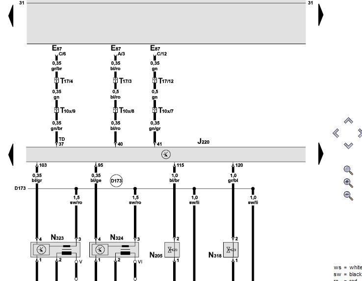

Andy947 0 Posted February 8, 2008 Snap, i've not got the throttle pedal plug either. Cant spot the part on ETKA either to go order one. I've got the right diagrams, got a copy of ELSA here, so can ull anything i need, 2002 BDE is my code. I've got the connector pins tabled so i can try and match it into the Golf fusebox (should be same as corrado) I've got a fair bit of space behing and around my fusebox as i run a MK3 golf dash in my MK2. Doesnt seem to be very man wires to actualy wire into the Car to get it running, Once you take out the blue throttle pedal plug and the orange air con connections, you're left with very little. Quote Share this post Link to post Share on other sites
KipVR 1 Posted February 8, 2008 so how are you planning to get round the rev counter bus signal? I'm thinking I have to get a bus to analogue converter, racelogic do one for 80 quid, but if you look at some of the early R32 wiring looms, there is a converter in the wiring loom before it gets to the clocks, which must be analogue too... Quote Share this post Link to post Share on other sites
Andy947 0 Posted February 9, 2008 Pin T121/37 (121 pin connector, pin 37) on the wiring diagrams is labebeld up as "revolution signal engine control unit" I was interpreting this as a direct rev counter driving signal. It goes through pin T10/9 (orange air con plenum connector) direct to the Instrument cluster. I was going to run this direct to the rev counter feed on my MK3 clocks. I have both VR6 and 16v clocks so can try both 4 and 6cyl setups. Quote Share this post Link to post Share on other sites
KipVR 1 Posted February 9, 2008 Well most on here have had some problems with the rev counter I think, perhaps it depends on year of engine etc, but hey, cross that bridge when we get to it eh! At least if it doesn't work plugged straight in it isn't too hard to fix... :lol: Quote Share this post Link to post Share on other sites
datajon 0 Posted February 10, 2008 Pin T121/37 (121 pin connector, pin 37) on the wiring diagrams is labeled up as "revolution signal engine control unit" thats strange as the 3.2 ltr 24v vw engine states t121 pin 37 green/brown T10/9 Climatronic control unit, nothing to do with rpm signal. all plugs wires for the 3.2l 24v engine have been identified, however there are 3 wires that i can not identify on the 2.9 storm, namely the 2 way yellow, and single way brown, probably something of nothing. just seems strange that those who have done the conversion don't offer any help..? Quote Share this post Link to post Share on other sites
Andy947 0 Posted February 10, 2008 Depends which set of wiring diagrams you look at. You should note that there is also a common 'speed signal' line in the car which is also output out of the ECU via the orange air con connector, to loom connector 'A27' I'm pretty confident that its an RPM signal the clocks could use. Quote Share this post Link to post Share on other sites

datajon 0 Posted February 10, 2008 j220 t121/54 bl/ws to a27 , is this not vehicle speed sensor ,engine speed sensor mention in manual g28 as the "engine speed sensor",( g40 hall sender, g163 hall sender2).. its a tad confusing, only way is to scope the out put and see. Quote Share this post Link to post Share on other sites
