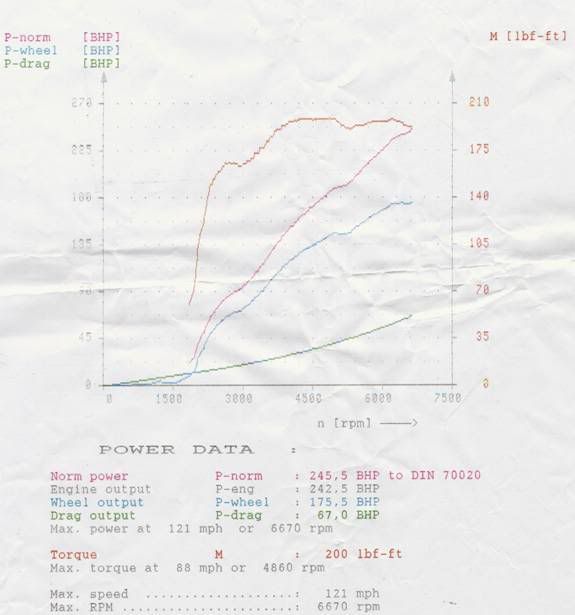

BigTartanJudge 0 Posted August 23, 2008 My figures were 245.5BHP and 200 ft-lbs torque at flywheel, at wheels was 175.5BHP and can't remember torque at wheels figure. Needless to say, I reckon the huge loss was down to the wheels and worn gearbox (wheels esp) I think. Am looking for 250+BHP and 220-230 ft-lbs torque when she is finished. I have vid of her doing these figs in the rollers and here is the RR print-out. Not bad for 65mm pulley and still standard bottom end. Quote Share this post Link to post Share on other sites
JMC 0 Posted August 24, 2008 Interesting BigTartanJudge, never seen the RR printout displayed like that. How's that drag line calculated then? I would have expected more at the wheels given your 'at the flywheel' value, but as you say, that could be down to choice of wheels and and old gearbox. Pretty impressive for standard bottom end. Mines a 1.9 but I am only running a 68mm pulley. The curves are interesting as well - what causes that bump around 2500rpm? Quote Share this post Link to post Share on other sites
BigTartanJudge 0 Posted August 24, 2008 Don't know about how they calculate the drag figure, and seem to remember they said the bump was due to the split duration cam, i.e. that was where the duration changed or where it "came on cam". The RR was done by reputable company up here in Scotland and their RR is fully digital and meant to be pretty accurate. Quote Share this post Link to post Share on other sites
