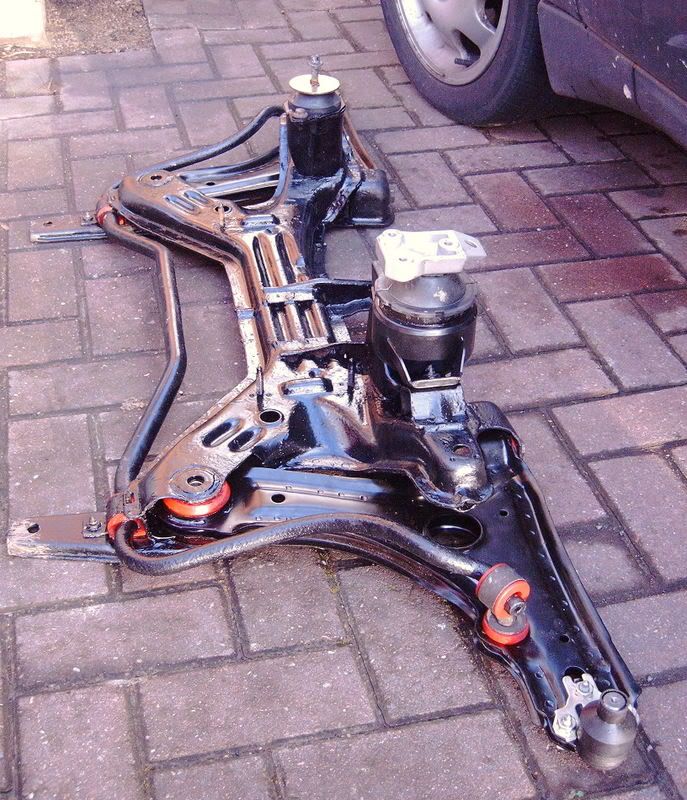

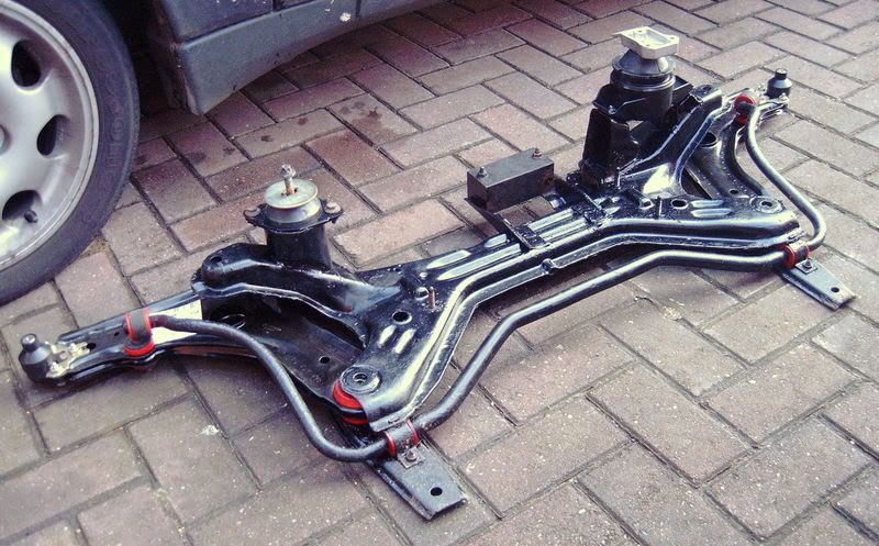

Dec 1 Posted March 2, 2007 Well as it has been pretty much raining non-stop here for the last week I decided to get some work on the car that I could do in the relative comfort of the garden shed! :lol: Fully degreased and stripped the rear subframe. Primed, and recoated. Fitted new wishbones + balljoints. Full Poly bush kit for the wishbones and anti-roll bar. New rear engine mount and gearbox mount. also stripped the front subframe while I was at it. Quote Share this post Link to post Share on other sites
blue95 0 Posted March 2, 2007 Looks 8) did you powder coat or hammerite Quote Share this post Link to post Share on other sites
Dec 1 Posted March 2, 2007 Its got two coats of primer and 4 coats of hammerite. Should hopefully keep it rust free for a few years anyway! Just need to get my hands on a set of 100mm 1.8T Beetle driveshaft flanges now and the new engine can be put into place! Quote Share this post Link to post Share on other sites
blue95 0 Posted March 3, 2007 Was going to powder coat some stuff but that looks damn good!!! Saves a few quid as well! How come you need 100mm beetle flanges?? are you using a different g/box? Quote Share this post Link to post Share on other sites

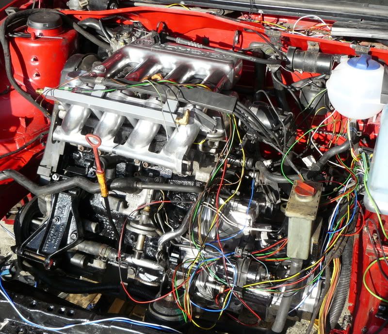

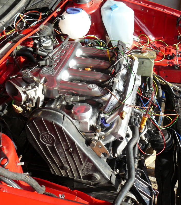

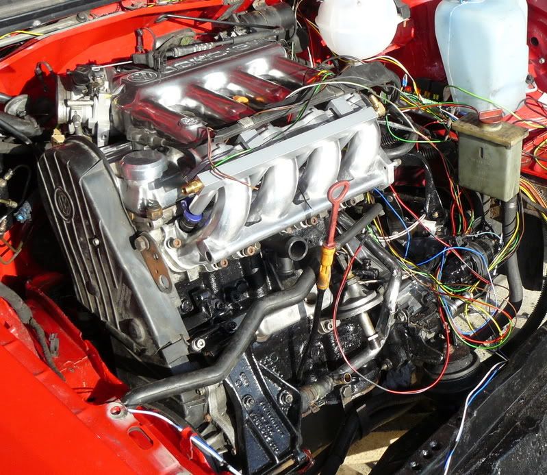

Dec 1 Posted April 17, 2007 Figure this is well overdue an update!! New engine is in the car, and I'm just finalising a new wiring loom for the megasquirt II. I've stripped all the subframes etc, and fitted new mounts. Mirror polished the new 02j gearbox, and fitted it with some new driveshaft flanges (even the dealer was shocked at how much they cost), lightweight billet steel flywheel and a Sachs VR6 clutch. Finished mirror polishing the manifolds and fitted in the new fuel rail + injectors + fpr. Just need something to fill this hole now...... Quote Share this post Link to post Share on other sites
blue95 0 Posted April 17, 2007 :shock: Sweet mama Jebus!! :lol: You have been busy man!!! Looking spot on Quote Share this post Link to post Share on other sites

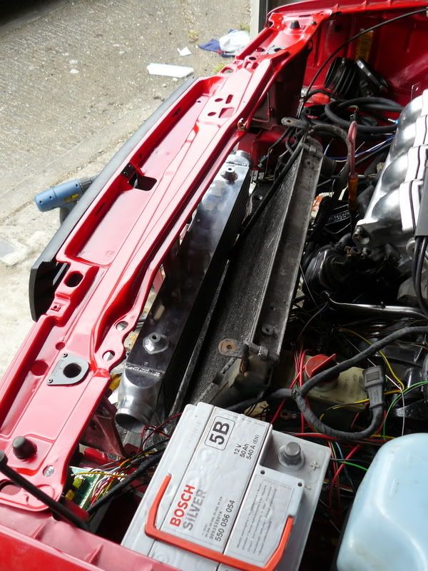

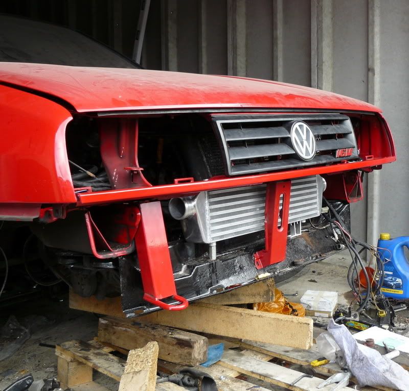

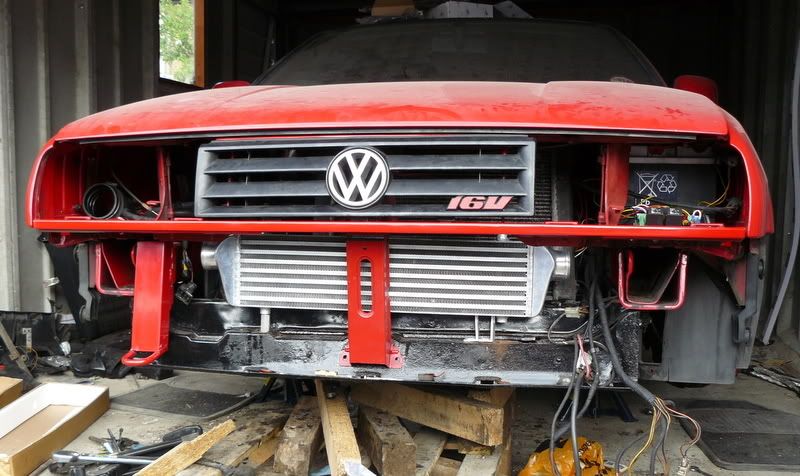

Dec 1 Posted April 24, 2007 Intercoolers in after a bit of "alteration" to the back of the slam panel with an angle grinder :D top surface and front edge of the slam panels also had a respray, and I've modified a late spec grille to fit, only test fitting it at the moment though. And clearance behind the IC....need to buy a new rad before bolting it all in! Quote Share this post Link to post Share on other sites
blue95 0 Posted April 25, 2007 Keep up the great work dude!!!! Looking forward to seeing the turbo bolted on! How the MS installation going? Quote Share this post Link to post Share on other sites

rado-steve 0 Posted April 25, 2007 Don't mean to Piss on your Bonfire, now you've bought them like, but Golf 110TDi Driveshaft flanges also work! Thats whats used on mine :) Nice Cooler too, is it a custom jobbbie? Quote Share this post Link to post Share on other sites
Dec 1 Posted April 25, 2007 Ah well, they are bought now....and I was having trouble sourcing any sort of d/s flanges, without having to buy a whole gearbox! Intercooler came from a company called uk_performance, it's not a custom made one...But after a day of head scratching with a measuring tape I figured out what size would neatly fit in there, and they supplied a decent one, that was the right size, and at the right price! Quote Share this post Link to post Share on other sites
