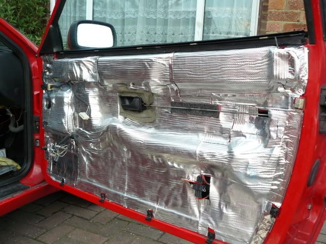

Drivers door with the O.E electric window kit fitted. I also retrofitted a side impact bar to each door. This is with the outer door skin covered in sound deadening:

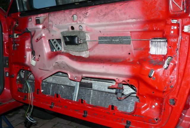

Inner side of the doors is also covered. (also acts as the waterproof membrane)

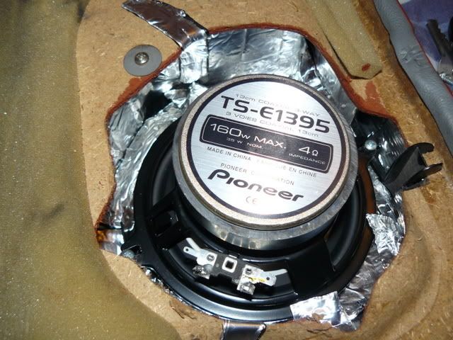

Speaker enclosures were done today, to try and stop the nasty VW plastic from vibrating so much!

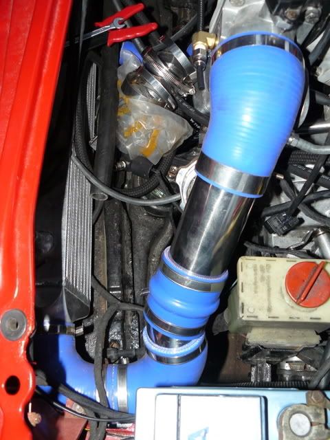

And I finally got the correct silicone couplers to get this tricky bit of inlet piping built. Had to get it around the radiator (removed in this pic), clear the pas reservoir, and up to the throttlebody. It took me a while to source the 2.25" -> 2.5" 90 deg adaptor for the IC and the 2.5" -> Vr6 throttlebody inlet piece. All in one piece now and the rad has been refitted and all filled with coolant.

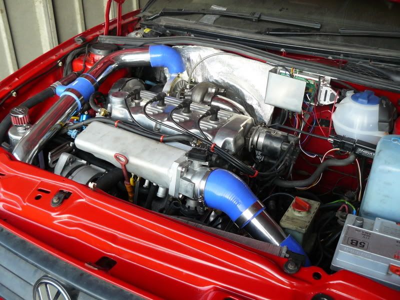

This is the engine a month or two ago. It has all the hoses and wires connected up now, and the silicone coolant hoses fitted!
Promise that next time I update will have the engine running. :razz:

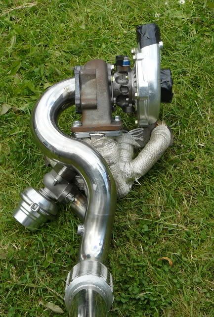

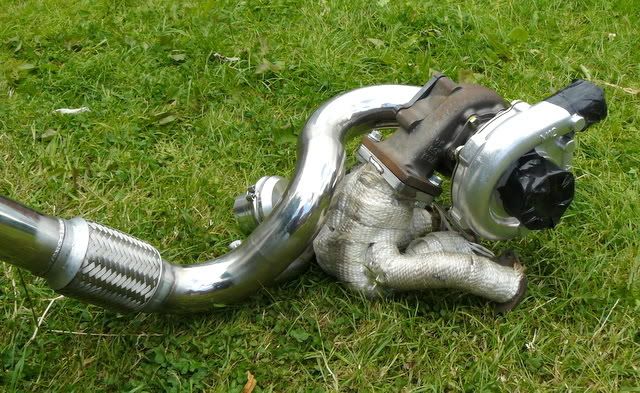

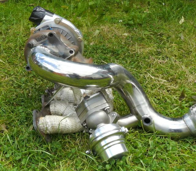

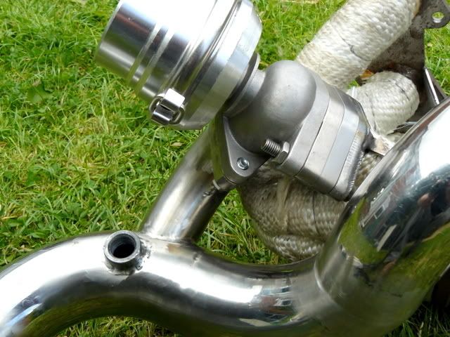

Skived off a conference I was supposed to be attending this afternoon to go and FINALLY pick up this bit of shiny pipe that has cost me SO much time and money! I fabricated all the pipework myself, and left it into the welders to actually get put together. Between one thing an another, it's been in and out of there for the last few weeks (my last mod to it was the external wg pipe linking to the main downpipe)
But it's finally back and looking pretty good! Everything all lines up perfectly and all the welds are pretty nice and have been polished out :cheers:
Just need to get the grinder out and trim a small bit off the straight end of the pipe, as I purposely made that slightly too long.

Did the wastegate/BOV thing clear ok? Looks like it sticks out a fair bit.
Ahh must have phrased that badly! It was the exhaust downpipe that needed a bit of grinder work, just on the very tip of it.
I had purposely made it slightly too long, so I needed to trim about 8cm off it. Then it was very tight trying to get it inside the orig exhaust. So I had to get the file out to get a good fit.
Subframe just needed to be dropped to get enough space to get the downpipe up into the engine bay. Not a pleasant job! :roll:
The wastegate fits just above the gearbox. It's a tight fit back there, but I spent ages making sure that it would fit before the downpipe got welded.

Where did you acquire the pipework?
I ordered a pair of 45 deg + 180 deg mandrel bent stainless steel pipe sections in the US about a year back. Cant remember offhand where I got them from though. (Will need to dig through the pile of receipts to find out.)
I then spent ages, cutting and measuring each section to get a pipe that fit down through the narrow gap behind the block. Didn't think it was going to be possible at one stage, but I managed to squeeze it in!
