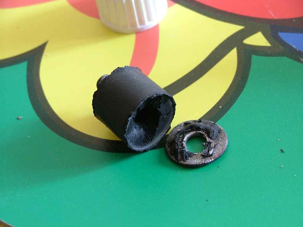

2_Door_fun 0 Posted June 6, 2006 Just removed my mech and motor. Well I'm not looking forward to putting that lot back in tomorrow :roll: Really the top section was a mare. Rest was easy enuff. get a big thing out a small hole.... :-P The motor has some rivet mounts on it. Do these need cleaning out to be used again. They have the remains of the rivets in em. Could you bolt the motor in place? Quote Share this post Link to post Share on other sites
carpy25 0 Posted June 6, 2006 what i did with the rubber mounts was unscrew them from the motor remove the washer with a little heat the remains of the pop rivets drop out then super glue the washers back on you should have six to play with so you can mess up 50 Quote Share this post Link to post Share on other sites

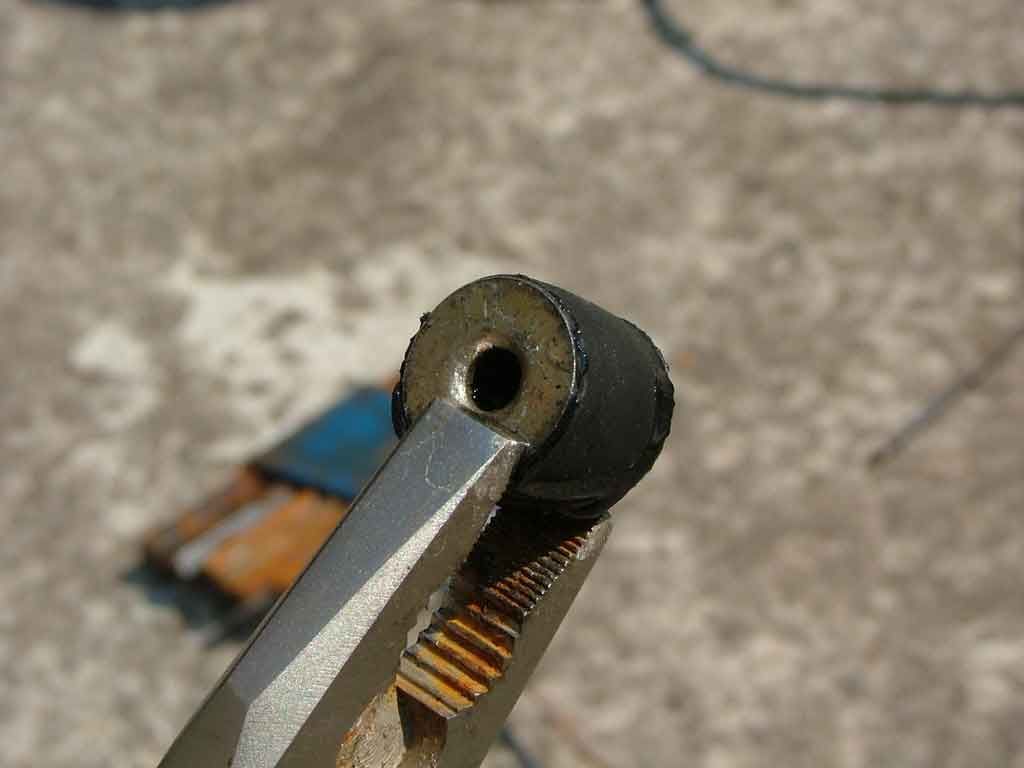

carpy25 0 Posted June 7, 2006 heated the first one up trying to drill it out as it got hot the washer lifted on the one edge a little so i got my nail under and it came off easly, i used the drill then to heat them up instead of drilling them out if you put the mounting in a vice or grips and get a drill bit a little smaller than the hole and use the edge of the drill to create heat it don't take much then use a blunt knife to pop the washers off Rob Quote Share this post Link to post Share on other sites

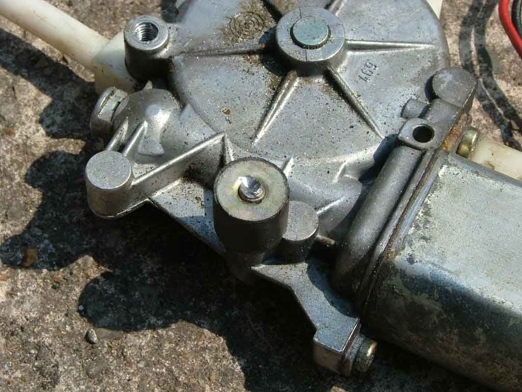

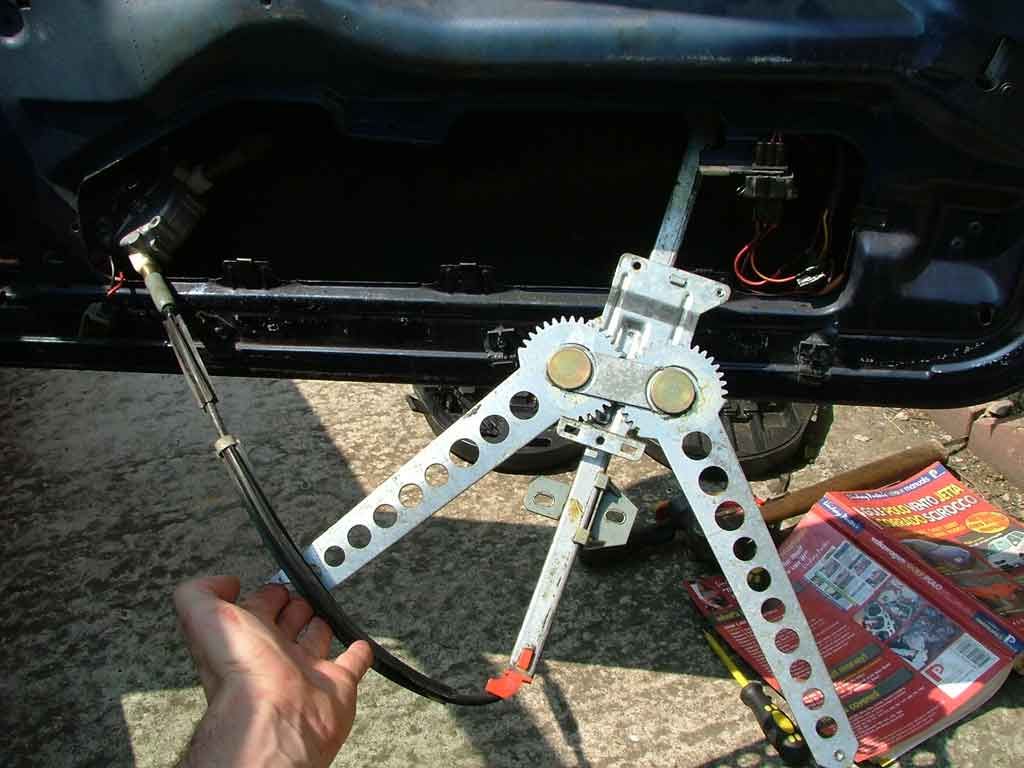

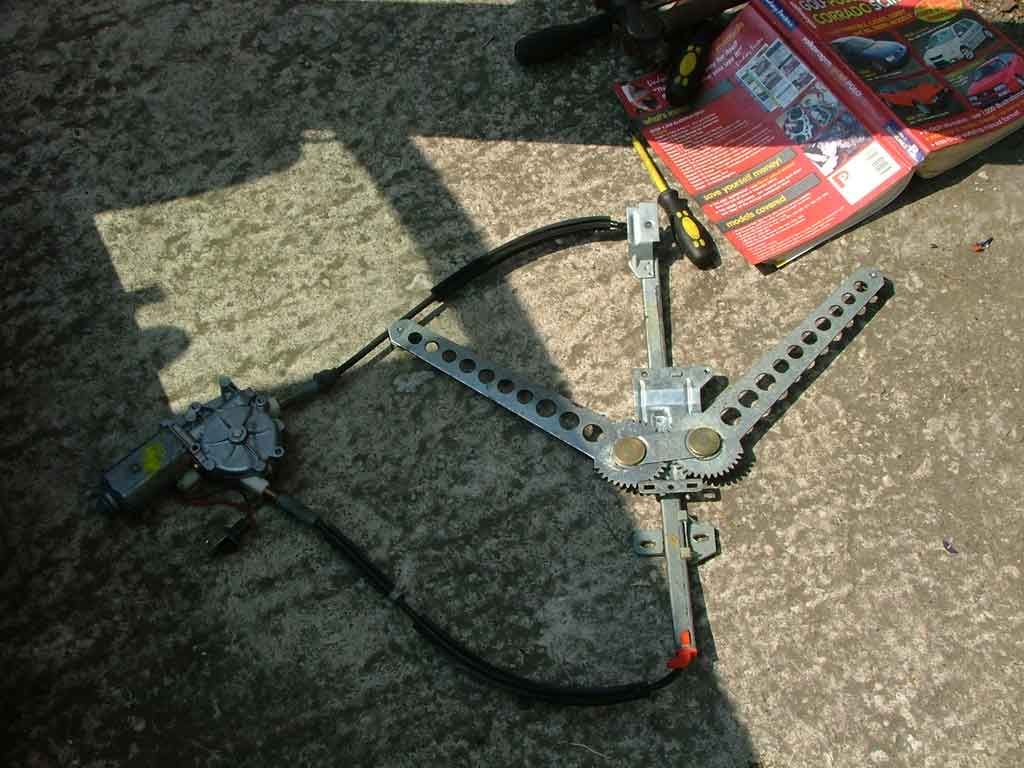

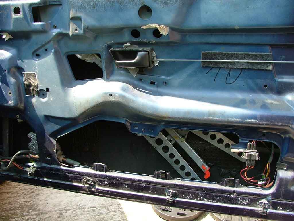

2_Door_fun 0 Posted June 7, 2006 Wow great minds think alike. That is what I did. Just span em off with a drill. Yes they do get hot :lol: Well job is done. Took me an hour. All in all very pleased. mechanisam went in a doddle really. I just need one more rivet for the top. My rivets were a bit shallow so get a pack of long ones for that. So elecy window I have again. Have photo's will post em later. Motor mountrs need clearing out of rivet body. Easily done. Place mount in vice and use a drill to spin the rubber washer of. Drop out rivet and use super glue to rebond. Cheers Carpy. Mounts seperated Once clear and rebonded they should look like this. New mechanisam being offered up. Mechanisam slipping into place. Slide all way to far end. Tilt and slide up. Making sure top armature is inside the window glass. ie closer to you and not behind glass. Pop the window arms in place. I just popped the glass rollers of the old mechanisam and then removed them from the runners. Replace these with your rollers from your new mechanisam. They may be worn to suit your new mechanisam. Don't want em popping off when you have all the door back together. Once all is in place. Hook central rod onto the clips in the door panel and pop rivet back into place. Do the motor last. Now lift the window and replace the two 10mm bolts that actually attach to the window. Connect button and admire handywork. Job done. Took me about and Hr to refit mech. Quote Share this post Link to post Share on other sites
