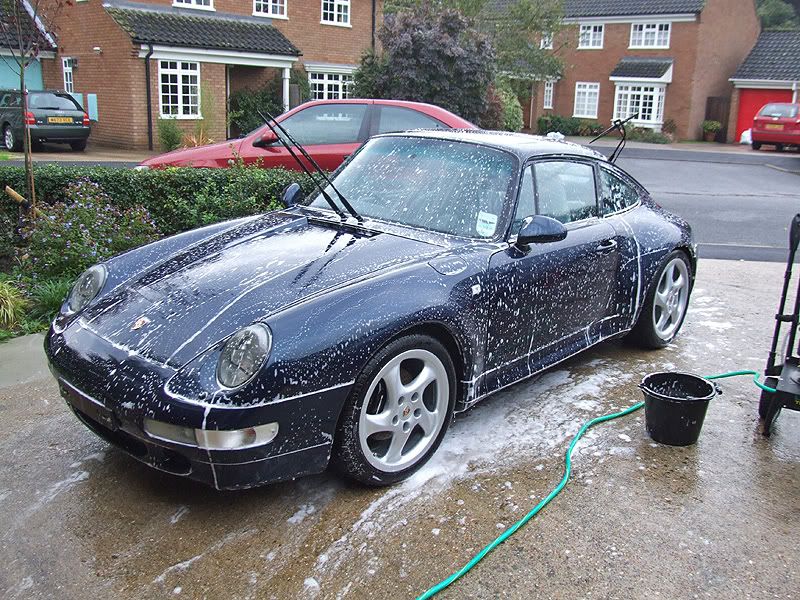

Started off as usual with a good wash down and then a clay which brought up small amounts of dirt on all panels. Looked lovely and silky afterwards. Just a washing pic for you though.

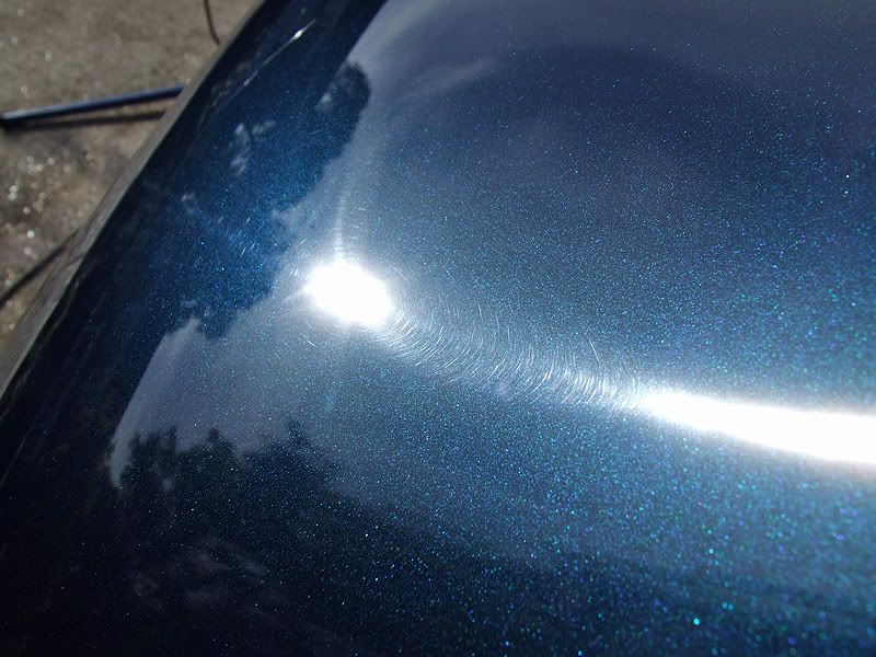

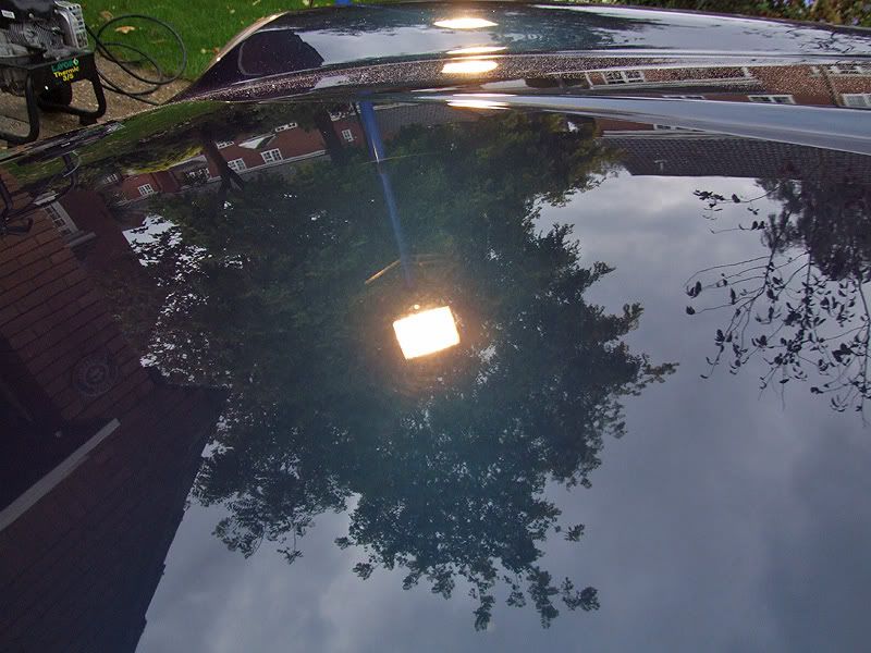

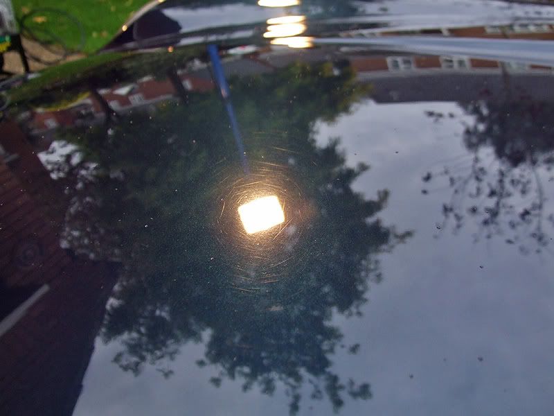

Then the fun started. Under the lights you can see i was fairly sucessfull with swirl removal on the bonnet..
Before
After
Upon closer inspection though (holding the lights much closer to paint... no pics as its a 2 handed job) there were loads of very very fine marks... not really swirls but linear marks.
I was using Menzerna PG followed by FF which has worked well on past details. So i went over the panel again with PG. Didnt budge the fine marks

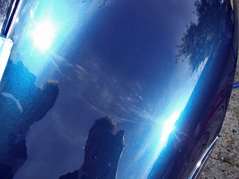

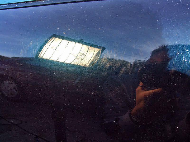

If you look at these pics you can see the very fine lines as well as some more before and afters... in some cases there was no difference in before and after even after 2 atempts with PG which would have atleast shifted some of the marks as its so harsh and well renouned for being and excellent defect remover.
Fine lines in R/O/S wing after alot of polishing. PTG still reads 250ish. and no there not holograms. i had also gone over this panel twice with FF Finishing polish.
N/S door before
N/S door after (didnt get a pic in sun but hundreds of fine lines runing front to back still after PG and FF twice)
R/N/S wing after PG and FF (i was getting very disheartend at this point as it seemed no defects were coming out even with what i would consider extreme polishing.)

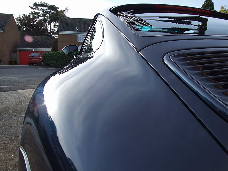

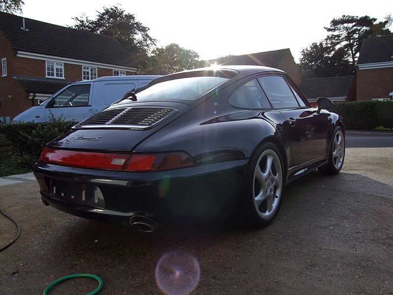

Final pics from today...
At least it looked lovely in low light

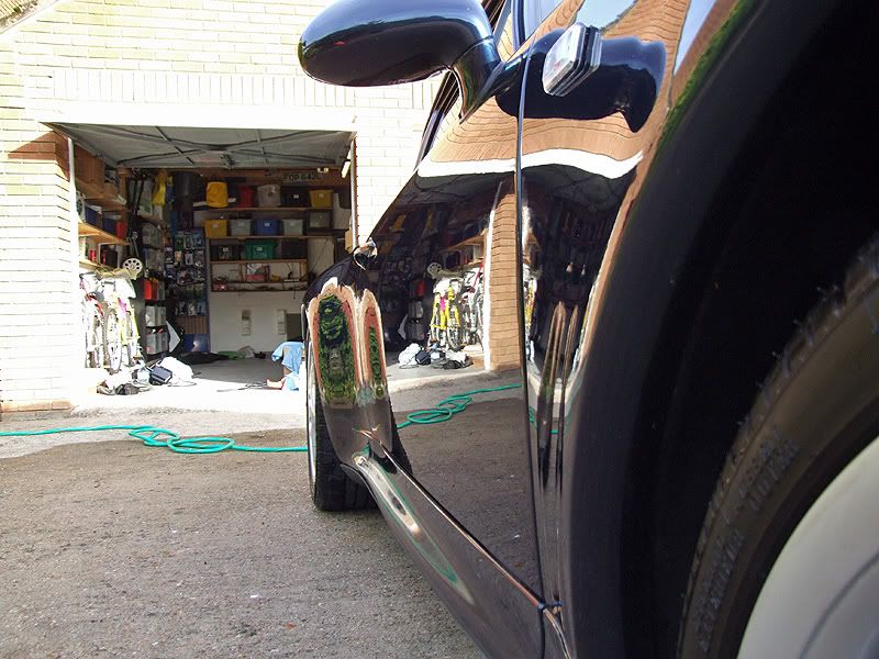

And the results....
The one of me is a reflection in the bonet.

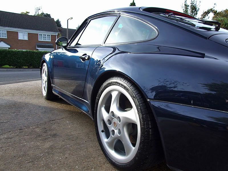

After shots....
So. I thought it was looking pretty damn good to be honest.
