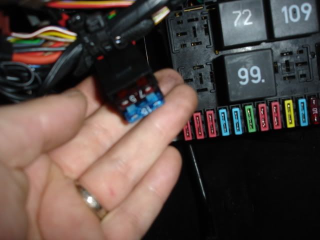

godskitchen 0 Posted March 12, 2007 Is there any chance someone could tell me what fuses are used in this alarm, not the main alarm (mine is by glove box) but the bit with the other fuses, it has space for 3 fuses and i have lost mine, and cant remember what they were!! Could someone have a look for me...............pretty please! Quote Share this post Link to post Share on other sites

timmaaah 0 Posted March 29, 2007 Where abouts do you want me to look buddy? Quote Share this post Link to post Share on other sites
godskitchen 0 Posted March 29, 2007 On the drivers side, with the fuses, there is a little block (pictured) it will have 3 fuses in it, it may be tucked up somewhere, hidden from view but wont be secured. you have to take off a small bit of the dash to get to the fuses, no biggie though. Thanks a million for this! Quote Share this post Link to post Share on other sites
timmaaah 0 Posted March 29, 2007 Your setup is different to mine. When I pull these two fuses - no alrm, When I out them back - alarm. You've got three on yours - does your alarm 'chirp' when you set it? If it does, you've got the siren backup (which I haven't), which is probably what your third fuse is all about. Sorry about the poor pic, but the fuses are 7.5 and 15 amps. Hope this helps a bit - Timmaaah Quote Share this post Link to post Share on other sites
godskitchen 0 Posted March 29, 2007 When i press the "arm" button it does "chirp" yes, i think thats what you were asking............i do remember there being two fuses the same in the "Block" so now its just a case of working it out. Thanks for the help you have done me a big favor! Quote Share this post Link to post Share on other sites
