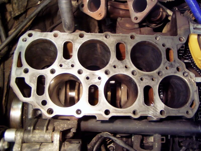

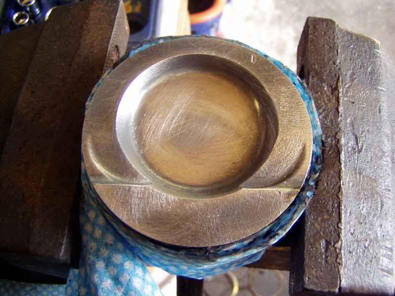

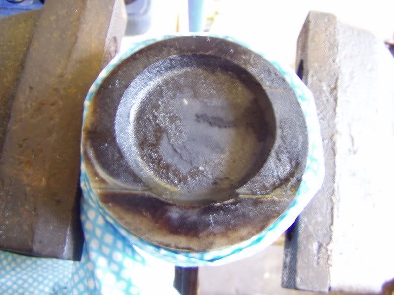

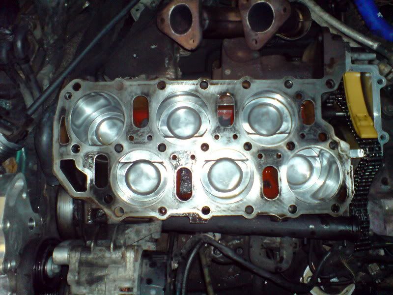

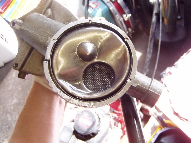

ziderapple 0 Posted July 30, 2007 Nice one Chris! You do like to get stuck in :lol: Should be good for a bit more boost when you're back together! No point being a fanny about these things!! :lol: More boost is the plan, although I've never really experienced the true performance of this set up due to the map not being spot on. Few updates, bad news today found a couple of cracks in my oil pump and also plate on the pick up is stoved in, guessing someone drove over a boulder at some point - I know the car had a new sump on it when I bought it.. All the bores are now honed out, pistons cleaned, ready to bolt up, will try to finish this week in the evenings, but I'm in real hurry, but its now a month since I have driven it!! Pic of the worst piston After Block cleaned, bores cross-hatched and ready to go Quote Share this post Link to post Share on other sites

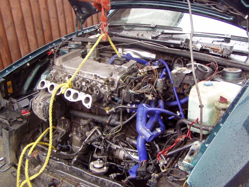

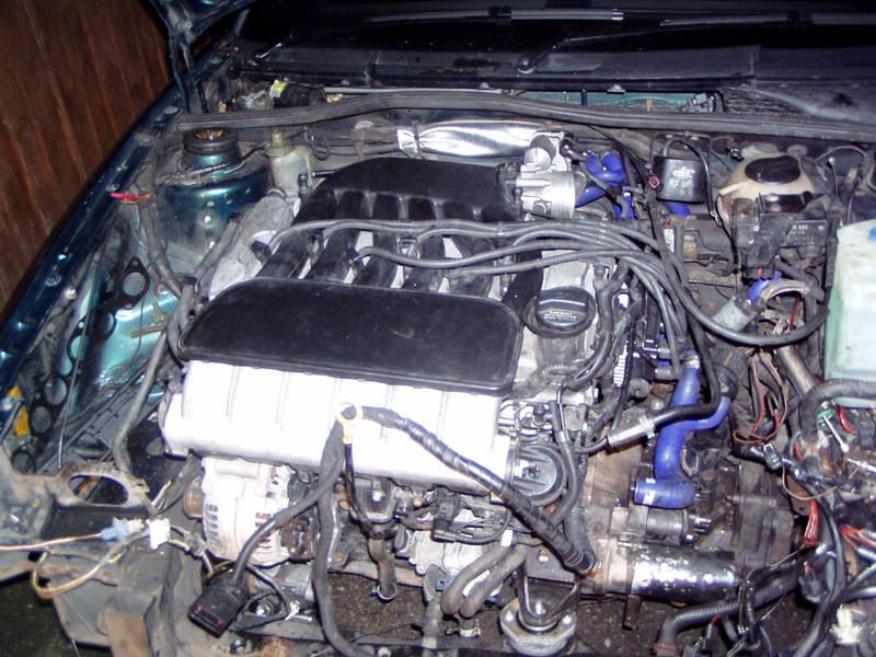

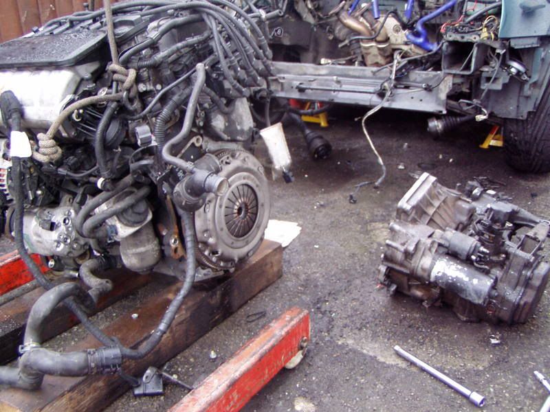

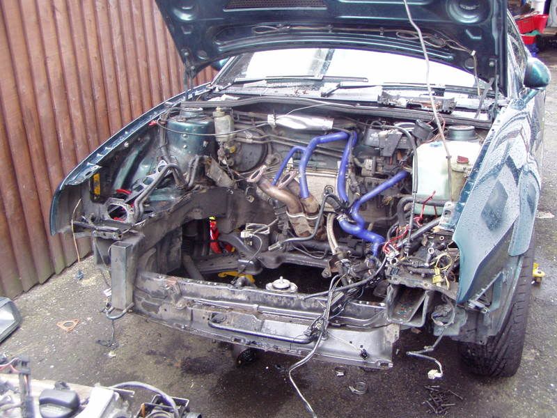

ziderapple 0 Posted March 24, 2008 Sounds good Chris! What sort of power would you be expecting with the charger? I'm afriad the charger had to go... :( Think a turbo might find its way on to the new lump at some point though. will you be doing everything yourself chris? will be good to see another one of these go through the motions! All of it bar the wiring. Got a chap lined up to do it all who really knows his stuff, and is sorting the ECU out for me. Getting the downpipe fabricated up by a place in Bristol. Depending on how much time I get this week I'm hoping to have it back on the road in two weeks time. :D I started today at 11 after picking up an engine hoist, manged to get the new block in by by about half seven, kept having to stop due to the rain. Not that bad really, worst job by a mile was getting the three bolts out of the exhaust flange where the downpipe bolts onto the cat, had to hacksaw all three bolts out, with barely any room lying under the car in the wet and dark. Everything else was easy in comparison. Need to get driveshafts bolted up, water hoses done then its off to have downpipe and wiring done! Pic's of todays fun: Original flywheel, clucth and gearbox going on to 24v lump And in!! Quote Share this post Link to post Share on other sites
