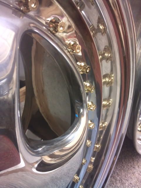

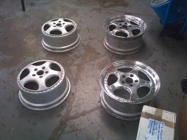

Hoping to have the RH wheels done in a week or so, here's a bit of the progress update...

Back off holiday and still on the look out for a run around car, in the mean time all four RH's are bolted together and just need sealing before fitting tyres on.

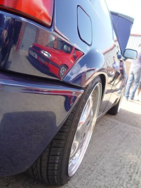

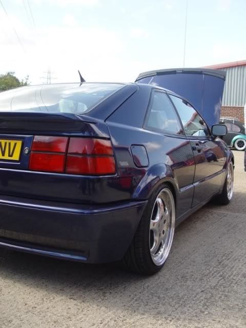

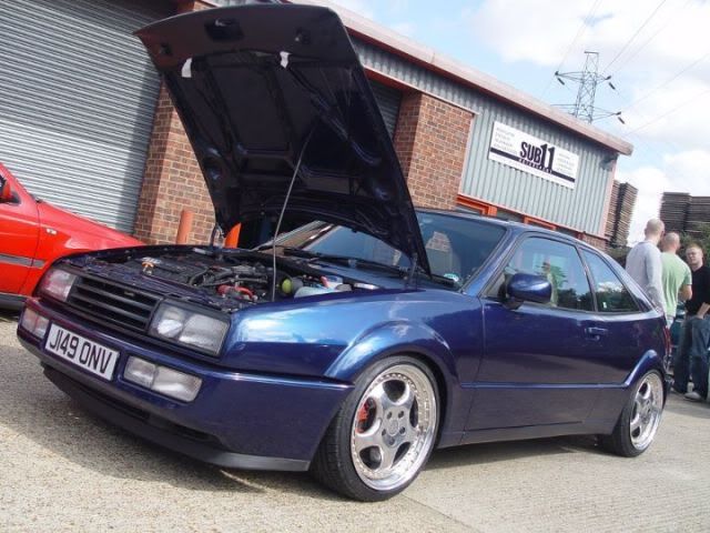

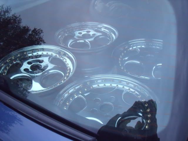

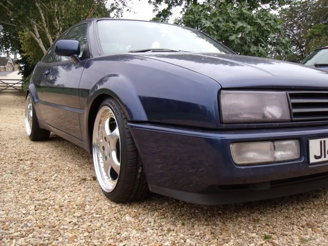

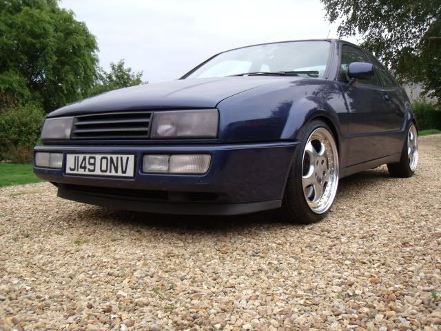

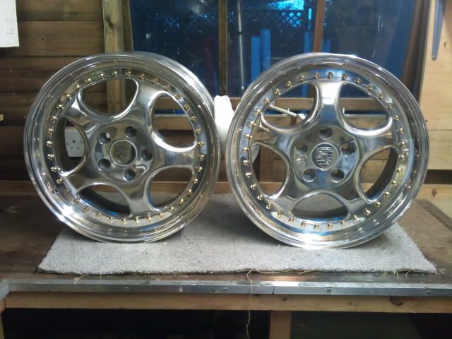

Well, it's been over a year since having the RH wheels delivered and I finally pulled my finger out and got them sorted (stripped, polished, re-built etc).
Here they are on the way to get rubber fitted..
and here they are fitted to a very dirty Corrado that needs a good clean, polish and wax.
Were a pain in the ar5e to sort out and cost me an arm and a leg but am dead happy with the results. Just need to play around with the offset.

Damn it! you beat me to it! LOL look very cool mate!
Need to pull my finger out and get some rubber and get mine fitted......
What widths did you go for in the end?
Ha ha, went 8's all round but I reckon I could get away with 9's but would need to drive a bit more to confirm. I have the 16v rear trailing arm so have more space than the vr's out there.
I'm happy with the current setup esp that I have a bit of freedom to play with the offsets. Need to be careful with wheel width due to the planned awd.
Top result is that the wheels appear to also fit the audi!! yipee!

Look like they fit really well! Take it there et35?
What tyres are you running?
I was planning on 205/40/17 tread all round.
Front 8x17 with 10mm spacers so et25
Rear 8.5 17 with 30mm spacers so et-2 (i think!)
I'm et40 (20mm spacer) and et35 (25mm spacer) iirc, but need to confirm as its been a while since I measured up. I may even be on 8.5 wide wheels (what are they standard?), my memory is failing lol
Using 205/40/17 tyres.
standard dishes are 8", if your dishes are 8.5" with a 20mm/25mm spacer that would make them et33/et28
