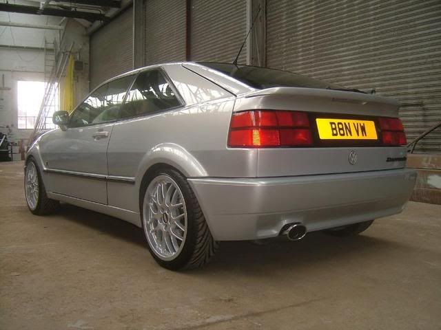

Sweeeet ! Keeping the standard look with subtle changes, looks perfect.
What suspension are you running and whats the ride like ? height looks just right.
It has FK Konigsport at the moment and the ride is very good. Im going to raise it a little when the works done as the fronts do catch under hard cornering. If your thinking of getting coilovers id recommend KW V1 or V2. I had a set on my old Golf and they were brilliant.

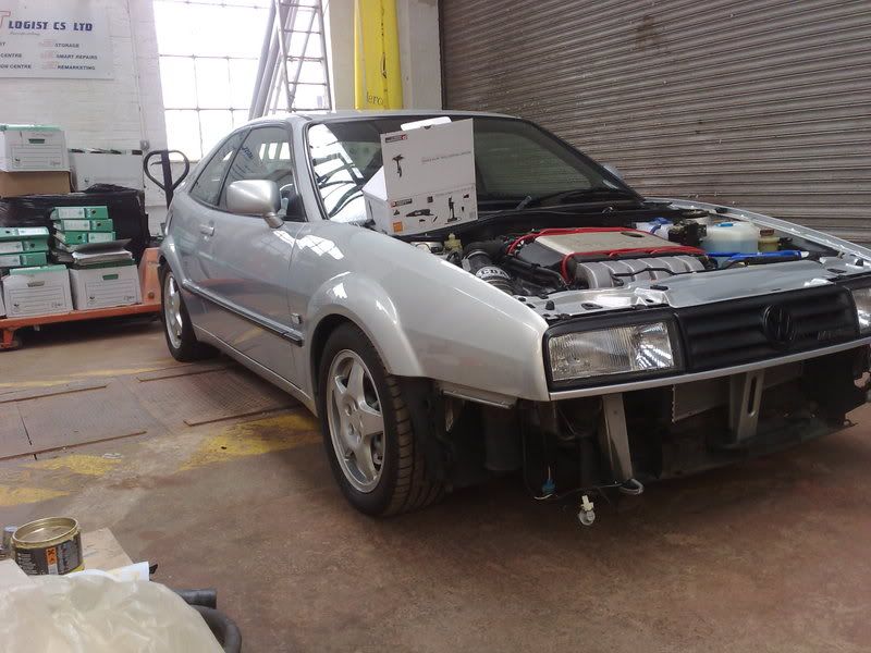

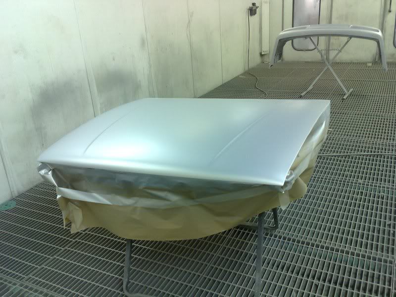

Have a few more updates today.

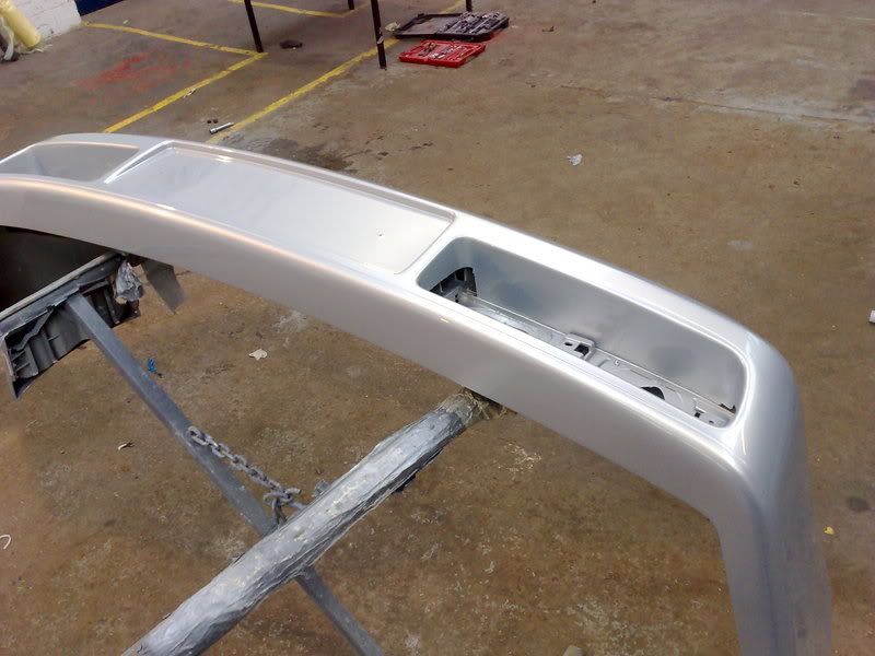

In the booth coloured up but awaiting lacquer.
Front bumper finished.

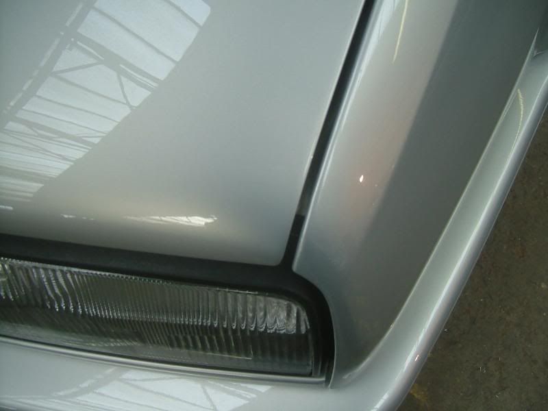

Bonnet finished.
Back on the Speedlines while I clean the RX's up properly.

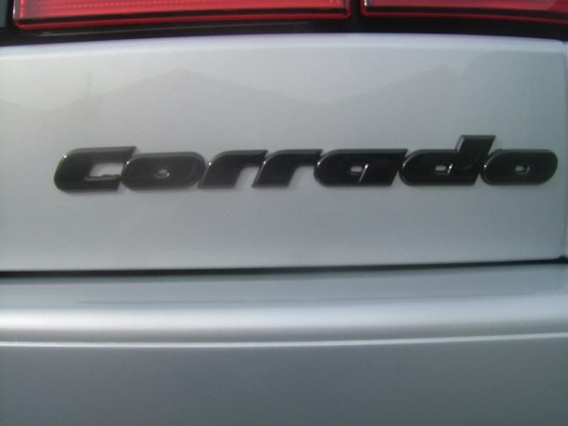

Painted the rear badge gloss black so it stands out a bit more.
Just need to fit it all back together and polish the newly painted panels. I will also be giving the car a full detail including wet sanding any panels to remove small imperfections. When all thats done our PDR guy owes me a favour so hes removing any minor dents. The MOT is due at the beginning of March and im hoping to get all the front suspension bushes, ball joints, drop links, engine/box mounts renewed when the car goes in for a new steering rack.
Looking good, when spraying the bonnet and bumper do you not need to blend in to the wings or is the colour match good? I've heard silvers a difficult colour to match up.
Yeah some colours do need blending.
I did spray test cards to every shade variant of satin silver and chose the best match to the wings.

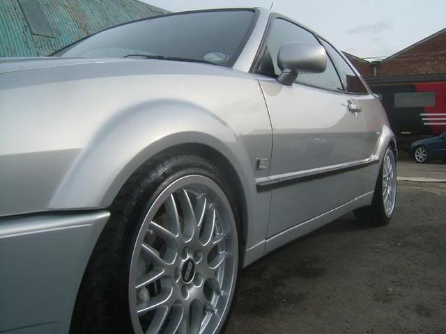

The paintwork and detailing is now complete. I have been finishing it for the last few days in between work. The car has been machine polished with Menzerna intensive and final finish polish. It was sealed with Blackfire wet diamond and waxed with Blackfire midnight sun ivory carnauba paste. The only job left is the removal of small dents by our pdr guy but that has to wait a few weeks until he is back.
New paint on bonnet with good colour match to wings.
Nearside with the sun bringing out the shine from the wax.

Gloss black badge.
