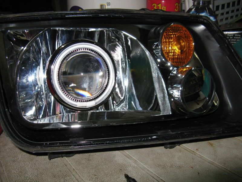

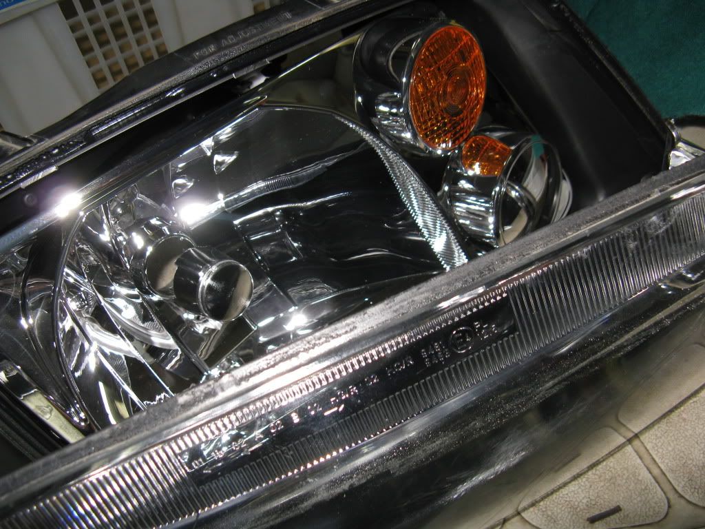

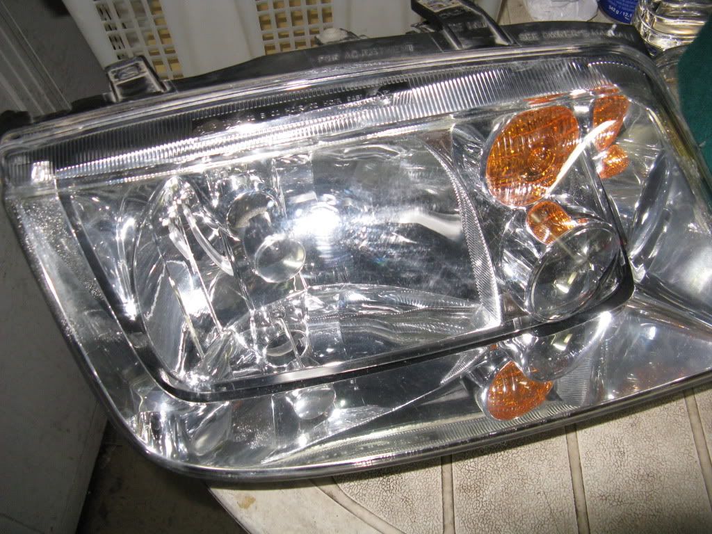

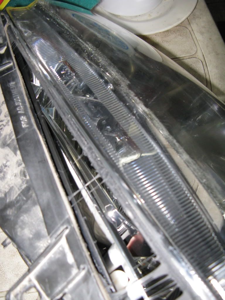

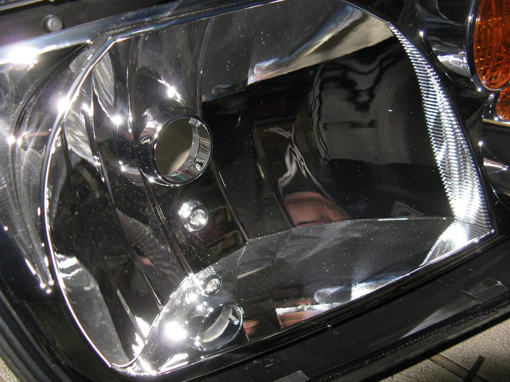

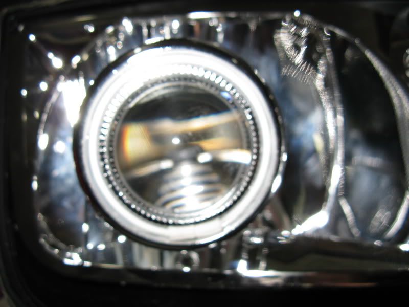

corradog60stage4 0 Posted December 6, 2009 hid or nothing. you can retrofit these like i'm doing to these MK4 jetta headlights http://i220.photobucket.com/albums/dd129/scirocco16valve/jetta%20retrofit/IMG_3036.jpg http://i220.photobucket.com/albums/dd129/scirocco16valve/jetta%20retrofit/IMG_3024.jpg http://i220.photobucket.com/albums/dd129/scirocco16valve/jetta%20retrofit/IMG_3025-2.jpg http://i220.photobucket.com/albums/dd129/scirocco16valve/jetta%20retrofit/IMG_3025-1.jpg http://i220.photobucket.com/albums/dd129/scirocco16valve/jetta%20retrofit/IMG_3026.jpg http://i220.photobucket.com/albums/dd129/scirocco16valve/jetta%20retrofit/IMG_3025-2.jpg http://img.photobucket.com/albums/v233/scirocco16v/IMG_3061.jpg http://img.photobucket.com/albums/v233/scirocco16v/IMG_3060.jpg Quote Share this post Link to post Share on other sites
