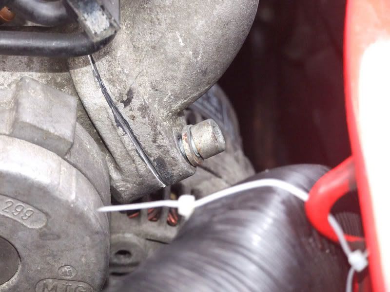

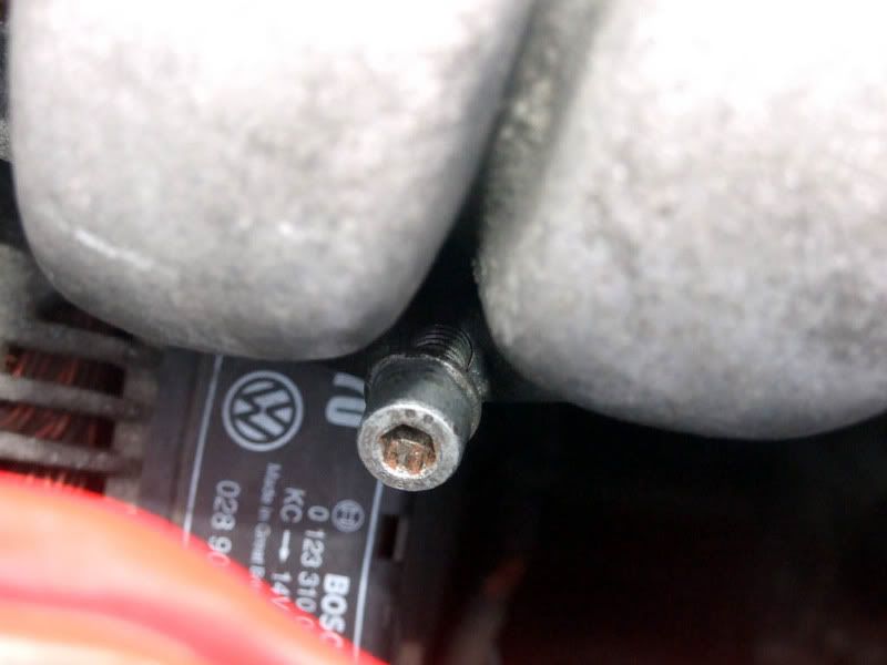

One thing that concerned me, when looking under the bonnet to check for the oil leak, after just getting it back from the head rebuild, i saw these little fella's were all completely loose!!
All three of the bolts along the bottem of the inlet manifold were not done up.... Suprised it even ran!
Blimey! :shock: Noticed any improvement since tightening them up? Just get the sensors direct from VAG. Ford may do them too, and if they do, they'll be cheaper ;)
