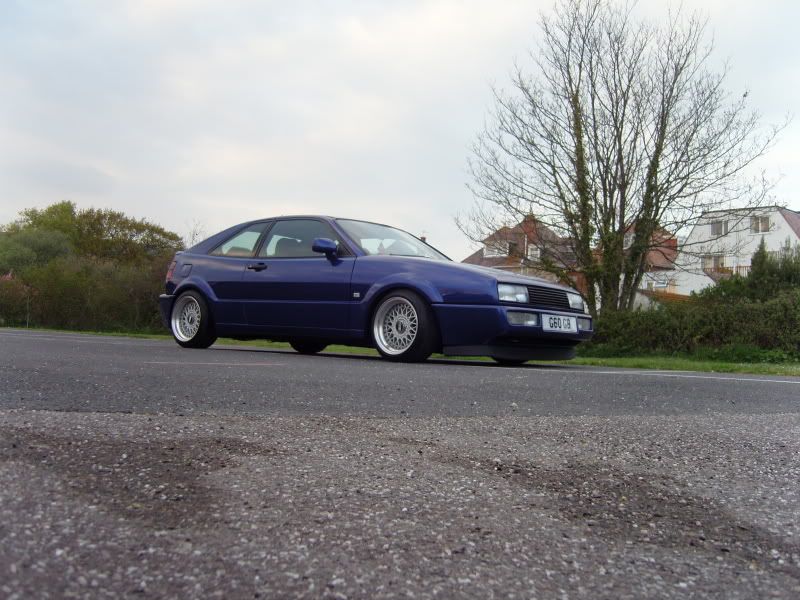

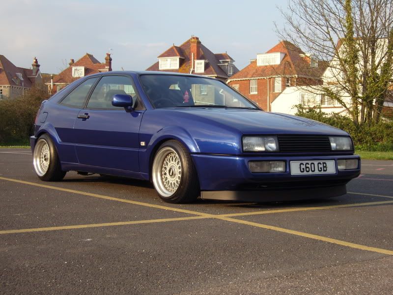

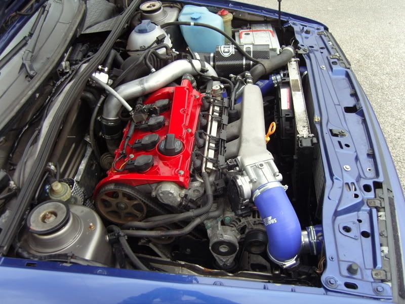

foster 0 Posted February 6, 2009 The finished article! Quote Share this post Link to post Share on other sites

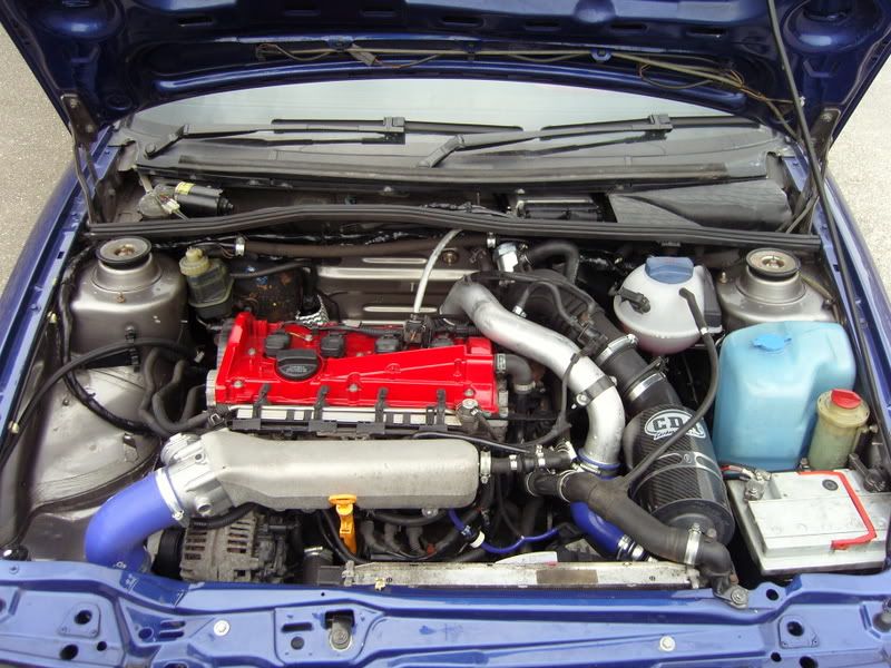

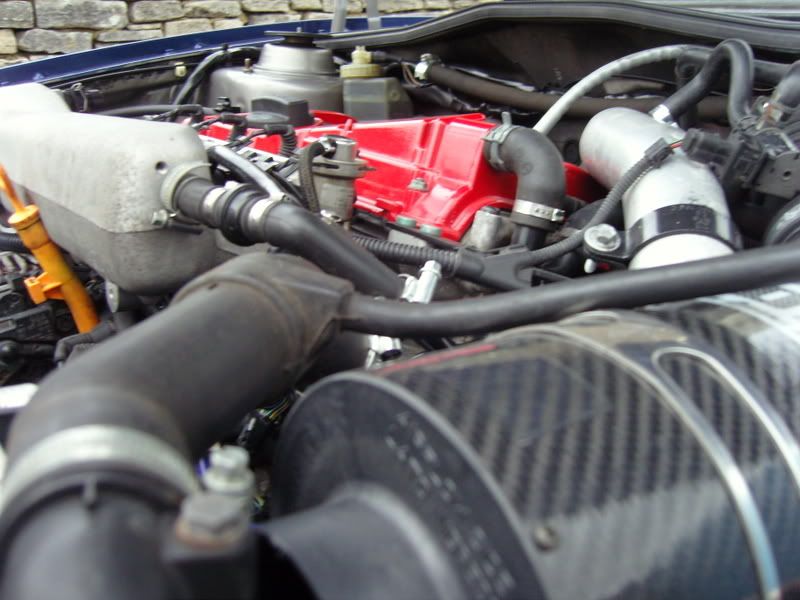

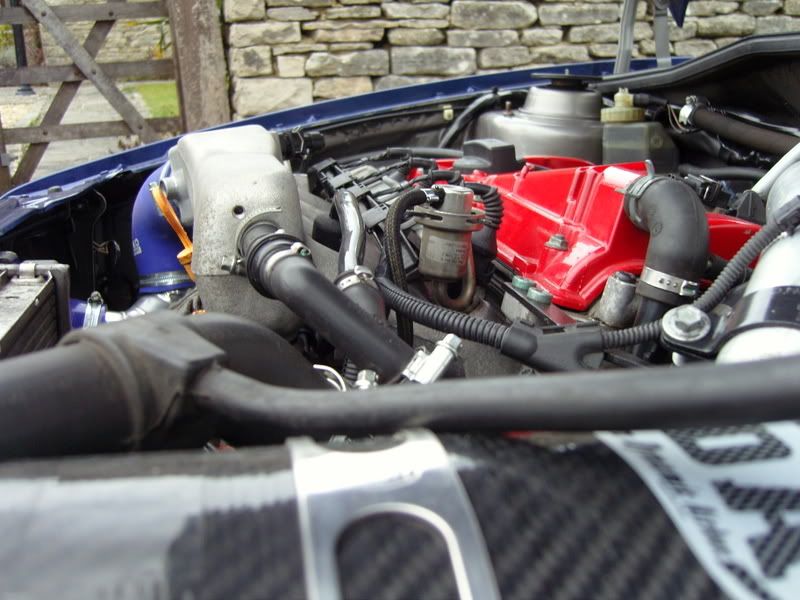

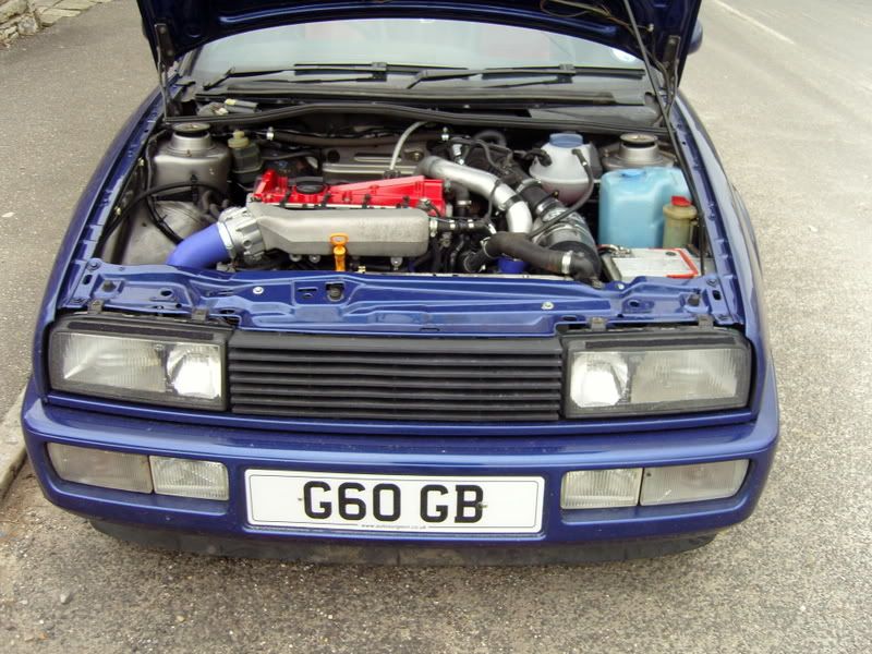

foster 0 Posted February 6, 2009 It drives like a new car, more power than the TT I drove but with the sweet handling of the rado. They remapped the car for me in Bristol and its absolutely brilliant so smooth and driveable with a serious kick in the ass when you give it some beans. Gonna put it on the rollers soon to see what its making. The spec. Ibiza cupra apx 20vt engine k03s turbo Forge intercooler BMC CDA Forge 007p diverter valve New Clutch Spal slimline fan FK konigsport coilovers BBS RM'S 15x8.5 Toyo Proxes (cheaper ones that suck in the wet!) Magnex 2.0 16v exhaust I've only had it back a week but it failed the MOT (no suprise, it has no handbrake as the rear calipers were seized!) so its in my local garage having mk4 golf rear calipers and a few other little MOT jobs. On the to do list is maybe some 16 or 17 inch wheels to raise the sump up a bit, dye the seats tan, sell the numberplate, ibiza cupra front brakes. Let me know what you think. Quote Share this post Link to post Share on other sites
waynos 0 Posted February 7, 2009 i suppose im halfway there lol got the engine sitting in my garage, its an aum and im hoping for around 230 bhp - going to be using qpengs management kit. What ecu and gearbox are you running? The only thing i would of done was have the bay painted whilst the engine was out but top job ! was a quick turn around. Whats it like compared to the g60? Quote Share this post Link to post Share on other sites
foster 0 Posted February 7, 2009 i suppose im halfway there lol got the engine sitting in my garage, its an aum and im hoping for around 230 bhp - going to be using qpengs management kit. What ecu and gearbox are you running? The only thing i would of done was have the bay painted whilst the engine was out but top job ! was a quick turn around. Whats it like compared to the g60? Im using the standard ibiza cupra ecu and loom chopped about to fit. This way I have diagonostics (plug under gear stick) and the car runs sweet. Its using the ibiza gearbox 02j i think. The g60 box i had was knackered or we would have used that I think. 1st gear is almost useless and tops out at around 120 in fifth!!! But thats perfect for me, it flys! Compared to the g60 that was in there its a completly different beast. Revs so much more freely, bags more power and feels less of a highly strung/tuned engine even though its making 80ish bhp more than standard. You have to remember my g60 was a bit dead when I bought it so Its not really a fair comparison. I would have got the bay painted if the original colour was red or nugget but the silver/grey sorta complements the blue. Theres more powdercoating and polishing to come too. Quote Share this post Link to post Share on other sites

Kaz 0 Posted February 8, 2009 Glad it's going well Alex! It looks great in the pictures, the red cam cover really suits it. Quote Share this post Link to post Share on other sites
foster 0 Posted February 8, 2009 Hi Karen, I loved the car for the week I had it, Its a shame it had to go in for MOT work but at least I'll have brakes now! Theres going to be alot more red in the engine bay in the future. I'll have to come down when we are all moved in. The house move is killing me at the moment! Quote Share this post Link to post Share on other sites

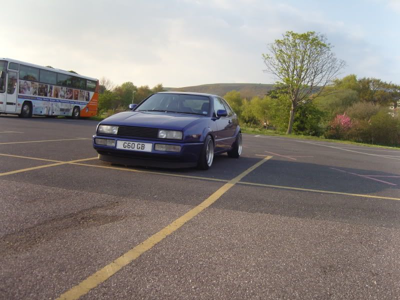

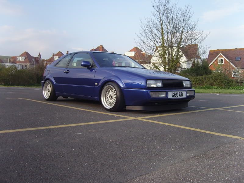

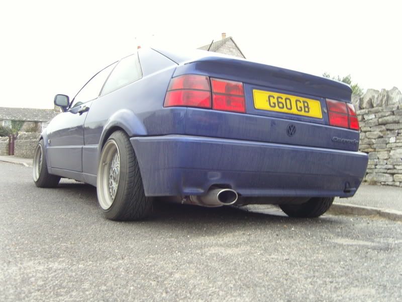

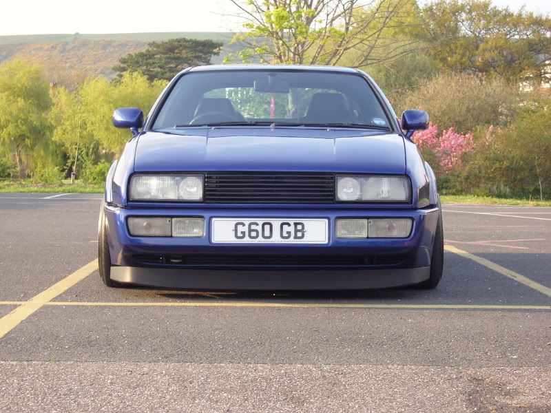

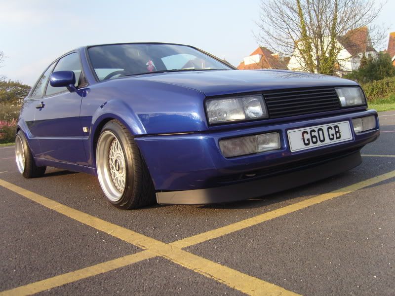

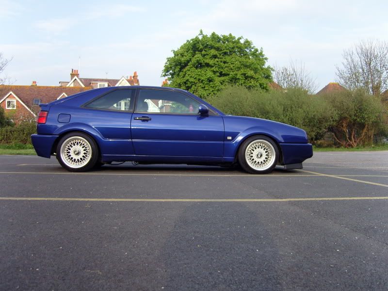

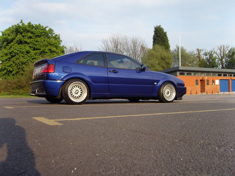

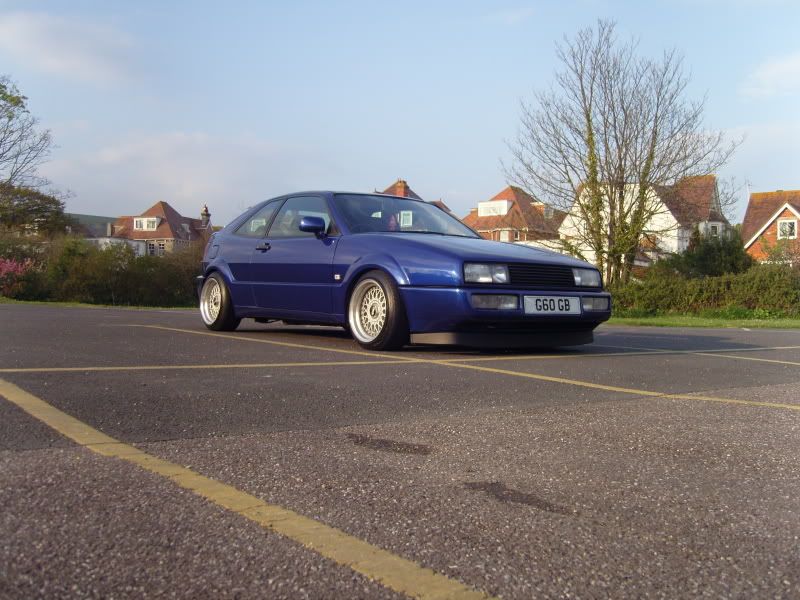

foster 0 Posted April 26, 2009 Actually got round to polishing the car last weekend, also had a go at sorting the dishes on the wheels (never again). Engines still going strong, rear tyres are looking a little scrubbed, thinking of smoothing the front numberplate recess and rear vw & corrado badge. Oh and some standard all red rear lghts. Heres some pics. Quote Share this post Link to post Share on other sites

BigTartanJudge 0 Posted April 26, 2009 Very nice, reminds me a lot of mine (apart from mine's not a 20VT) as similar-ish colour. I have had the rear of mine deseamed, debadged and towing eye removed. Had the front number-plate recess replaced with CC-mesh to allow airflow through to large FMIC. Quote Share this post Link to post Share on other sites
foster 0 Posted April 26, 2009 Im a bit paranoid about getting the front bumper recess done to be honest, as if its done badly it looks really awful. It needs to be perfectly flat. I have the intercooler mounted behind the grill in front of the rad. Been thinking about getting a US spec front bumper instead to save hassle but doubt I'll find one. Quote Share this post Link to post Share on other sites
