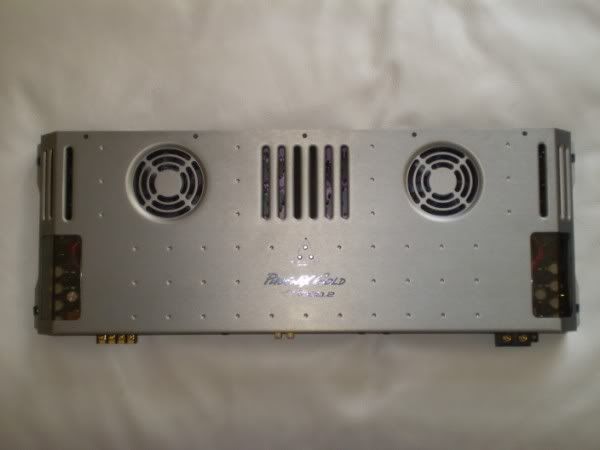

junkie 0 Posted February 18, 2008 Audiobahn are not the best as they are tuned for a certain frequency as well so will be astonishing at that frequency but not so good at the rest, which for listening purposes is not the best. If you want to run a true 1200watt RMS then you need to buy this bad boy off me but be warned it will fry your voice coils, only problem been is im not sure it will wire up right with your 2 4ohm voicecoils Another option but it means spending more would be to get a JL Audio slash series monoblock, or similar that automatically sensors the ohm loading and will play 500watt rms regardless of ohm loading. Quote Share this post Link to post Share on other sites
