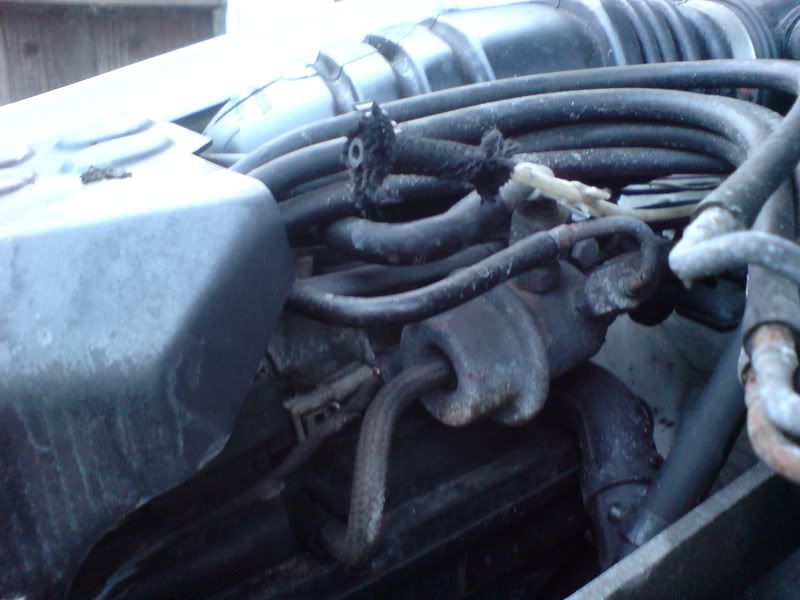

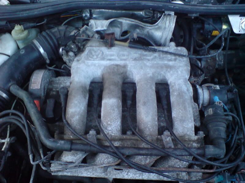

chrisr 0 Posted May 20, 2008 ive just got my first corrado & im having a couple of small problems with it, The main one is that when i try and start it up from cold it needs the accelerator pedal pressing quite far down, When it does start it seems to be miss firing & as soon as i let go of the throttle it will cut out, It will start up quickly again but still wont tick over, After a couple of mins with the revs being held at about 1500 rpm it will idle but it sits at just over 1000 rpm, Ive read that the ISV valve often fails could this be my problem? can any one show me on this pic where it is? Does anyone have any idea of what it could be?? Ive also found a pipe that seems to not be attatched to any thing just wondering where it should go? Sorry for the long winded post but im not too mechanically minded with these engines :( Quote Share this post Link to post Share on other sites
boost monkey 0 Posted May 20, 2008 Hi mate, welcome to the forum :clap: I've trialled and errored this engine a lot, my project thread was full of the same issues so hopefully I can be of some help. The red circled bit is the ISV. Yours doesn't look like mine though, mine is silver and yours is black and possibly plastic? :shrug: And yes, that vacuum pipe being disconnected will be the exact reason why your car dies when you take your foot off the pedal. It will plug into either a red or green plastic T-piece underneath the last bit of black tubing before the engine and throttle body. feel free to PM if you get stuck, or come for a chat on messenger :salute: Jon. Quote Share this post Link to post Share on other sites
mic_VR 3 Posted May 20, 2008 Not sure about the disconnected pipe other than I looks like a vacuum pipe.... not sure where it should be connected to. The ISV is the cylindical thing in front of the distributor (to the right of your inlet manifold in your pic) with the flexi hose attached to the inlet pipe on the left side of your pic. Best thing to do is take it off, soak it in petrol over night (can spray it with carb cleaner if you like but heard it can wreck the seals in it over time), clean it off and give it a coating of WD40 to help lube :camp: it up. Re-install. Hope this helps mate. Quote Share this post Link to post Share on other sites
Jim 2 Posted May 20, 2008 I hate to say it mate but it looks like you've got a few things in that engine bay to take care of! Firstly - regarding the ISV, they can be problematic on these cars now at this age. Though looking at the picture, i'd be more suspect of the wiring to the ISV than the ISV itself - is that blue electrical tape wrapped round the wiring? See my pic for the location of the ISV - try disconnecting it once the engine is running and see if it affects it. Regarding the second pic - I must be honest and say its a bit of a minefield of pipework round by the airbox.. a break in some of those pipes can cause really poor running like what you describe, and I would not be surprised if that rogue bit of pipework is causing your problem. I can't get to the car now but if you're still struggling in a few days i'll try and pop my head under the bonnet of mine for a picture or two and a nose around and see how it should be connected up - got a 2.0 16v as well so should be able to compare engine bays to see what is connected up wrong! Quote Share this post Link to post Share on other sites

chrisr 0 Posted May 20, 2008 thanks for the quick response its a 2.0 16valve engine & my isv is plastic, think ill be looking through ebay for a new one, do i need one from a corrado or will a golf 16 valve one fit? Yeah it does have blue electrical tape on the wiring (nothing to do with me though!!!!!!!) might just unwrap it & see whats underneath it all, Quote Share this post Link to post Share on other sites

dr_mat 0 Posted May 22, 2008 What the hell happened to the heat shield behind the engine block?! It looks like the local Uri Geller convention visited town. Quote Share this post Link to post Share on other sites
