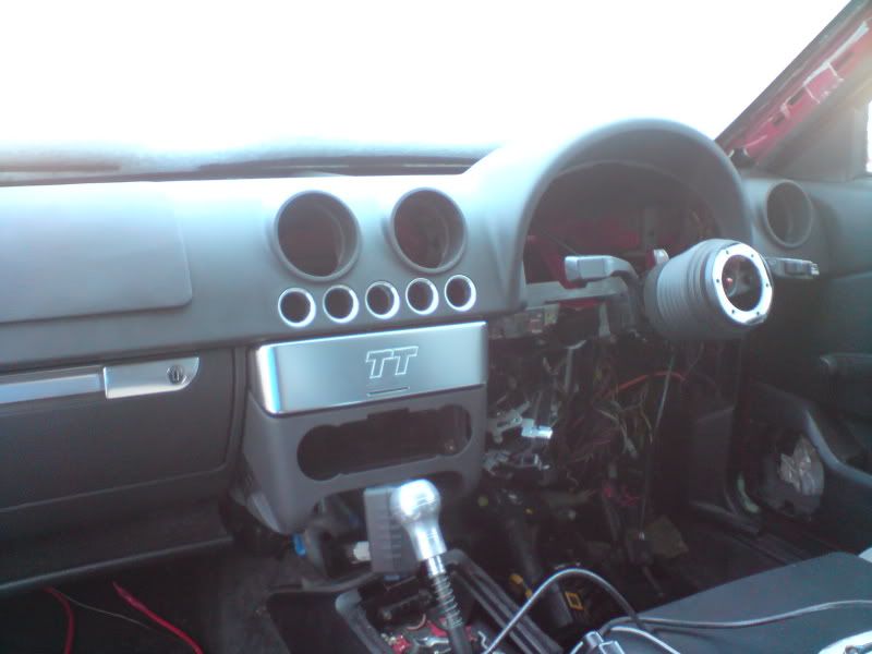

right ive managed to source a glove box, radio /heater cage and under steering wheel cowling for the dash.no pics as yet. I did a test fit of the top half in my other rado.

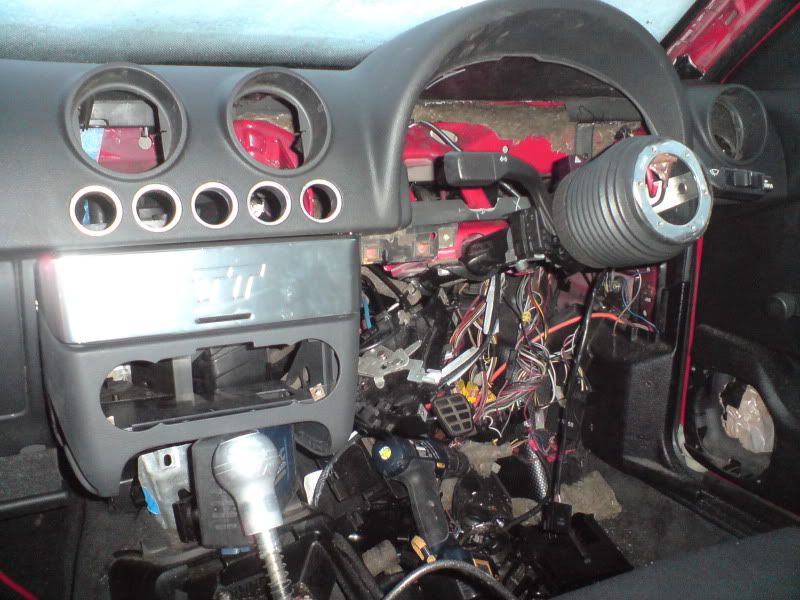

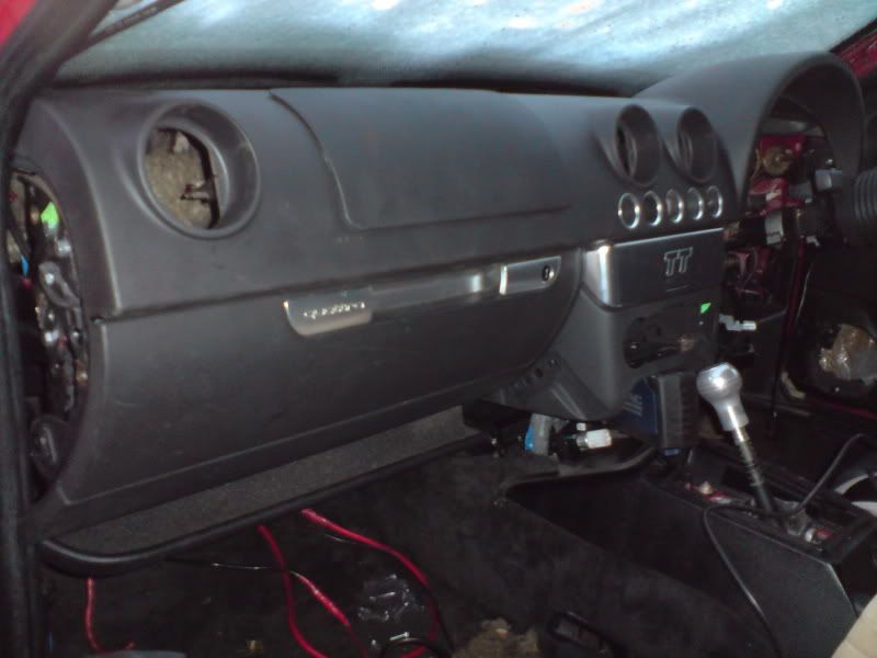

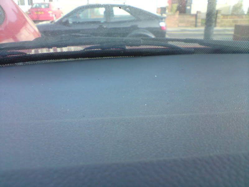

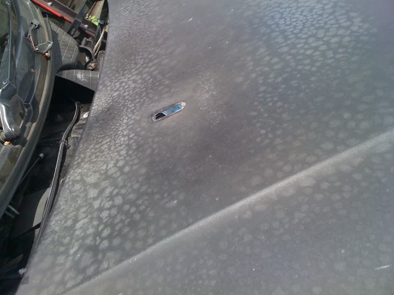

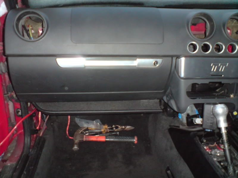

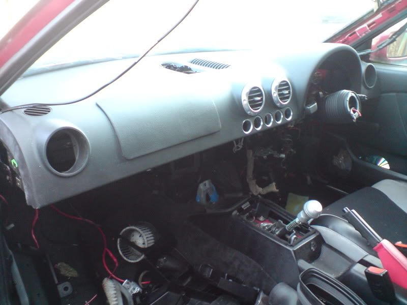

heres how the dash sat without any chopping - looks good however it sits too far forward and fouls up against the indicator stalks, was pretty suprised that curve around the windscreen part is of the dash is almost identical to the corrado
close up of where it hits the indicator stalks
crap pic of the fit up by the windscreen
another random shot

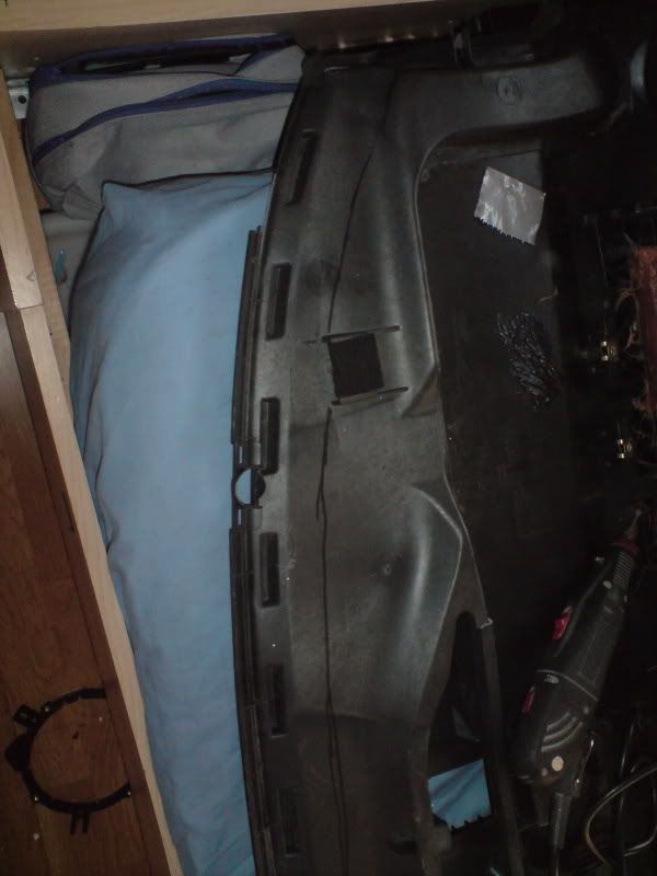

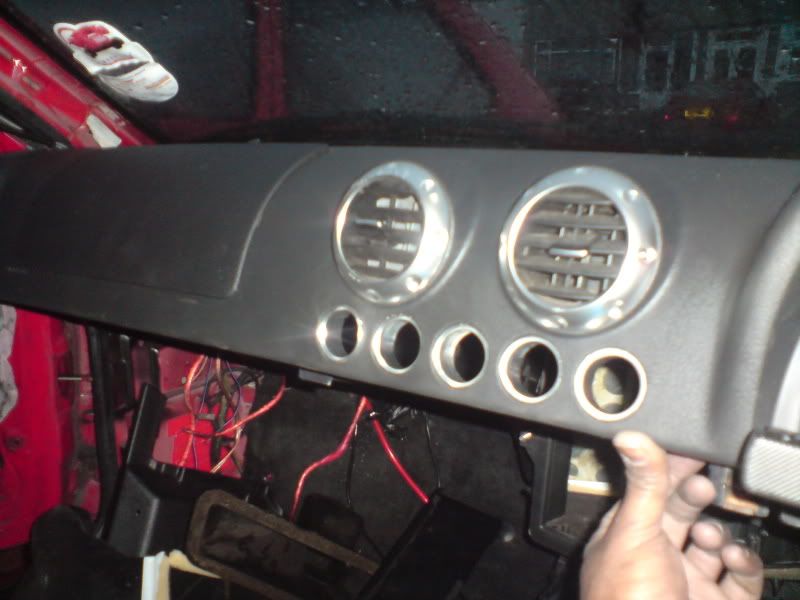

heres the underside. Ive cut back to the black line to allow the dash to sit further back ( didnt cut through the vinyl so i can fold it back round and glue it to keep a factory finish)

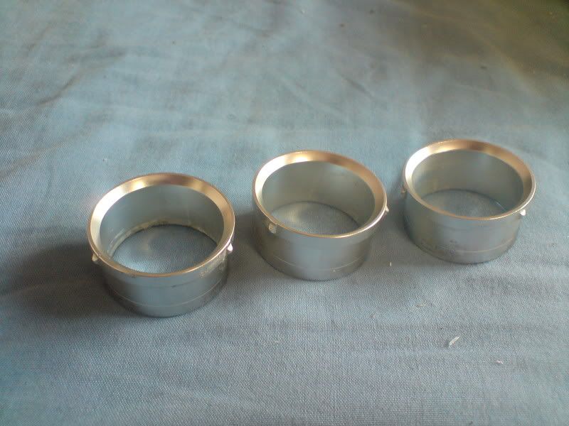

also got hold of a couple more vents as two were broken and wouldnt sit firmly in the dash. Also got three more rings to go in the switch holes as three were missing.

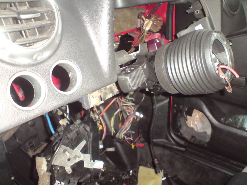

update on the dash, made two brackets for ach side that link up to the original corrado dash mounts. (they shall be tidied up once everything fits ok)
I have also made three brackets that go along the windscreen edge of the dash onto the bodywork to stop the dash flexing.
ended up cutting another inch off the back as it was still sitting to far forward - when the gear lever was in 1st your knuckles would hit the heater control panel.All sorted now

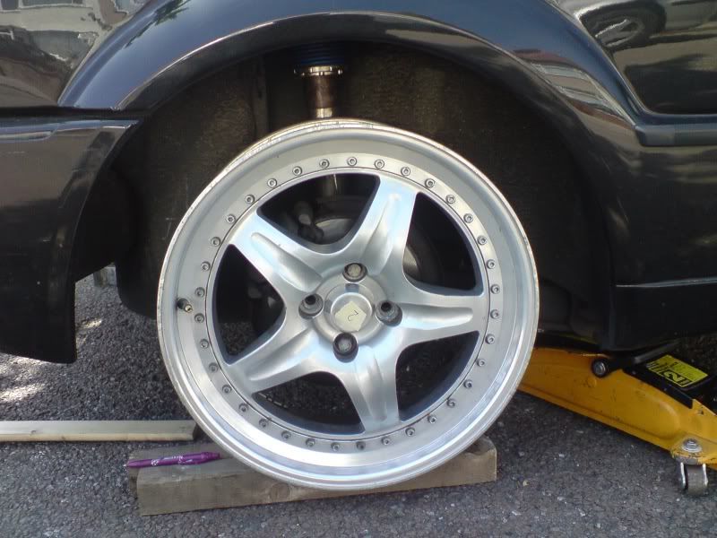

test fit on car

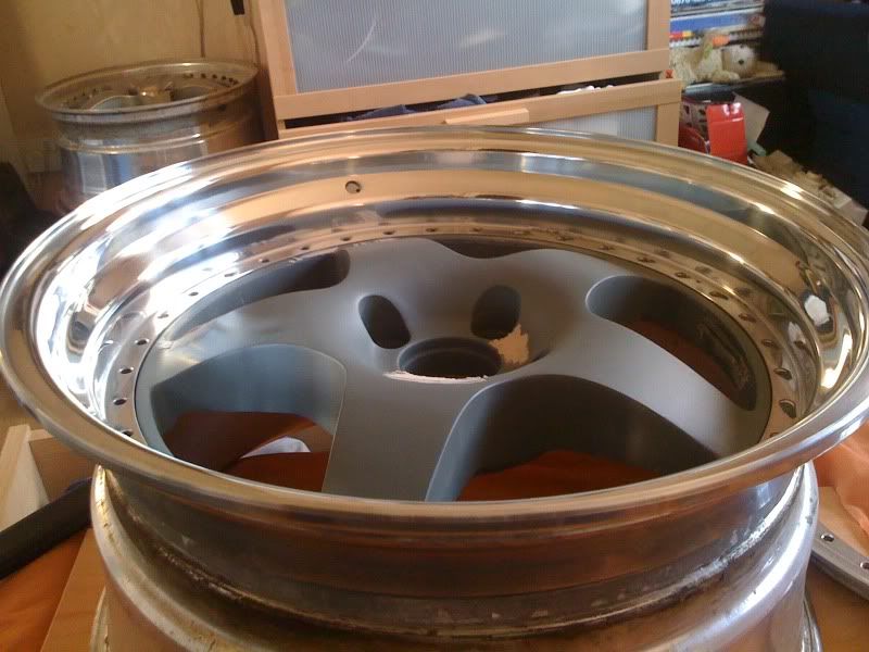

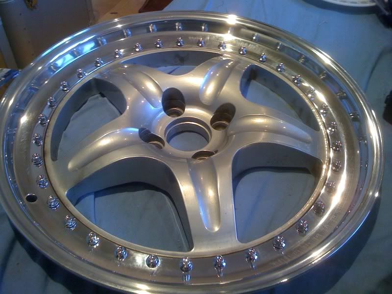

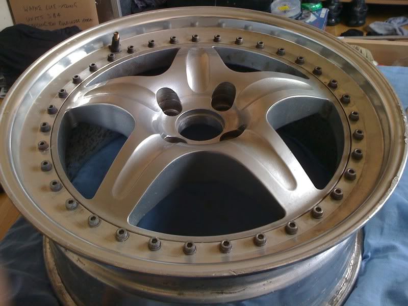

i started to split them down to repolish the dishes heres the result

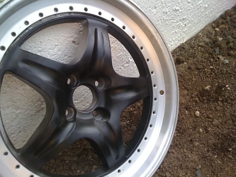

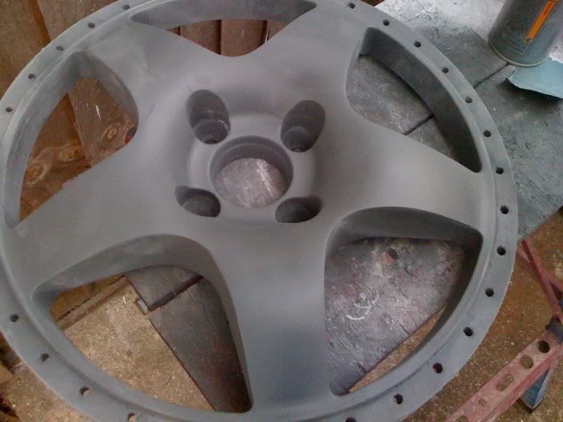

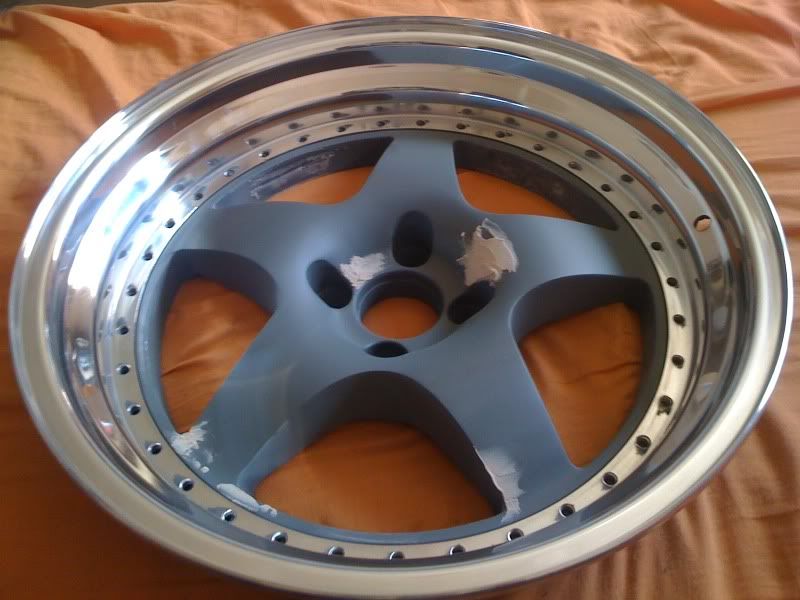

As i want to colour code the centres to the car i did a quick mock up with the wheels in matt black and something didnt seem right. The centres looked far to busy
so out came the metal filler and i proceeded to fill the recesses in the spokes heres the result
my 2.5 inch lips arrived today ( measure 3 inch but to the tyre seat its 2.5)
mmmm yummy im starting to get excited again.

to be honest the dash got put back with all my other projects but as ive finally managed to wire up the clocks im back on it.As i litterally got the bare dash ive had to make up brackets to hold it up. the main bulk of it will be a tt dash but the centre console will be custom and a few other bits. But im looking forward to getting that in! Need to plumb in all the heater ducting and im pretty much there

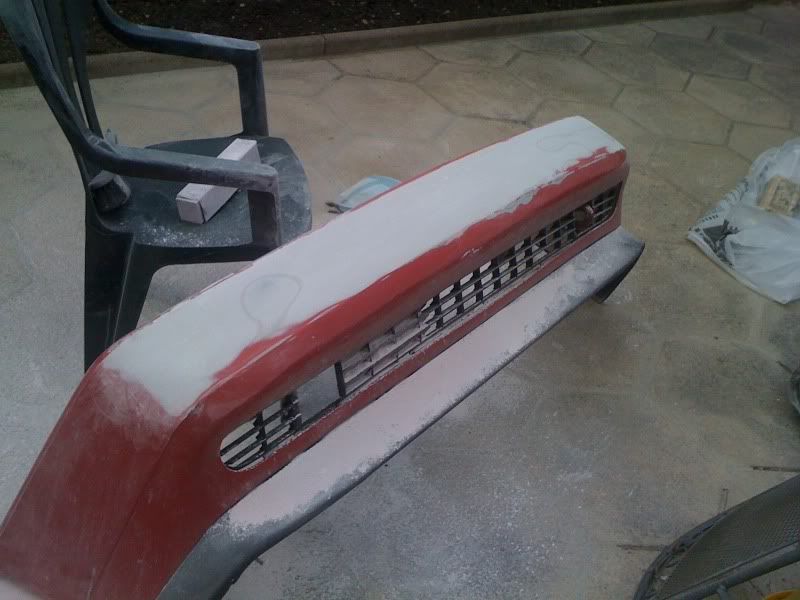

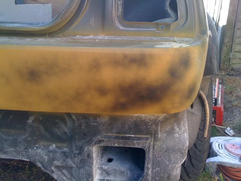

Now i had a lil bump in mr rado but all is good, its given me the motivation to get things done! first off smoothed front bumper.....

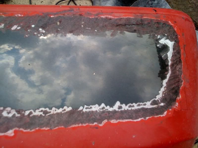

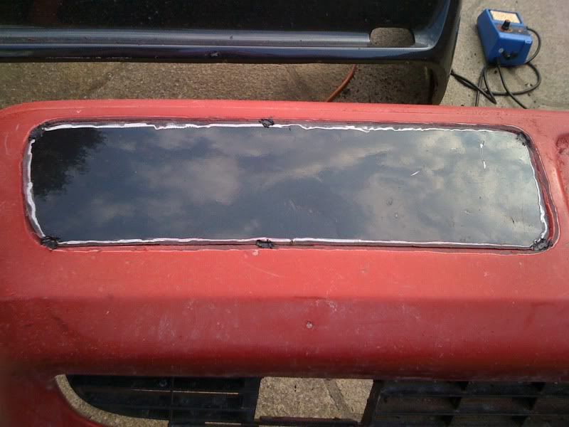

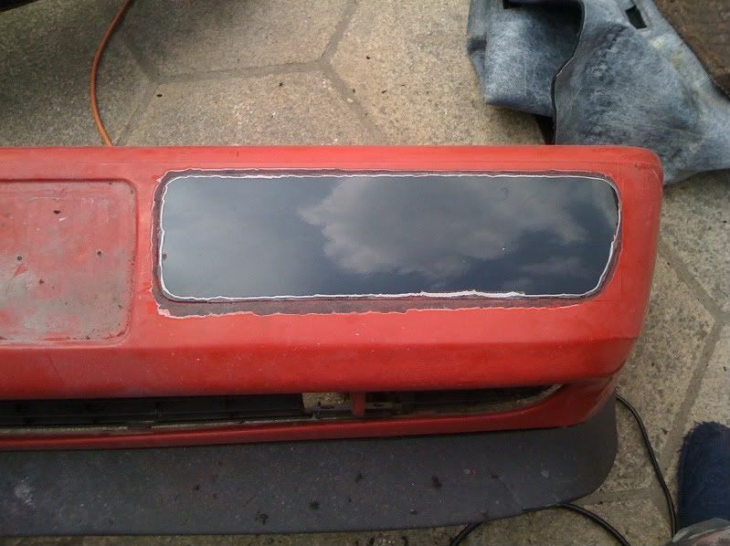

i had a spare rear bumper knocking about so i set about cutting out pieces to fill in the indicator, fogs and number plate recess.
sat in the recess

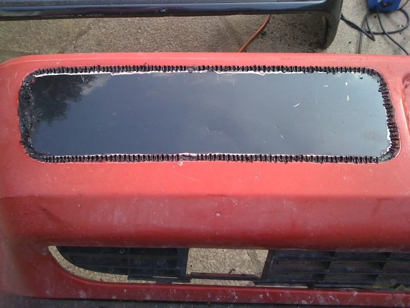

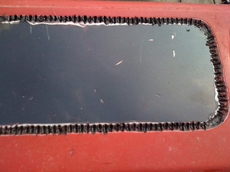

i used a soldering iron to tack it in place

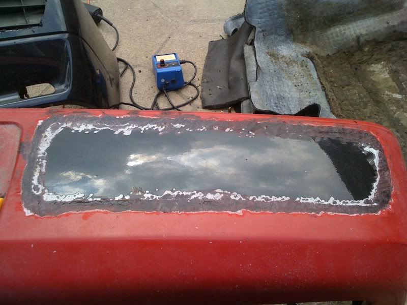

then went along the whole thing making small joins with the soldering iron ( its stronger than it looks!)

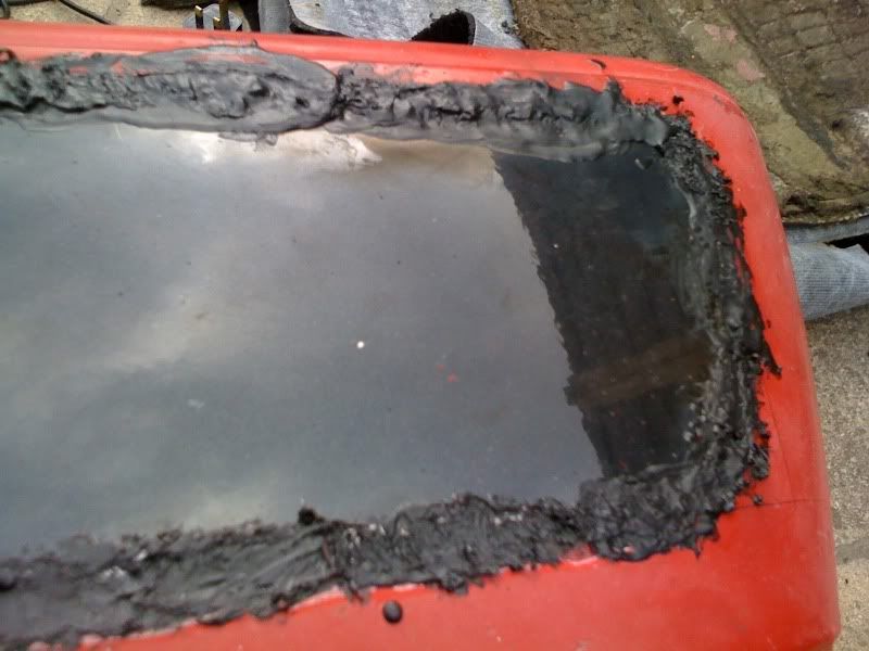

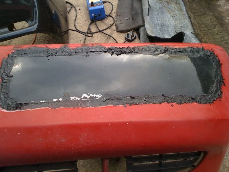

i then cut small rod shaped pieces from the donor bumper and used my gas iron to melt them into the cuts i previously made.
then flatted it down a bit
skimmed the lot with a thin layer of filler
more pics on that soon as its pretty much complete.

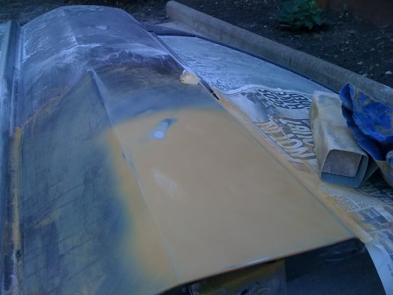

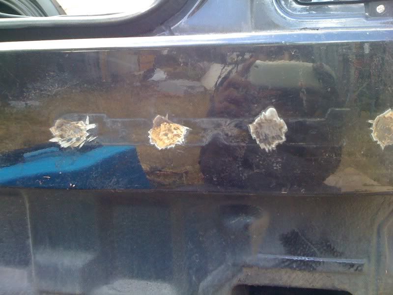

I thought why stop there. shaved door handles!

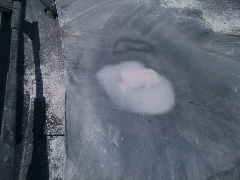

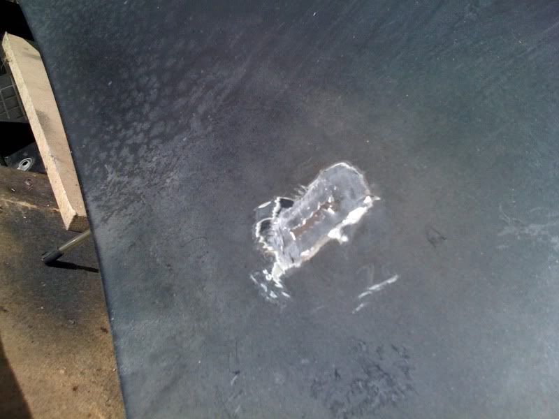

bonnet got the same treatment
small bits welded in
just waiting for that to harden before i prime it.

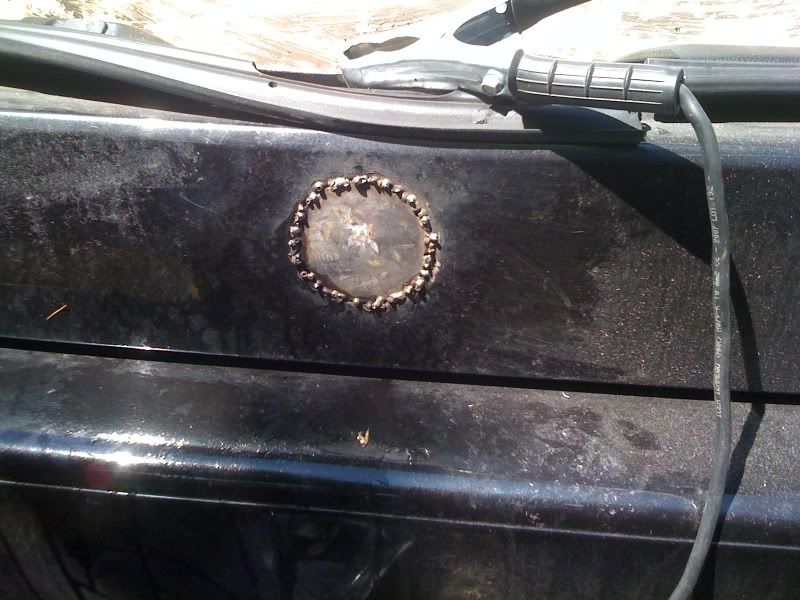

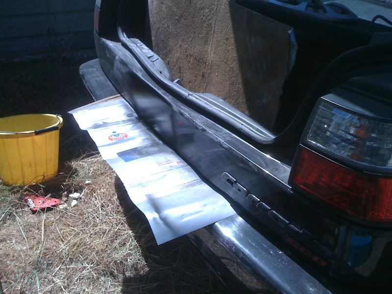

rear badge shaved

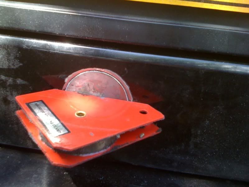

small disc made to weld in the recess
useful magnetic clamp to hold it in place
welded
ground smooth
filled and primed
sat in the recess
rear badge shaved

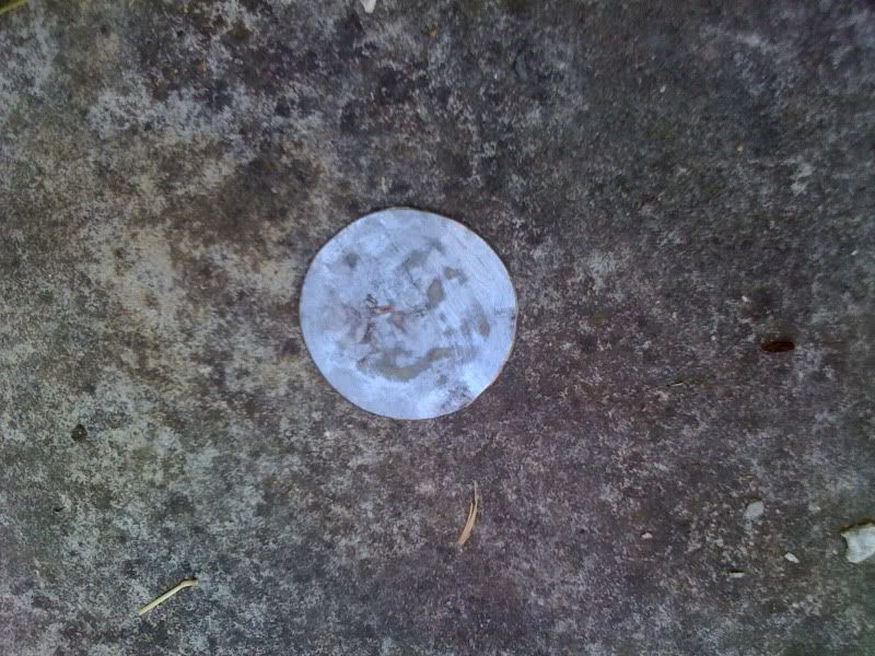

welded
ground smooth
filled and primed
so good you had to show it twice :grin:
great work ,,have you got a bit of that rear bumper spare you could send me to smooth the rear tow eye??
so your doing the whole bumper 8) lots more sanding than me, did you do it all by hand? I cant stand doing so I use powertools :grin:
whoops dunno how that double post happened! yea once ive finshed withthe bumper you can have whatever is left. Ill also be smoothing my tow eye and the seams just under the lights. Kempy all that sanding was done by hand with a block. Originally i wasnt going to go smooth but as the front end got mashed including my in pro headlights,fogs and indicators im not really up for spending out on more. Im also not keen on cleaning around silly things like washer jets and side repeaters so they had to go lol

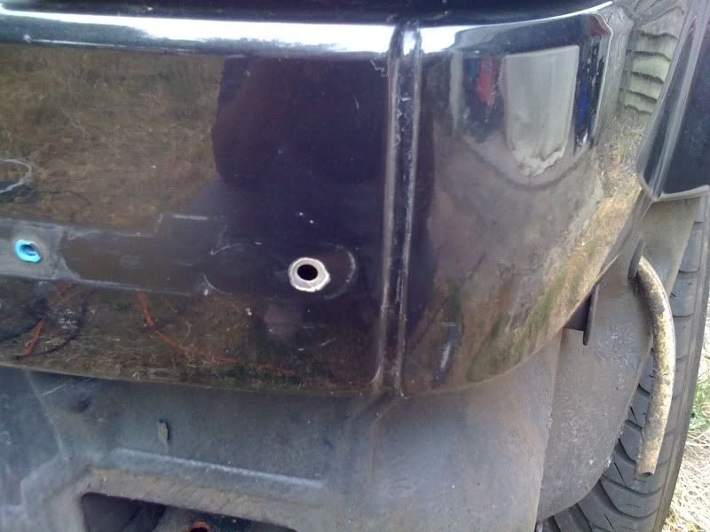

more bits done.

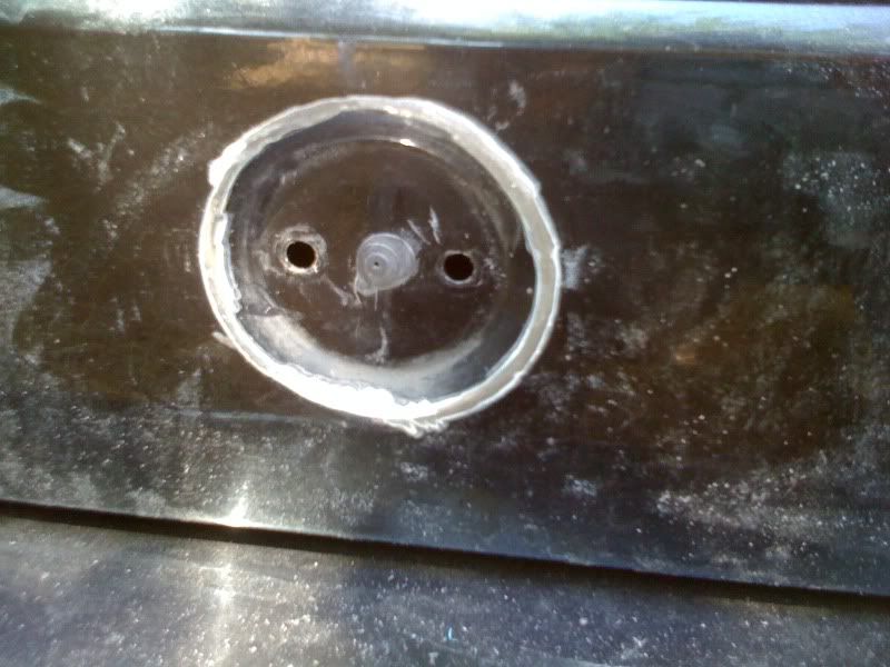

corrado badge removed - more bloody holes (why couldnt they just stick them on)
used my dremel to remove the paint from the edges
welded up the holes
filled and primed , with a guide coat on top
flattened again and painted matt black (filler and primer is porous so i dont want to undo all my hardwork by letting moisture set in)
other side

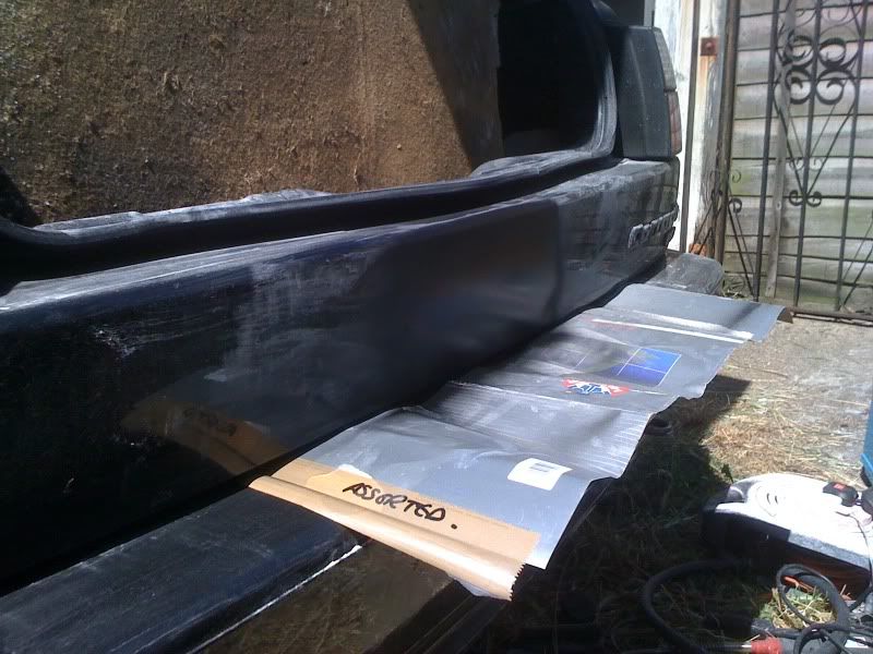

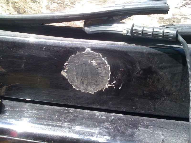

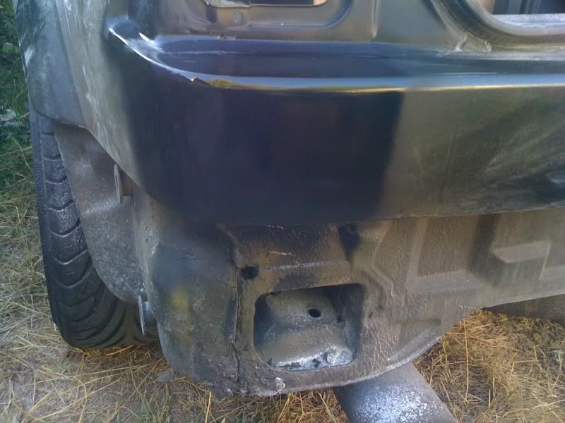

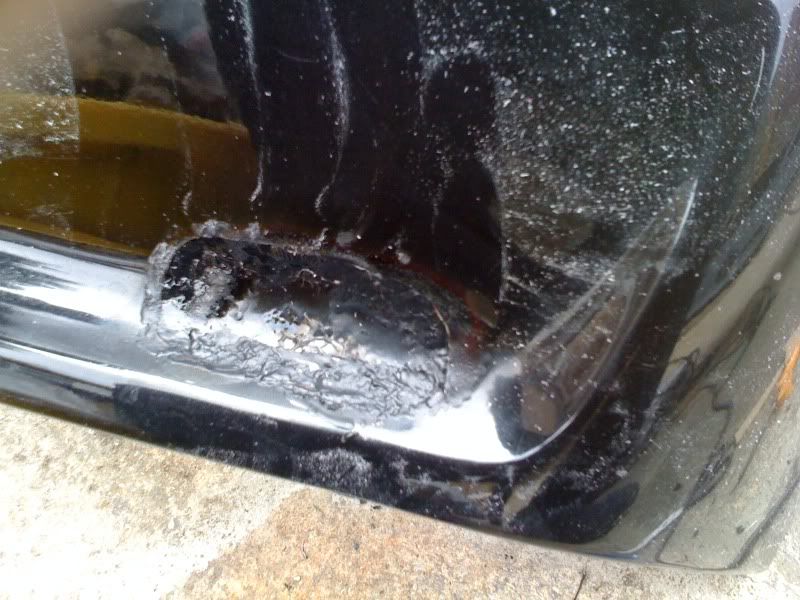

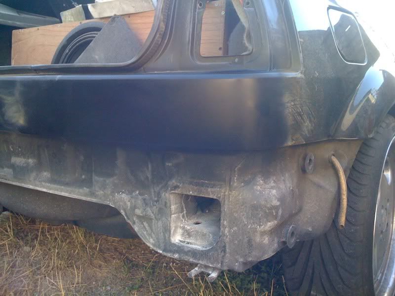

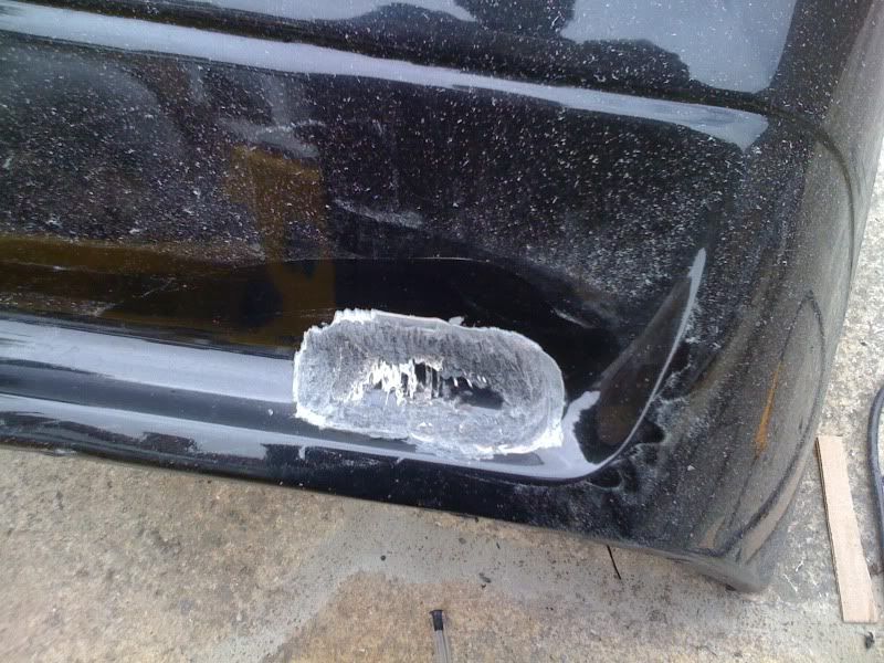

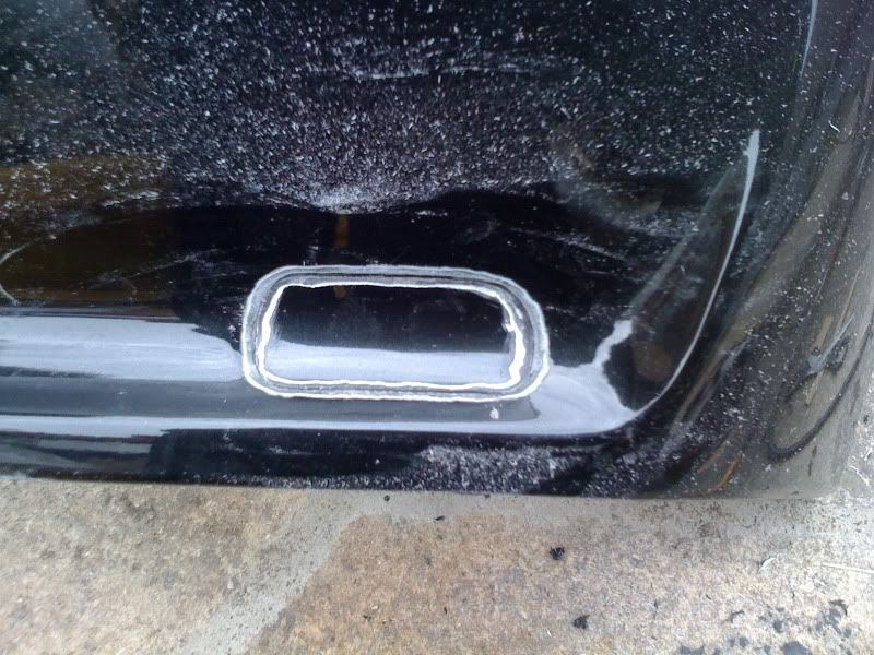

Also got to work on the bumper smoothing out the tow eye hole

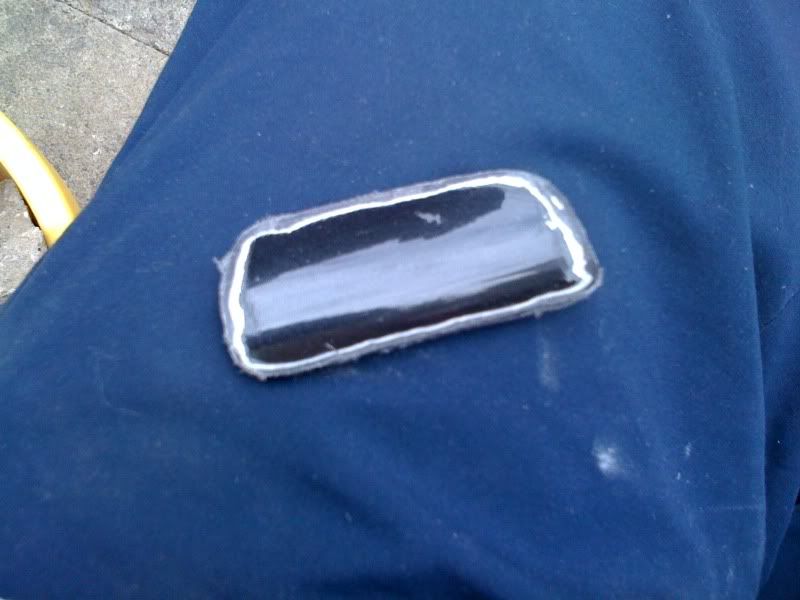

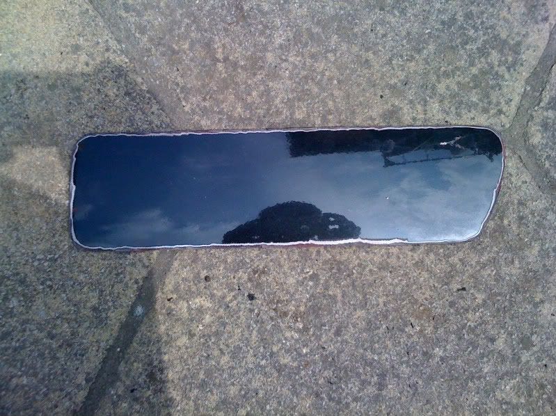

cut a little piece out of my donor bumper
sanded the edges of the hole in the bumper and sat the piece into it
plastic welded in
flattened down
its been filled now, just waiting for that to dry
