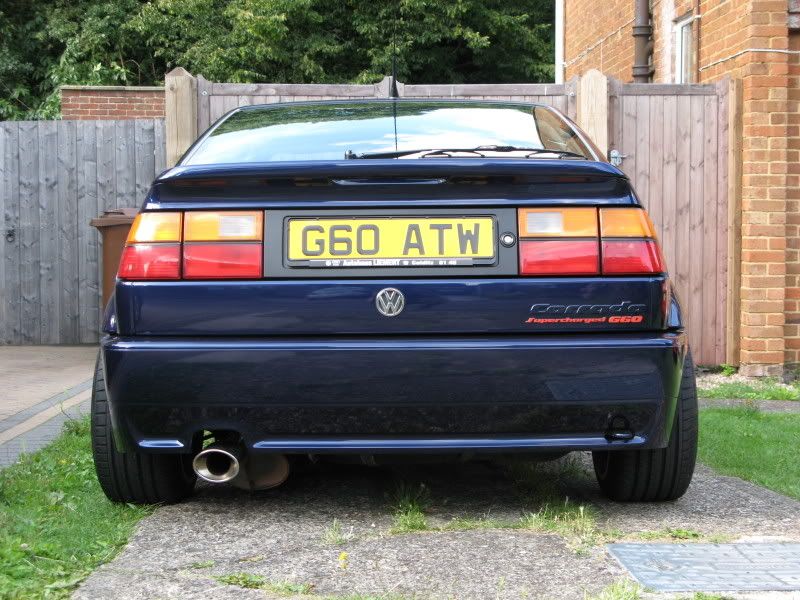

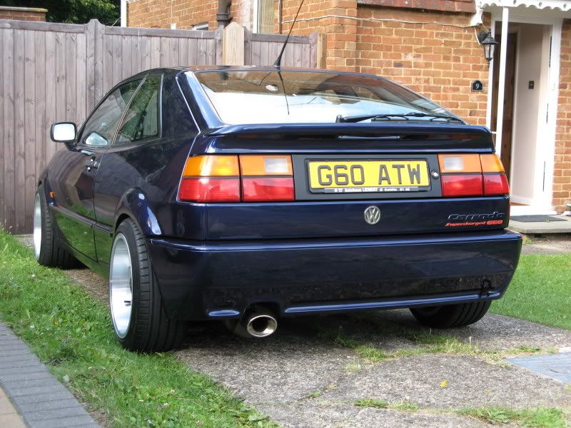

What tyres do you suggest and does anybody have any pictures from the back?
I have gone for 215 40 :D these are continental sport contact 2`s, differetn brands give different stretch on the side walls, some go for the 205 40, a lot more stretched but still looks good, due to the amount of dish and where the valve sits they are easy to have mounted on the rims too, you get a bit of tramlining and a bit of torque steer with 215 but they give a phenominal amount of grip due to the contact surface with the road :grin:
215 from the rear :wink:
