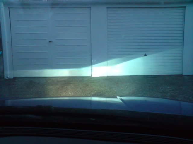

flusted 0 Posted September 12, 2008 I expect they are illegal on standard lenses but if you use projectors it should be fine. Heres mine as ive just found out my headlights are LHD argh Got mot on thurs aswell uh oh Quote Share this post Link to post Share on other sites

flusted 0 Posted September 12, 2008 mine are sonar, bit crap quality but bought them from a guy locally on the island. Anyone got any info on changing the sonars? Got the HIDs (sounds like a disease) from ebay about £50 all in but they are H1 only, got them from a uk supplier rather than hong kong Quote Share this post Link to post Share on other sites
Exup Man 0 Posted September 12, 2008 I've got the Sonar ones and to be honest not bad for just over £100 BUT they are not adjustable from LHD to RHD. I took the glass out, unscrewed the beam deflector and flipped it over. My car was MOT'd yesterday went straight through with just a pair of tyres. :D Quote Share this post Link to post Share on other sites
flusted 0 Posted September 12, 2008 Take glass out? plastic front is glued on? do i heat it up? help help help :lol: Quote Share this post Link to post Share on other sites

G60_Marc 0 Posted September 13, 2008 I've got the Sonar ones and to be honest not bad for just over £100 BUT they are not adjustable from LHD to RHD. I took the glass out, unscrewed the beam deflector and flipped it over. My car was MOT'd yesterday went straight through with just a pair of tyres. :D Interested in how this was done as i bought a pair of in-pro blacks on here from **** and when they arrived they were sonars :censored: Quote Share this post Link to post Share on other sites
flusted 0 Posted September 13, 2008 im guessing hair dryer to heat up the glue, but hopefully some1 will shed some light (excuse the pun) il have a go at mine next week Quote Share this post Link to post Share on other sites
flusted 0 Posted September 15, 2008 bump for advice? Quote Share this post Link to post Share on other sites
flusted 0 Posted September 15, 2008 Started tonight on 1 light. Hairdryer to warm up glue that holds lense on, then unclip the reflector from adjusters, unscrew the projector which was a PITA then swap the plate around inside Just gota suss how to glue the lense back on Quote Share this post Link to post Share on other sites
