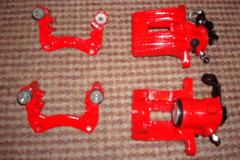

BigTartanJudge 0 Posted November 17, 2008 Well finally got round to painting the new rear calipers and carriers red, can recommend the Hammerite smooth paint, nice finish. Am just away to take all the rear brake parts out to the garage now, they are in process of fitting my front Brembo's as we speak :D Quote Share this post Link to post Share on other sites
