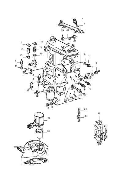

(12) 357919501A
temperature sender / for coolant temperature gauge
20MM 4 pin black/yellow / 2E
(12) 251919501D
2 pin green/black 20MM / PG
(12) 191919369A
thermal switch / for vehicles with air condit.
119C 20MM 2 pin greywhite / PG,2E, "J..":9A
(12) 357919369F
thermal switch / for vehicles with / electric fan / 3 stages
112C 20MM 2 pin black/green / 2E,ADY
13 025906041A
32 191919521D
thermal switch / for models with towing facility / and / for models with radiator fan run-on / F >> 50-N-035 000
100C M10X1 1 pin yellow / KR,9A
(32) 281919369
thermal switch / for models with towing facility / for models with radiator fan run-on / use if required: / F 50-P-000 001>>
105/100C M10X1 2 pin grey N 013 811 5 / KR,9A
(32) 535919521
thermal switch / for models with radiator fan run-on
90C M10X1 1 pin blue / PG,ADY
(32) 191919521D
100C M10X1 1 pin yellow / 2E
Hope this helps Chap...
cheers - i'm certain all the sensors now in the block work correctly, just the wiring for the isv that i need to check so centre console out, multi-meter at the ready!!
in that diagram above, the bits i took out were the equivalent of number 8. i checked this with 'rubjonny' on e38 and he has agreed! he knows a lot about this sort of stuff so decided to stick with him. besides, since the isv isn't working it explains a lot, so sort that first and go from there.
