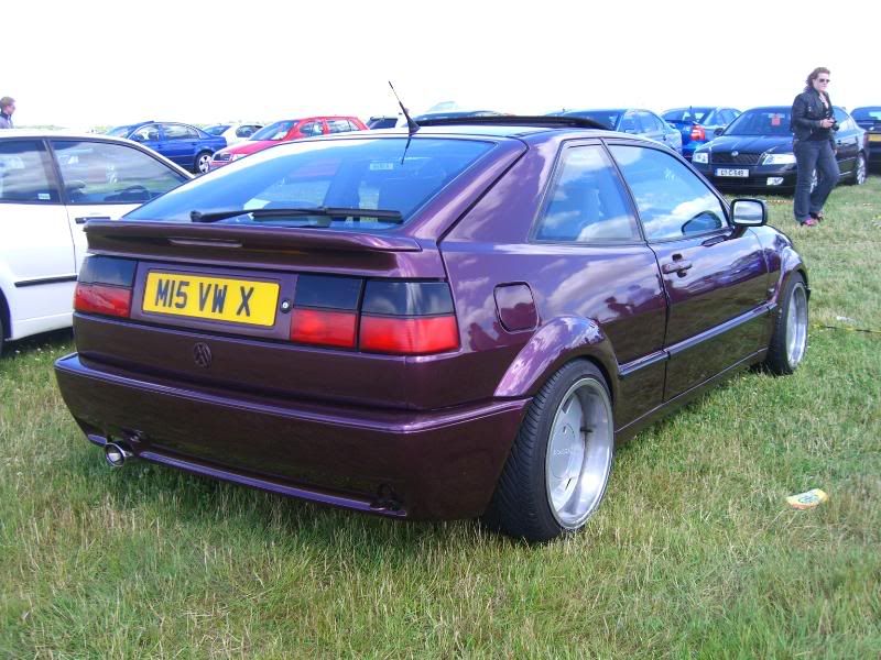

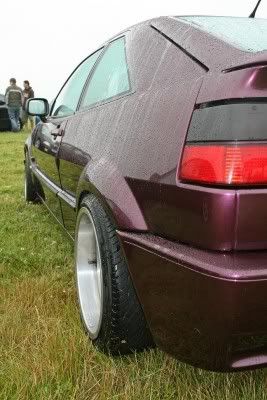

M15 VW 0 Posted November 14, 2008 I have 9s on the rear of my corrado. They did rub before i did any work. Just shaving the rear discs down by 3mm each helped loads. My corrado has a 105mm drop though so it depends what drop you want to run with too. I eventually had the rear arches pulled an inch each side. Quote Share this post Link to post Share on other sites

M15 VW 0 Posted November 14, 2008 the 9s are et15. I run avon zz3s in 205/40s-they are spot on! Toyo also do them in that size too, Neither are hugely expensive and both good tyres. :) Quote Share this post Link to post Share on other sites
