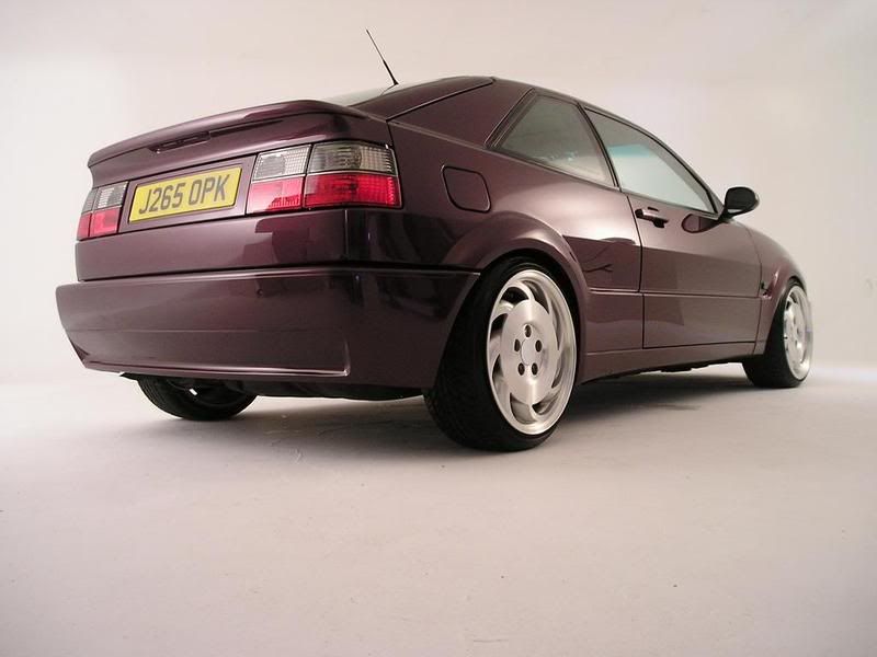

Vick N 0 Posted January 15, 2009 Not my pic, but my car :) Quote Share this post Link to post Share on other sites
Kempy 0 Posted January 16, 2009 very nice rear :grin: how does your bot lid work now? Quote Share this post Link to post Share on other sites
jamin 0 Posted January 16, 2009 Are those FK smoked rear lights? They actually look like they are properly aligned (some I've seen are awful), did you make any mods to get them to fit correctly? Quote Share this post Link to post Share on other sites
