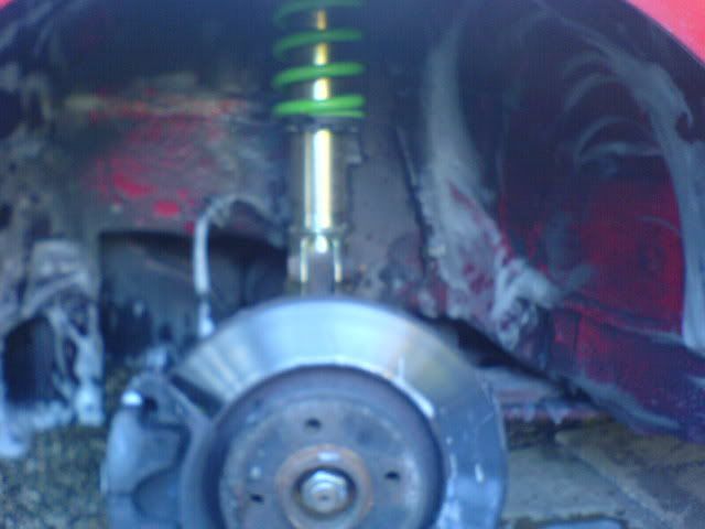

Jay2 0 Posted February 15, 2009 Planning on taking the wheels off the C and cleaning up the calipers and was thinking of doing inside the wheelarches at the same time. Is there a post about this somewhere? Tried the 'Search' without much luck. :confused4: Help appreciated on do's and dont's and what else can be done while the wheels are off. :scratch: Cheers. Quote Share this post Link to post Share on other sites
Supercharged 2 Posted February 15, 2009 Yeah good idea - especially after the weather we've had... I'd bag the brakes with a strong carrier and some gaffa tape then clean with hot soapy water first then use white spirit to remove old wax if you want to go back to paint... Quote Share this post Link to post Share on other sites
g60greeny 0 Posted February 15, 2009 good old washin up liquid an a sponge,worked for me,followed by a coat of wax :) Quote Share this post Link to post Share on other sites
Guest Posted February 15, 2009 Hi John, I'm sure Kip would be happy to pop down and chat through how far you want to go. He did a great job in overhauling the brakes on my Storm and replaced the splash plates etc. I did the mucky work of cleaning the arches etc... the filler cap side is amazing to do if you've never taken the rubber shroud off and got in amoungst the nooks and crannys up there that hold so much cr@p. As said, hot soapy water will get loads of muck off. It depends on how clean you want to go. If spotless get a nail brush and old toothbrushes (or buy new if you really want to pamper it!!!!) and some stronger cleaner (we use a motorcycle cleaning fluid from Hein Gerrick [sp?] and lots and lots of hand cleaner for later! I don't know the age of your C but the paint under the arches of the later ones is not on metalwork but a rubber underseal. When properly clean you can see if there is any damage to it which needs attention but otherwise it doesn't need any additional protective coating. Quote Share this post Link to post Share on other sites

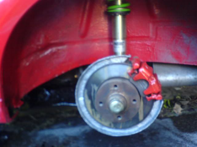

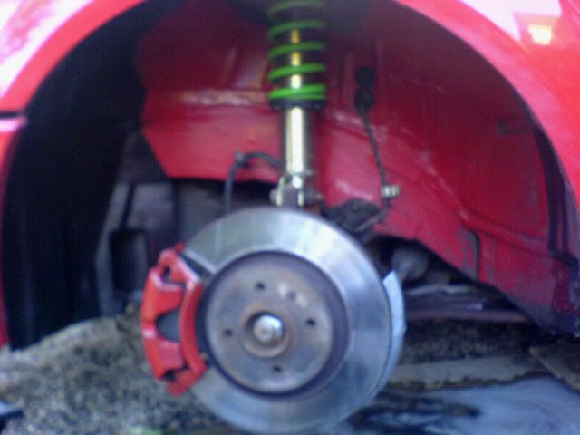

Guest Posted February 15, 2009 Butterfly - what make are those front discs? They look ace!! Standard VW disks but with a fair bit of prep before fitting. Masked up, masking tape cut to tidy, then a few coats of plasticoat primer and silver top coat to keep all 'not braking surfaces' from rusting over. Most disks come with a small amount of painting up but nowhere near everywhere or thick enough. Getting paint between the front disk vents is, I gather, a particularly tricky business. Now I have to be soooo careful when putting wheels back on, especially the rear, not to scratch the painted surface on the faces or someone will be very disappointed to have their work damaged! 2.8l 24v Climatronic system.pdfDSC03546.JPG[/attachment:2dmpqi7f]DSC00527.JPG[/attachment:2dmpqi7f] Greeny-Great job!! Bet that took ages to do! Again, as Greeny says. It is surprisingly easy to clean a lot of muck off. Plenty of water and an old sponge.... pay particular attention to the lip around the edge of the rear arches as they fill with dirt which will hold water then it's bye bye rear arch. John - sorry for hijacking your thread but it is on topic, though maybe not the detail you wanted!!! Quote Share this post Link to post Share on other sites

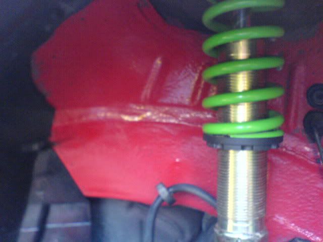

KIPVW 0 Posted February 18, 2009 Judith/Kip - What did you put on the wheelarches once you'd got them cleaned up? Butterfly says... Honestly ??..... Where the paint isn't so thick after years of wear & cleaning, I masked up the suspension, brakes, axle, exterior body then sprayed with touch up paint to get a good deep colour. And to really finish it off a few coats of laquer. Very very easy to keep clean then and looks great... but don't tell anyone else of my secret :ignore: 'cause most people will think I'm :cuckoo: Quote Share this post Link to post Share on other sites
