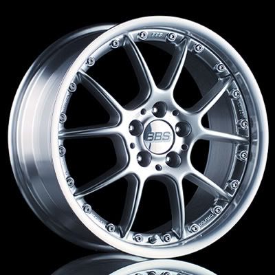

KADVR6 0 Posted February 22, 2009 i bough a set of these at the end of last year off coullstar but i wanna re-furb them and get them re-sprayed silver, does anyone know if i can split them with the tyre in place?? i cant see it being a problem?? just want to make sure before i start splitting them. heres a pic of the type of BBS i'm talking about cheers karl Quote Share this post Link to post Share on other sites
zak 0 Posted February 22, 2009 just let the air out of the tyre otherwise should be straight forward. Also the valve comes through one of the bolt holes so make sure you undo it as its a hard to get hold of. Quote Share this post Link to post Share on other sites
VR6 South 0 Posted February 22, 2009 No need to take the tyre off. It's best to pop the beads off if you are going to polish the rim as it will give you more room to work. Don't forget to loctite the bolts when you put them back together :) Quote Share this post Link to post Share on other sites

KADVR6 0 Posted February 22, 2009 cheers guys, i thought it would be ok but just wanted about 3 people to say yeh carry on :) and yeh Shaun they are the same as yours i just thought they were RX2's for some reason :cuckoo: i'm going to polish the outer lip, but what colour centre?? i'm swaying towards white?? opinions welcome. Quote Share this post Link to post Share on other sites
