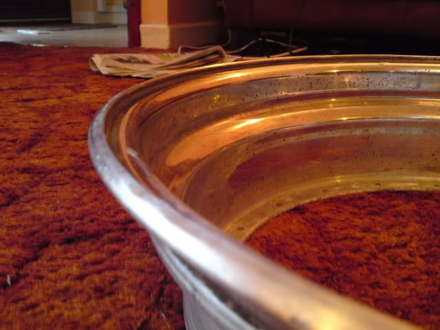

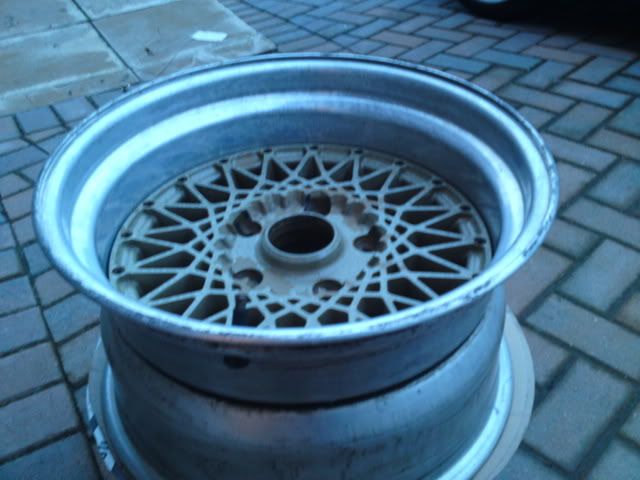

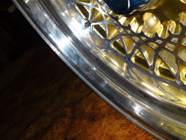

I bought these a couple of weeks ago as a project, thought they had potential. Ive been spending alot of time on them and are very close to being rebuilt, tired up and fitted.

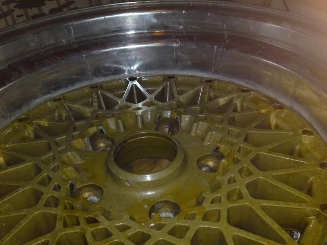

What they looked like when I bought them. Not too shabby but not great either

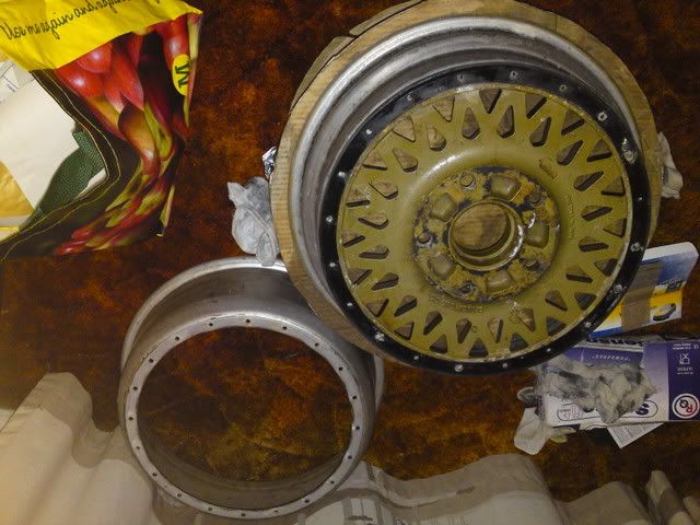

dismatling

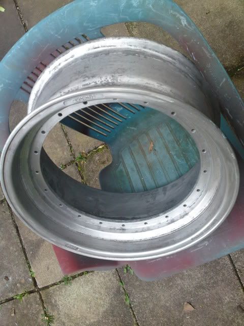

refirb
Fronts are 7x16 and are 2pc!?

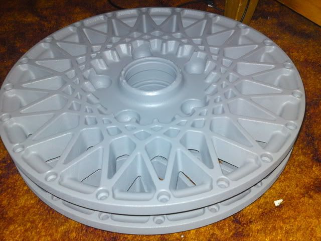

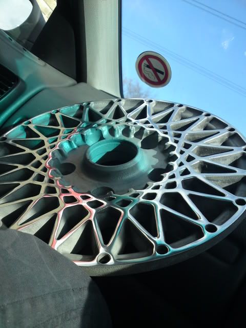

centres got shot blasted and primed

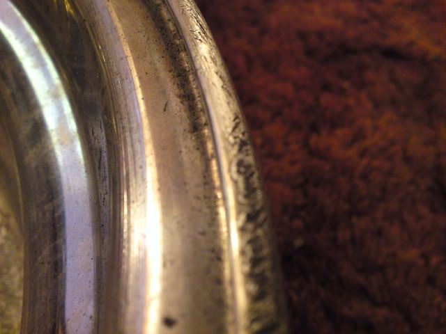

then polished

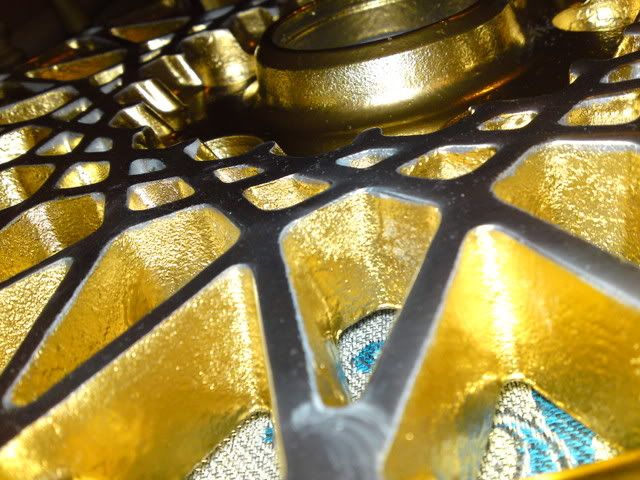

then painted

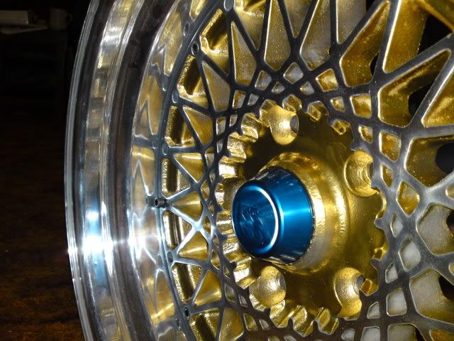

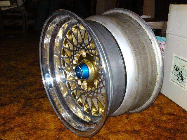

built

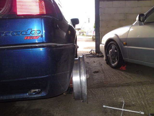

should be getting fitted soon. a few issues, ET-1 on the rears :wave: +25mm porka adapter massive poke :wave:
how did you paint the windows in gold and what paint did you use?
With those et's you need to find a way to mount the rear wheels straight to the car without adapters.
yea they are off wheel whores. they were basically a mile down the road so it was easy for the seller.
I masked the whole centre piece with tape then had to use a stanly knife to cut around the polished bits. took a while but it was worth it. The paint is plasti-cote metalic paint from B&Q seems to do the job.
As for the ET. I may have to redrill the hubs, may turn down my adapters. I'm gonna leave it to a mate of mine whose got a load of experience and says to me help sort it for me :clap: :clap:
